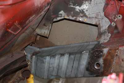

OK I took a step backward. I removed the dogleg panel that I already put in so I could better access the outside wheel well.
I am going to sandblast the inside of the areas I can get to but what should I spray/paint onto the bare metal before I weld it back up? I have some weld thru primer but something tlls me this is not the answer. Should I run out and try to find some ospho or something else?

QUOTE(obscurity @ May 29 2010, 09:36 AM) *
Gonna try POR15. Off to AA and Home Depot for some other supplies.
I'm not sure I'd try and weld through POR 15, but I am a big fan. For the places you can't get to after welding I'd use a weld through primer, weld up the steel, clean the outside VERY well and hit it with POR 15

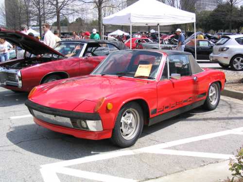

So here is a pic of the car a few years ago before I got the bright idea to fix the rust. The pic is from the Georgia Tech Auto Show.

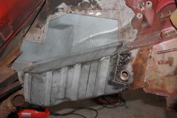

And this is how far I got today.
The plan is to sandblast a little more tomorrow, then clean up all the media and paint as much as I can with POR15 and while that drys I'll try to size the replacement panel.

QUOTE(obscurity @ May 29 2010, 06:04 PM) *
Don't!
I'm afraid, POR15 does not work as advertised ... (IMG:style_emoticons/default/dry.gif)
I have had better luck with Metal Ready or Ospho and then a good primer over that once it's dry.
