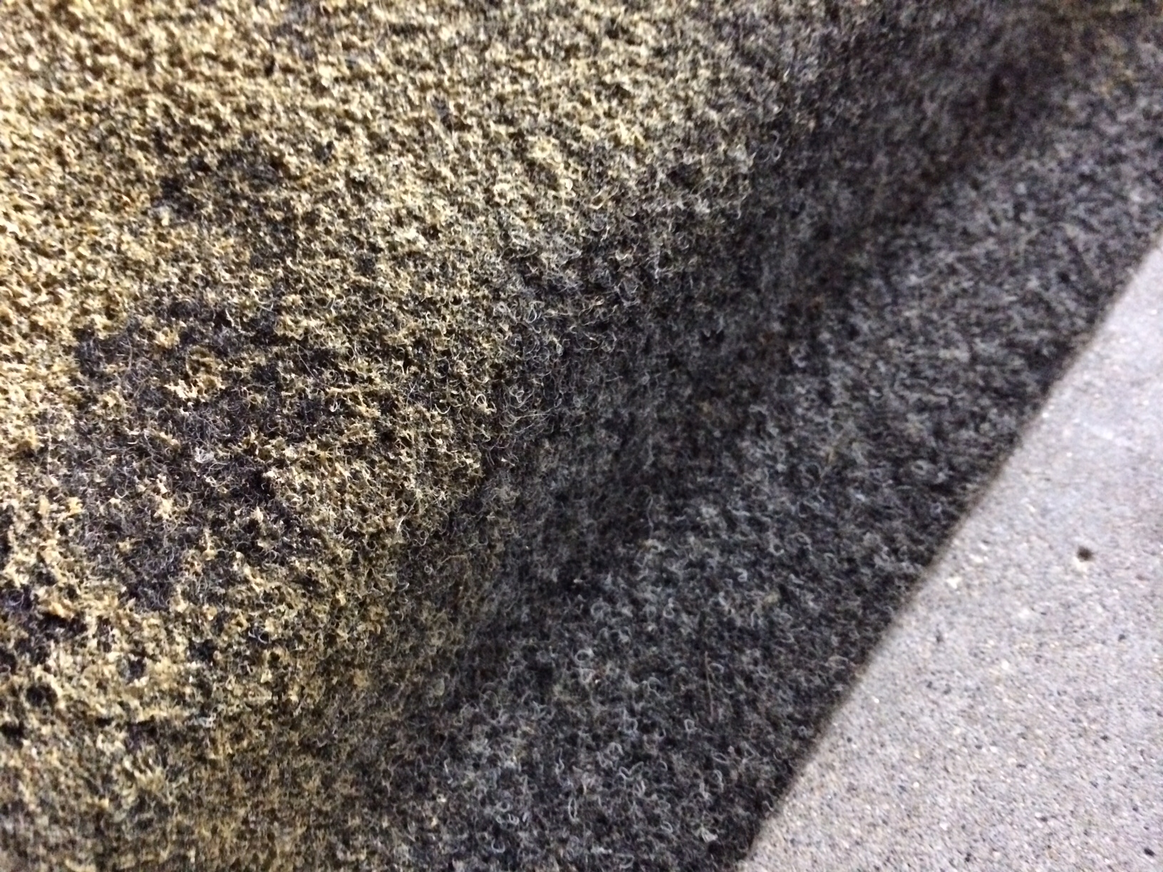

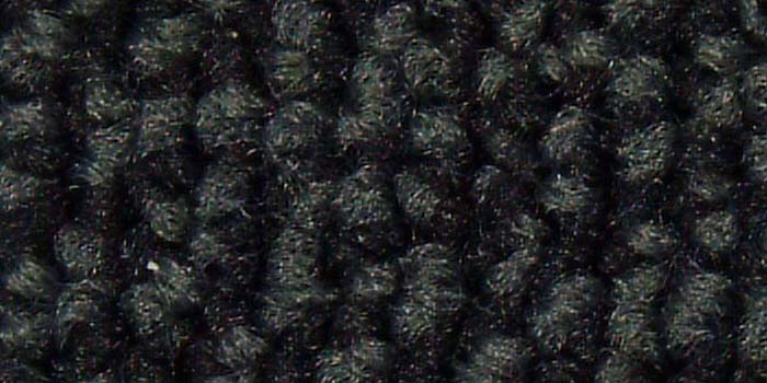

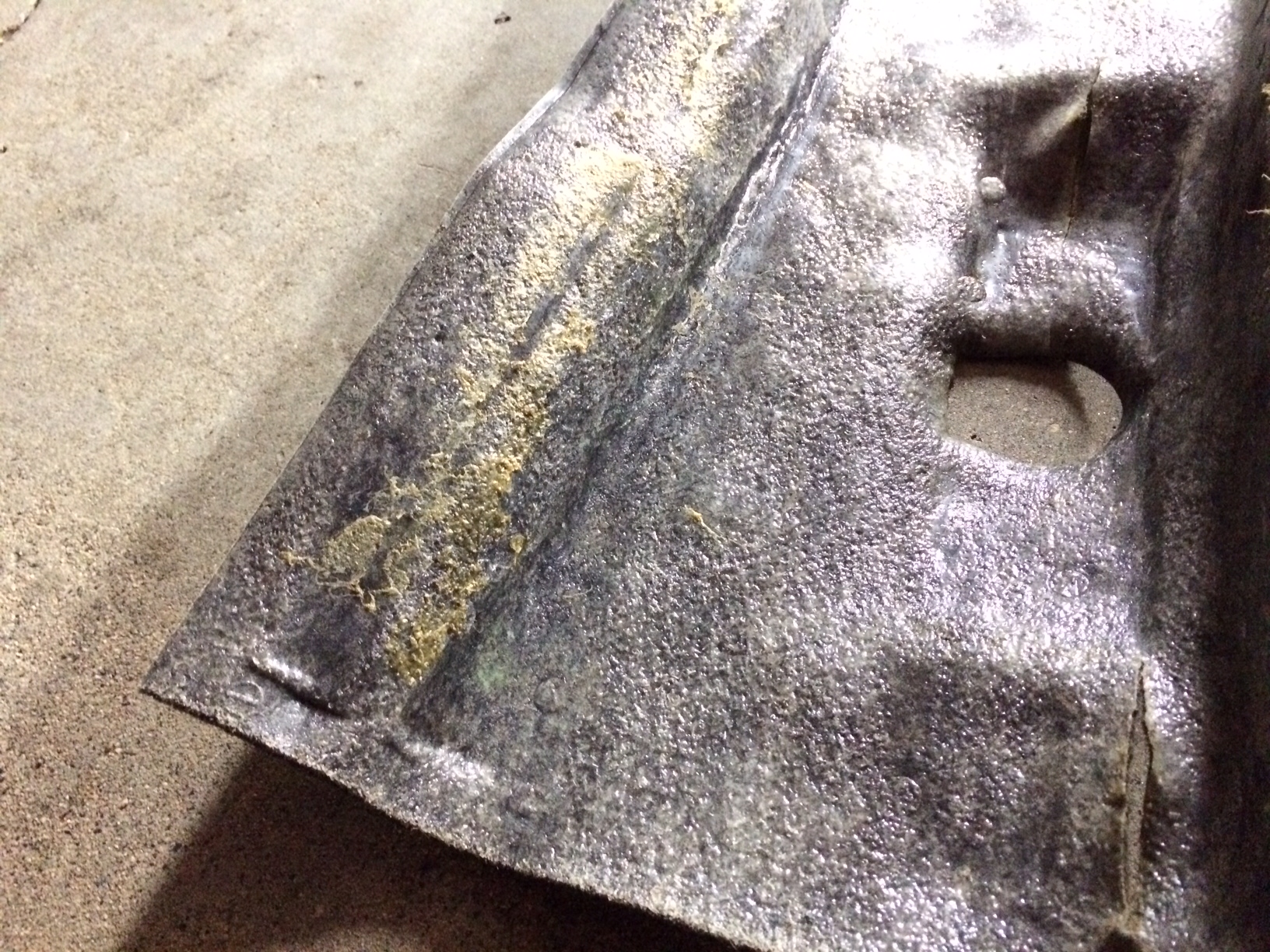

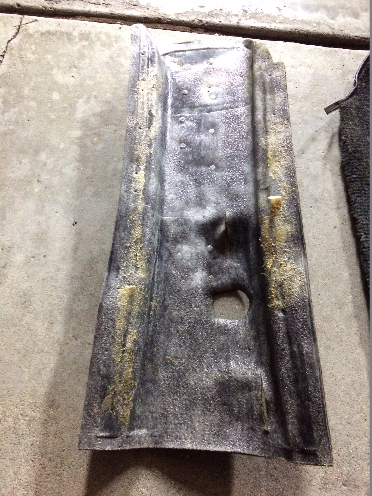

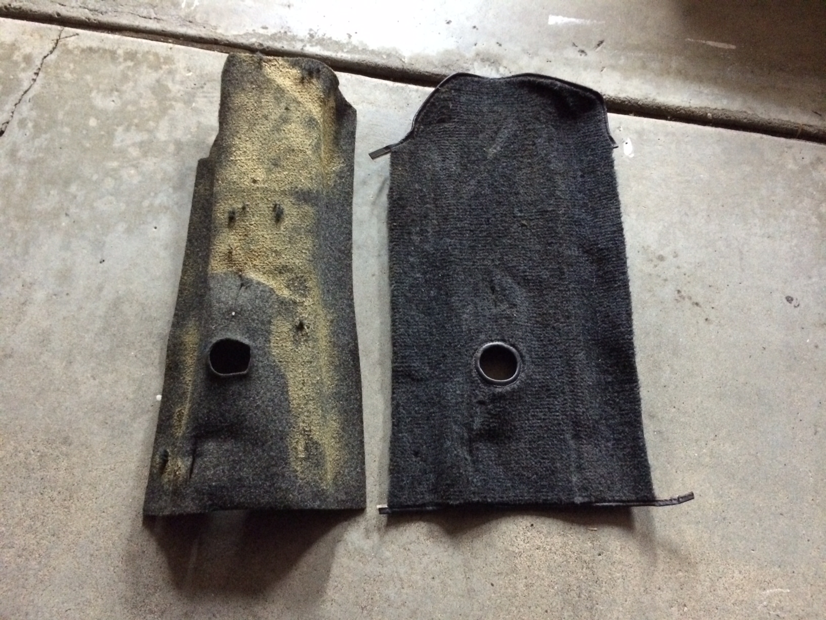

As I sort through my car, I discovered the previous owner installed new carpet on top of the original 914-6 carpet. The large floor pieces are missing though.
The "loop" carpet above does not look correct to me. There is no tight pattern in the original 914-6 carpet.
Also notice the 914-6 felt carpet material has some sort of backing is and pretty rigid and formed to the car.
Original -6 carpet on left, aftermarket on the right.
-Steve
post Dec 23 2013, 05:42 PM
Posts: 10,753
Yup- that is stock Six carpeting. I wish we had a supplier for our cars. Mine needs carpet too.

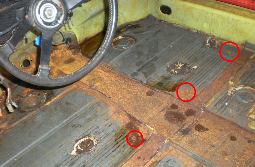

> welded in hold downs for the floor
I just noticed my [new to me] six doesn't have these hold downs. Every other 914 I've had had them. And the floors look original (tar on them/etc).
Did sixes not have those hold downs?

First photo I could find... (not my car). Hold downs circled... (those things you push the carpet rubber grommet over)
-Steve

> I have those little hold downs on my car
Right. I've had them on every car I've owned except for my original six.
