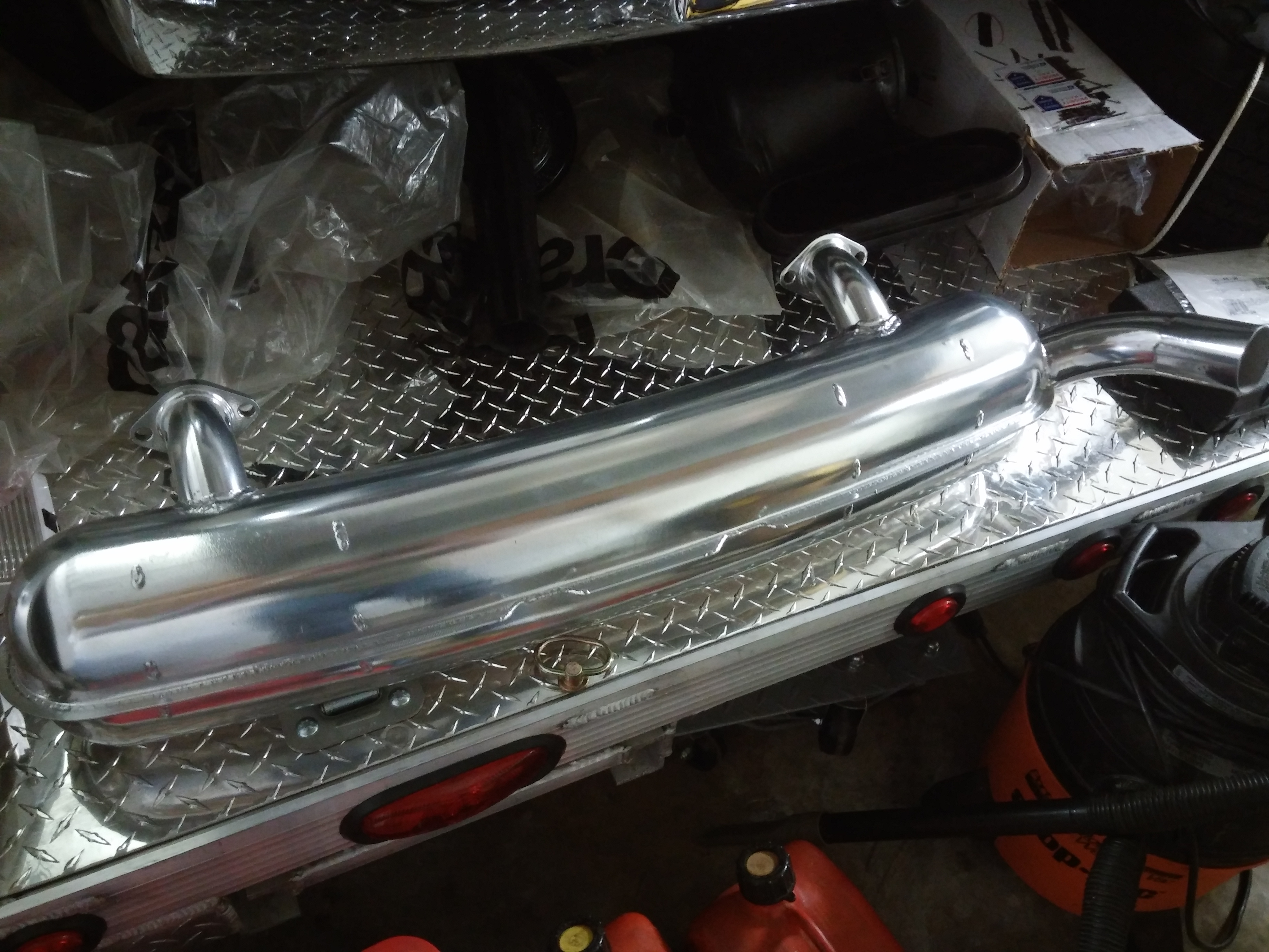

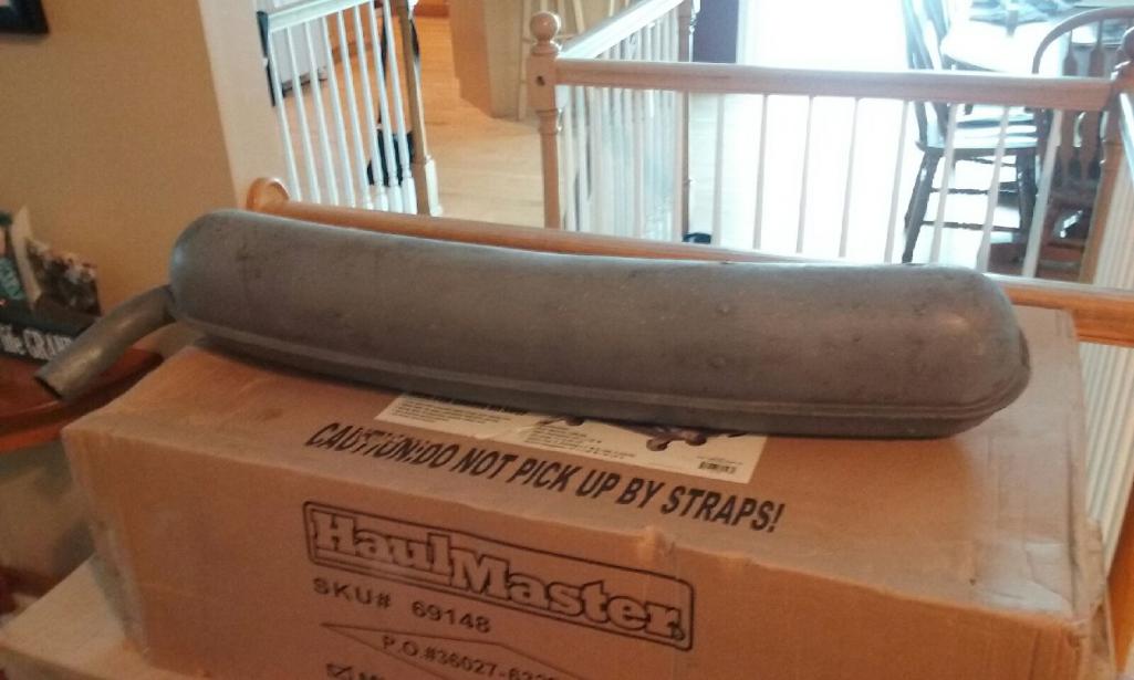

I recently purchased an original exhaust for my '74 2.0L that's in excellent condition. I was thinking of using the VHT SP104 high heat flat grey paint to finish it off....any advise on other paints that I should consider?
I'm also going to repaint the heater control flaps, boxes and pipes in satin black.....do those need high heat paint as well?

Very nice. I wouldn't paint it if I were you.

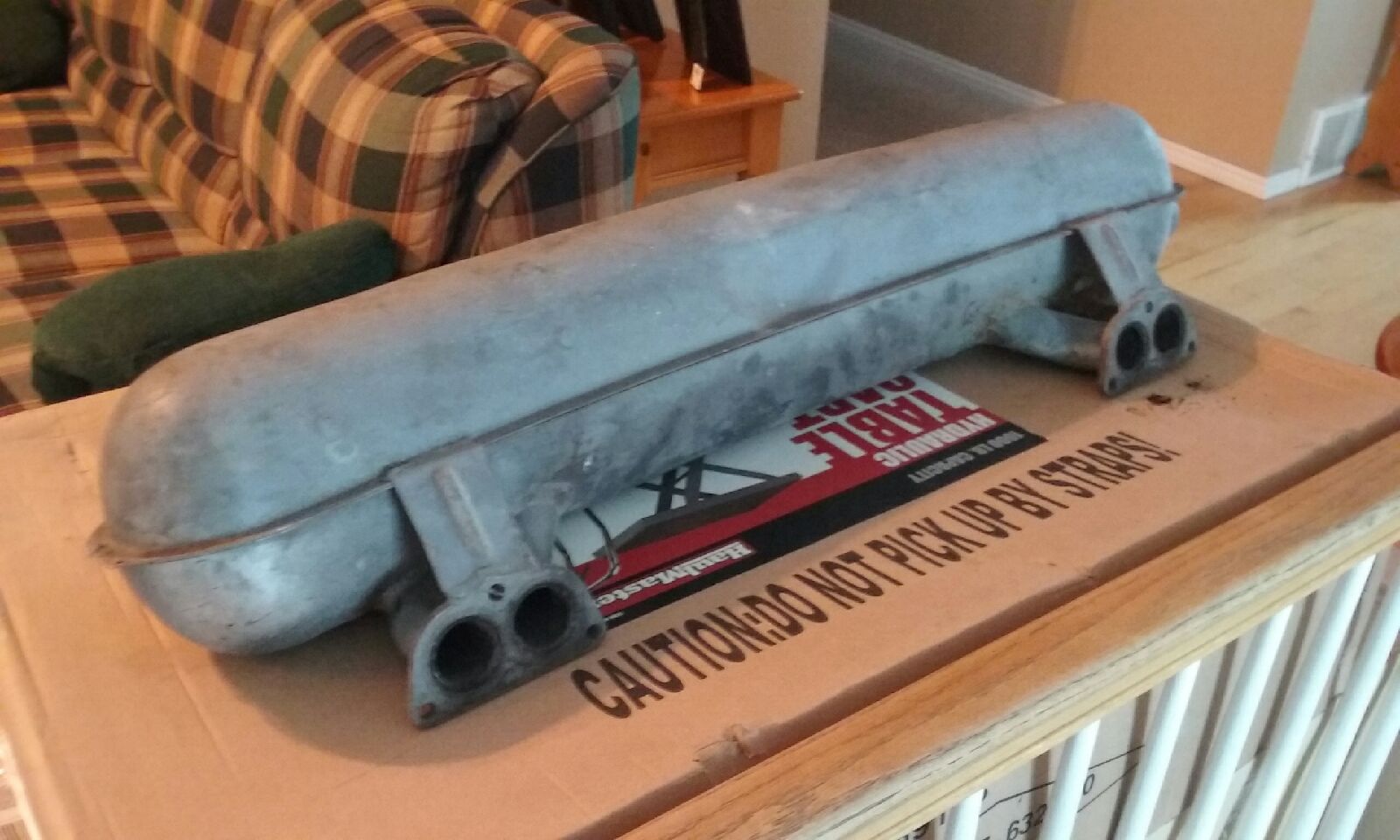

Congratz on the find Jeff! Is it the Leistritz or Bischoff?
Try emailing to Bev & Tom Gould at TC's Garage & ask them to check if they've been able to find the "Porsche Exhaust Gray" which Wurth used to sell, since they're Wurth dealers, Tom is an ex-914er, & they're both some of our most experienced Concours judges in Zone 8.

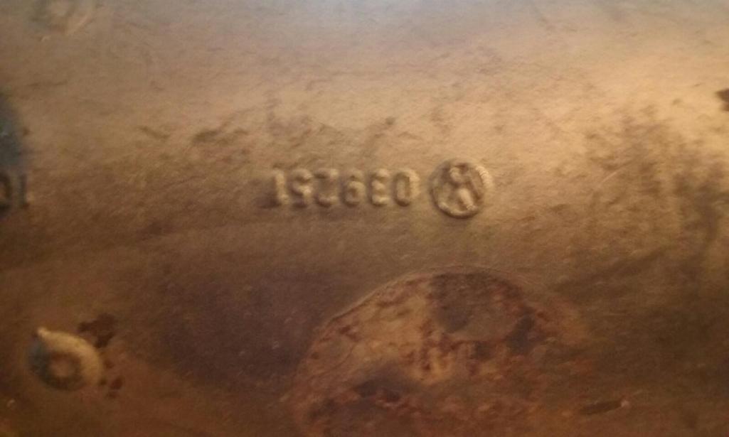

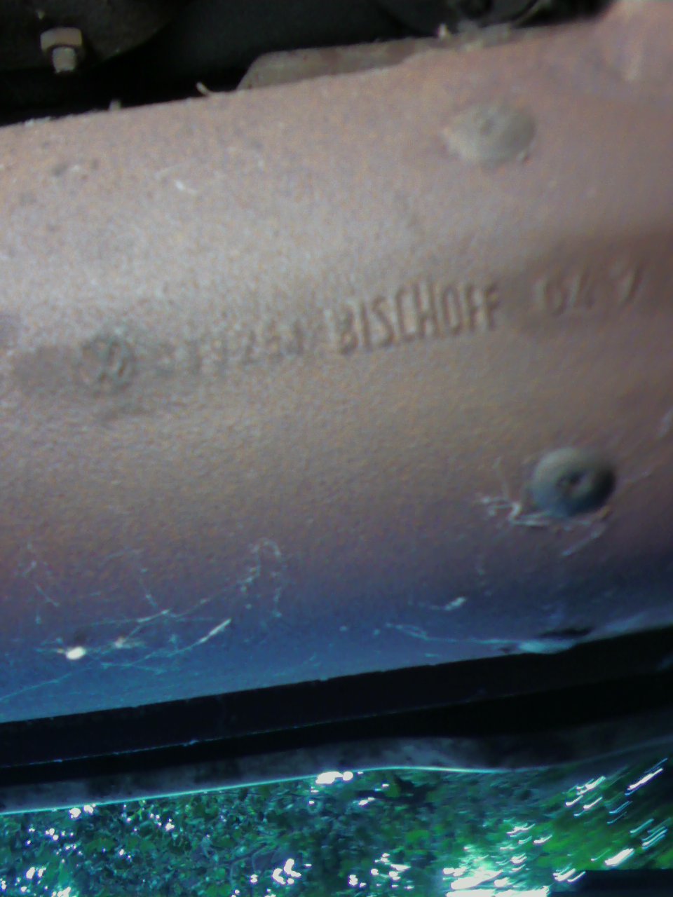

FYI - per my PM, here's a close-up pic of where the Bischoff name is on my older but low mile OEM 2.0 Banana muffler from 1980-ish - between the rivets on the inside facing forward when installed, & between the L & R exhaust inlets. I'd assume that the Bishoff, Leistritz or other mfgr name on your new/NOS one is in a similar location, or they may just use a simple logo by the 2010-11 date on yours.
BTW - the 04 7 on there is not the date for mine, since I put it on the car in 1980-ish & still have a lifetime warranty from Midas on it! (IMG:style_emoticons/default/biggrin.gif)

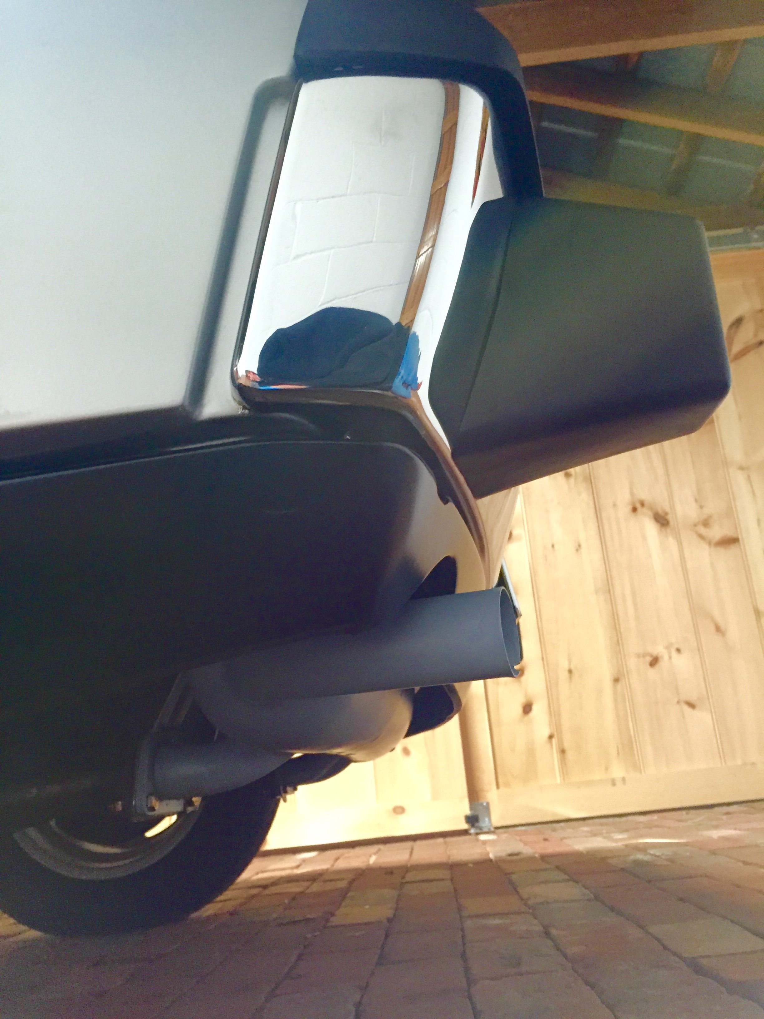

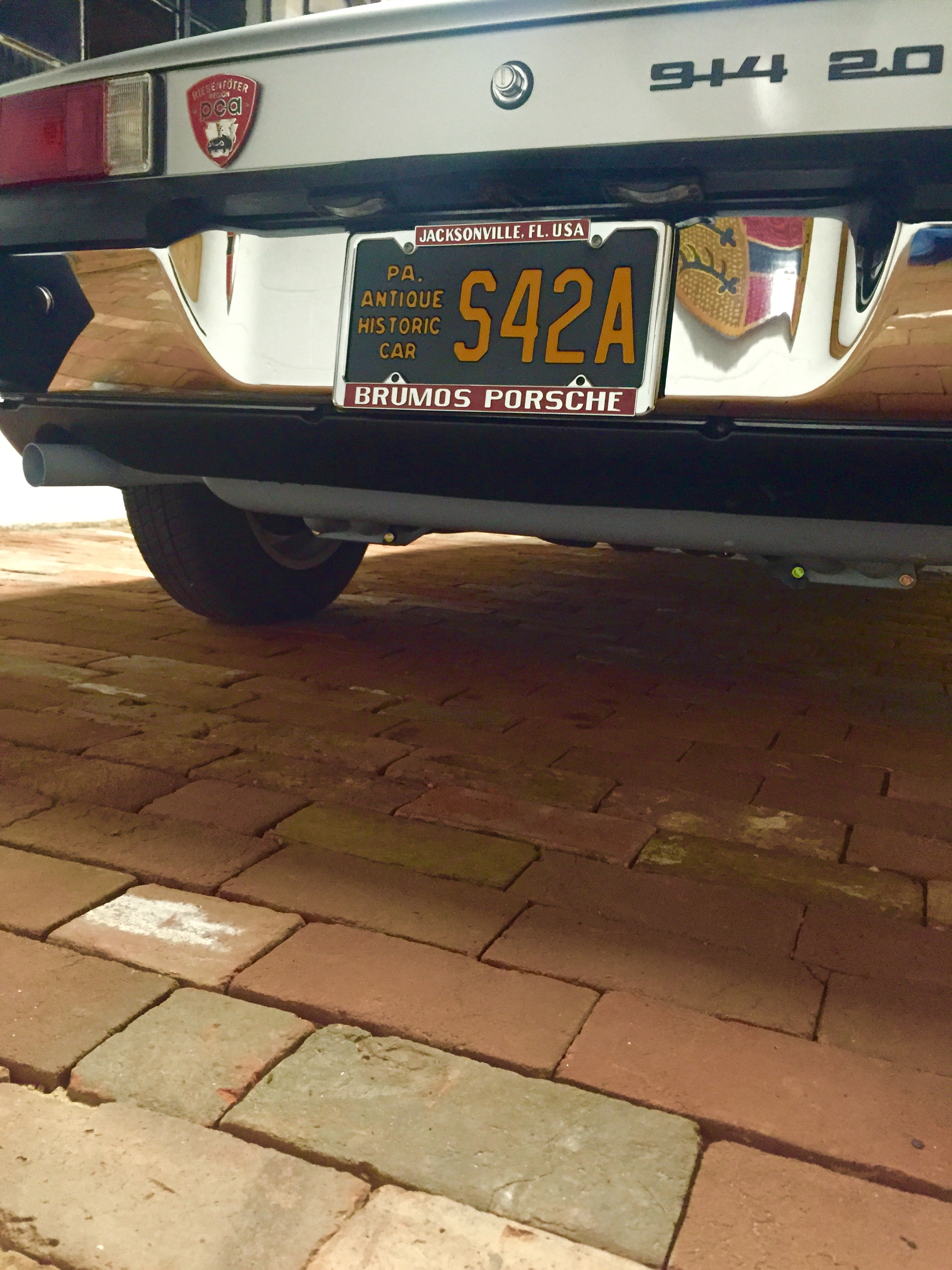

Update.....I ended up using the VHT SP100 primer and the VHT SP104 flat grey finish paint. It turned out very close to the factory grey color and very easy to work with. I just need to cure it per the manufacture specs.
Tom_T
post Apr 3 2017, 08:25 PM
TMI....
Posts: 8,321
Joined: 19-March 09
From: Orange, CA
Member No.: 10,181
That looks real nice Jeff!
Tom
Jett
post Apr 3 2017, 08:28 PM
Posts: 1,694
Joined: 27-July 14
From: Seattle
Member No.: 17,686
Great job, looks clean.
...also motivating me to do the same (IMG:style_emoticons/default/smile.gif)
