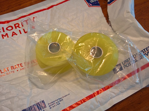

Why yes, I'm glad you asked. Allow me to share: Arrived in package from some very reputable vendor.

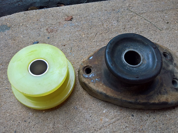

Comparison of old and new. The new one does not have the cup for (or formed from) the strut lock washer:

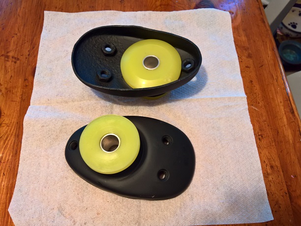

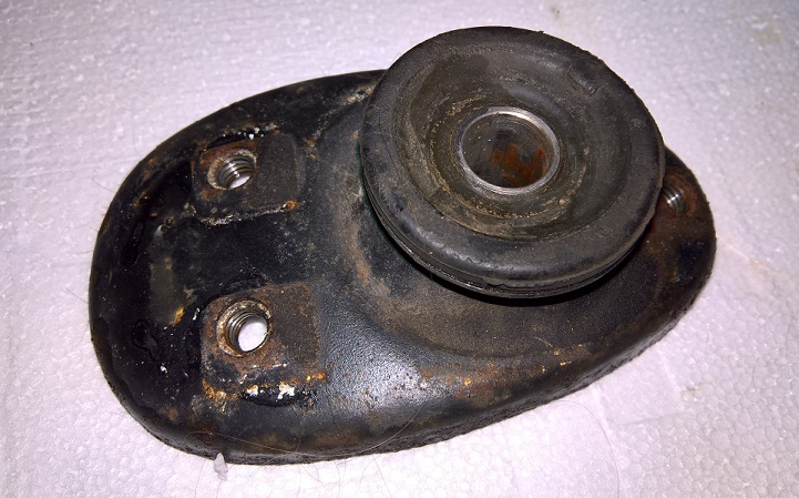

After pressing out the old, the new ones were easily installed as they are actually two pieces and fit very nicely. A press helps, but removal and installation could probably be done with a vice.
After cleaning up the mounts a bit, they look like so:
These came off my project car. I have not installed yet on my daily driver, as I am pretty sure the suspension geometry is going to change as a result of installing these.
Last weekend I installed turbo tie rods, and so an alignment is in order anyway. May be a good time to road test these then. I did fit them over my old struts, and they do fit like a glove (IMG:style_emoticons/default/beer.gif)
