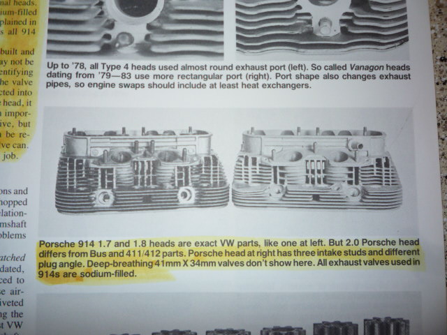

In the pre internet days I rebuilt my Type 4 engine using the Hayne's 914 manual, Clymer 914 manual, and Tom Wilson's VW Aircooled Engine book. Now we have the internet and Jake Raby's Type 4 CD.
maf914
post Apr 26 2019, 10:00 AM
Not a Guru!
Posts: 3,049
Joined: 30-April 03
From: Central Florida
Member No.: 632
I wonder why my attachments stacked horizontally and not vertically? First time this has happened for me.
