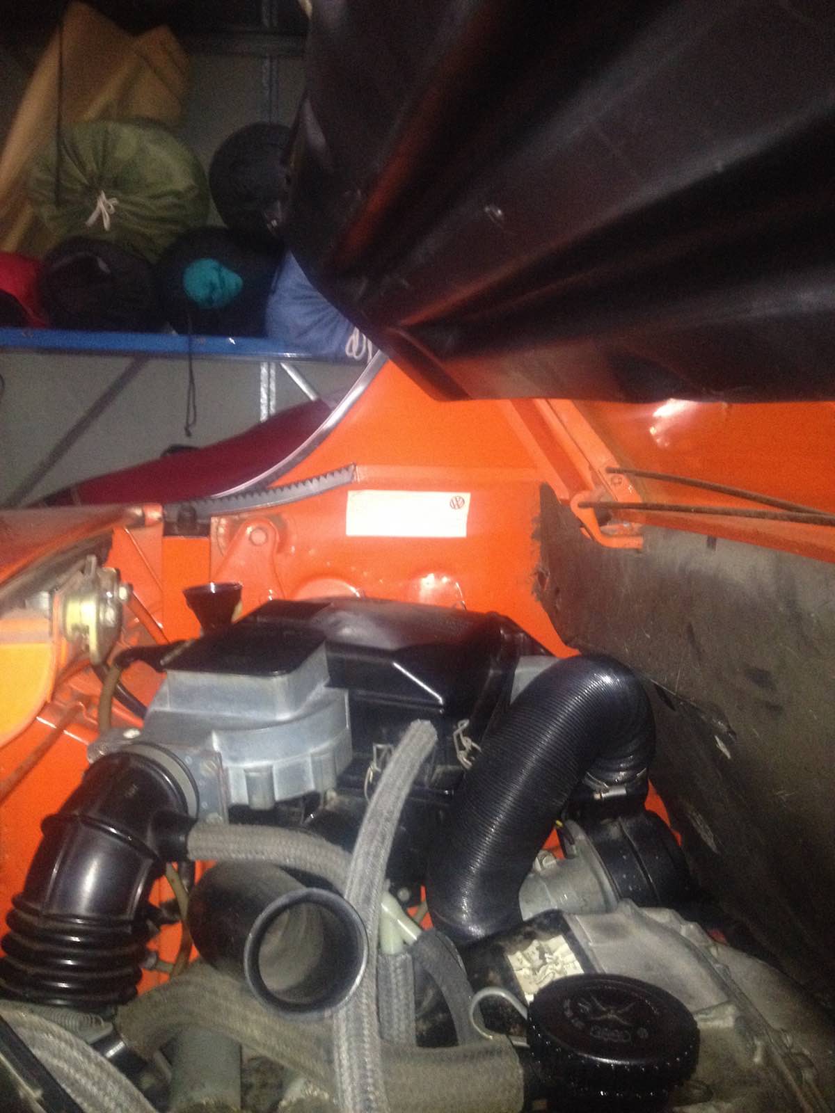

I borrowed this pic from @skota23 in another topic. Does anyone know where to buy the hoses like this? I have seen and tried others but they have issues and I wanted to try these.

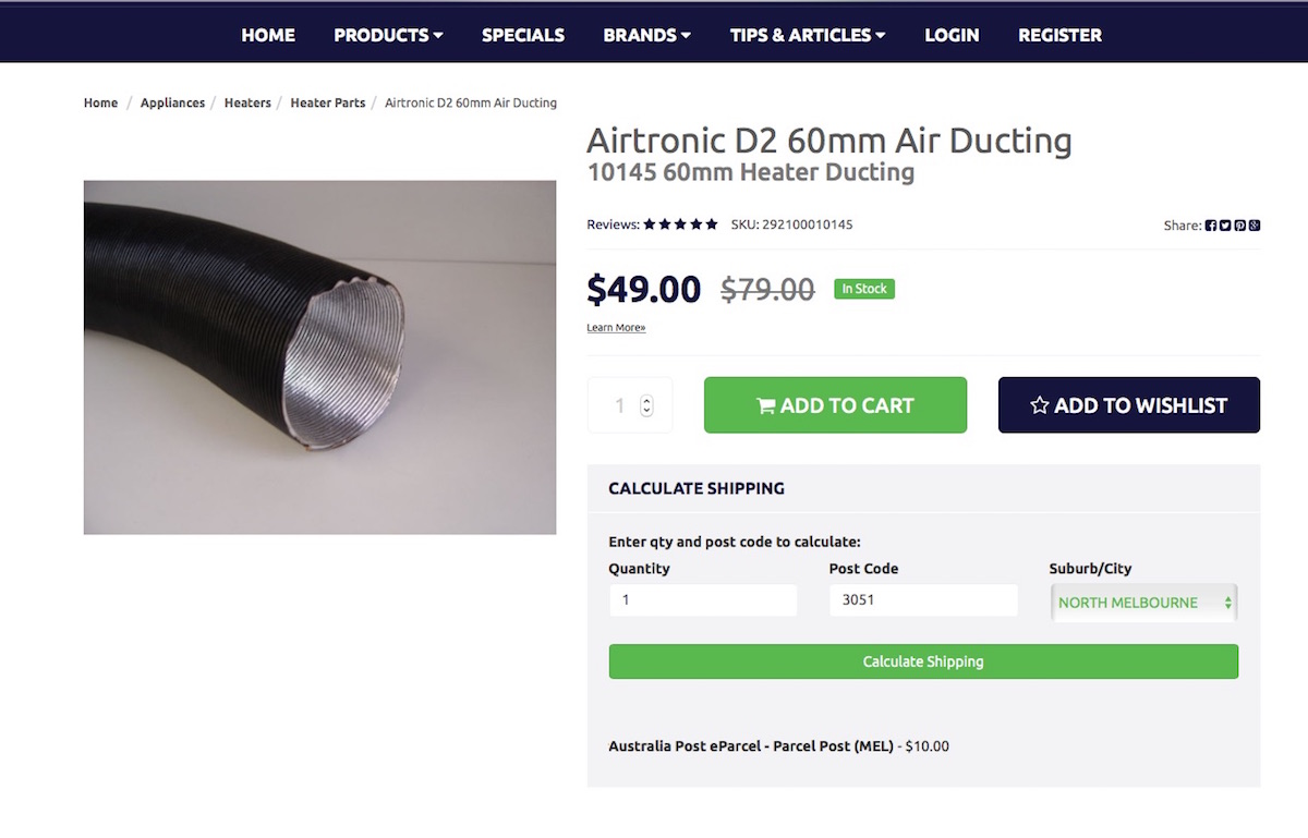

so more recently i tracked down some Eberspacher ducting. used for caravan/camper van heating and a/c systems. its 60mm diam. i cut a length of this and sleeved it very tightly over the existing two ends of original hose. this let me use the end sections with the original clamps for a good fit to the blower and the engine tin. its been a good binding fit to the original hose halfs and has not worked its way loose.
this hose is fantastic. almost indistinguisable from original. it bends to shape but retains shape it is bent to. its perfect. i am sure you can fit it directly to blower fan and engine tin without fussing the simulation of the factory part like i did.
eventually i notice most original factory heater blower hoses bite the dust and develop splits anyway by this point in time.
https://www.caravanrvcamping.com.au/airtron...60mm-outlet-kit

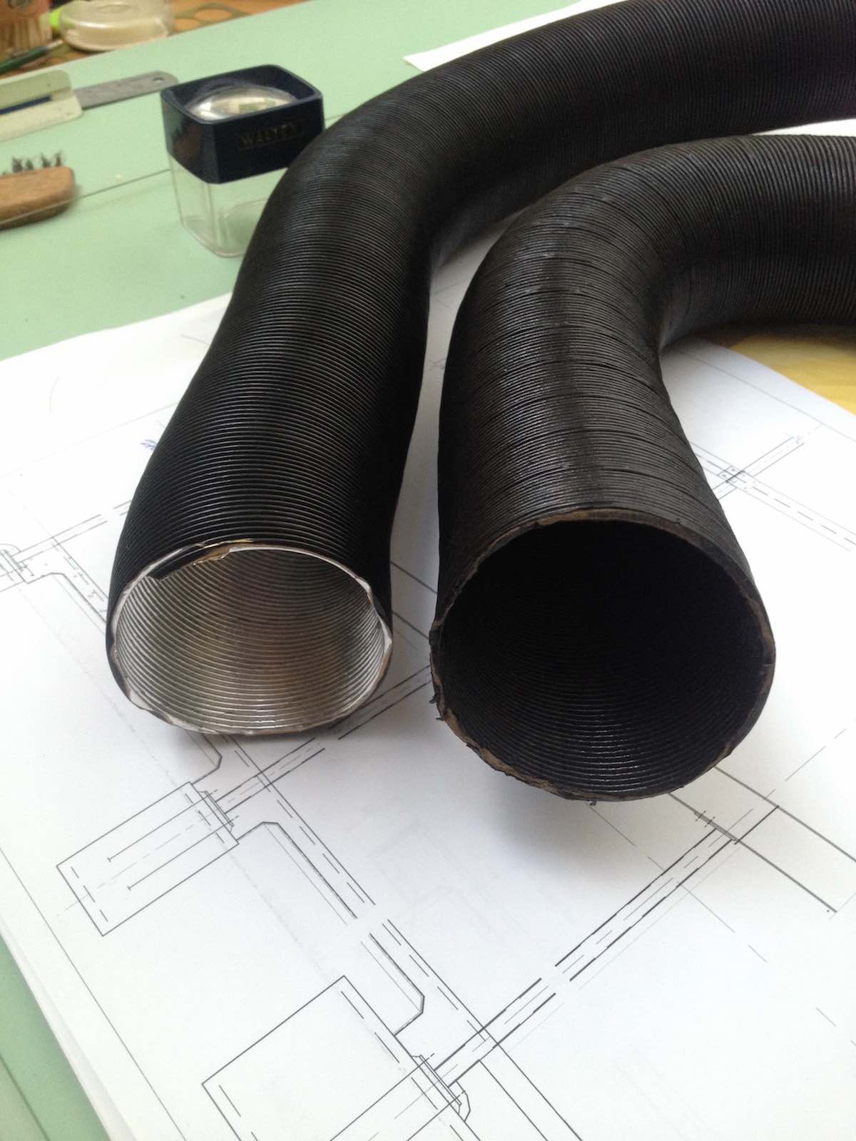

airtronic ducting i now have on left. 60mm diam.
mercedes benz ducting i had used on right. 65mm diam.
how it looks in engine bay.
nice semi rigid ducting that holds to the shape you bend it to.

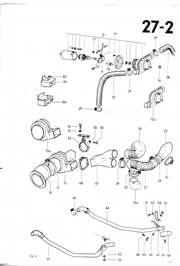

here is page from 411/412 parts catalogue.
had it filed away.
the original mod, whether by dealer or by owners back in the day, was sourcing parts from VW book. you can see all the bits. duct splitter. the stand off clamp. though i was wrong about attaching it to cooling fan casting in 412 variant. variant used the standoff clamp to hang the motor from underside of top of engine bay sheetmetal. for 914s they just used the clamp to support the hose and fixed it to one of the nuts on the fan casting. and they used the long hose.
none of this is there in 914 PET. all it lists is "additional blower" (ie later blower) and one short length of duct at 450mm. the only thing special to the 914 was it did use a transition piece out of the variant fan that was rectangular to circular for the single circular hose.

correct.
and 64mm diam hose is too big.
i know that from earlier experiment with mercedes duct.
60mm e. duct will just fit around the original duct.
just.
you have to screw the original duct in slowly bit by bit.
i think i might have lubricated the original duct with a bit of dishwashing liquid which helped me get the new duct on. in my case i literally used the entire original duct.
both halfs that i had i screwed entirely inside the outer sleeve of 60mm e. duct.
you could easily make a long duct out of surgery on an old original short duct by doing much the same thing.
