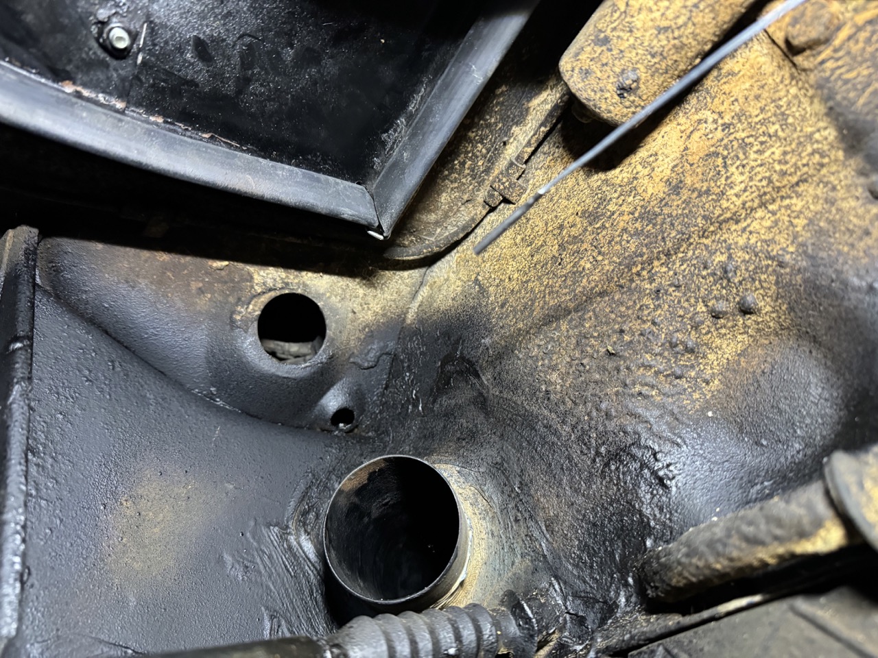

There is a big hole in the driver's side sheet metal of my engine compartment ('73 2.0), towards the front. It is approximately 40mm in diameter, and inboard from the drain hole.
What is it for? And, does anyone sell a plug to fill it? I don't remember a similar hole on my old '73 1.7. And, I don't want to leave such a big hole open, so I need a plug -- I can make one if needed, but I'd rather get the correct part if possible.
Here's a pic from the underside. The hole in question is the top-most, just under the rubber engine gasket.

Somebody added a drain hole. Is there one on the other side?
Good idea & nicely cut without any damage. Don't plug it.

914-6 oil return line to tank..left overs from 914-6 production..
4s had a white/clear plastic plug..

914Rubber sells them. Link below.
40mm Body Plug

Do not plug the smaller hole next to it. That is where rain water drains. There is one on the other side of the car too.
