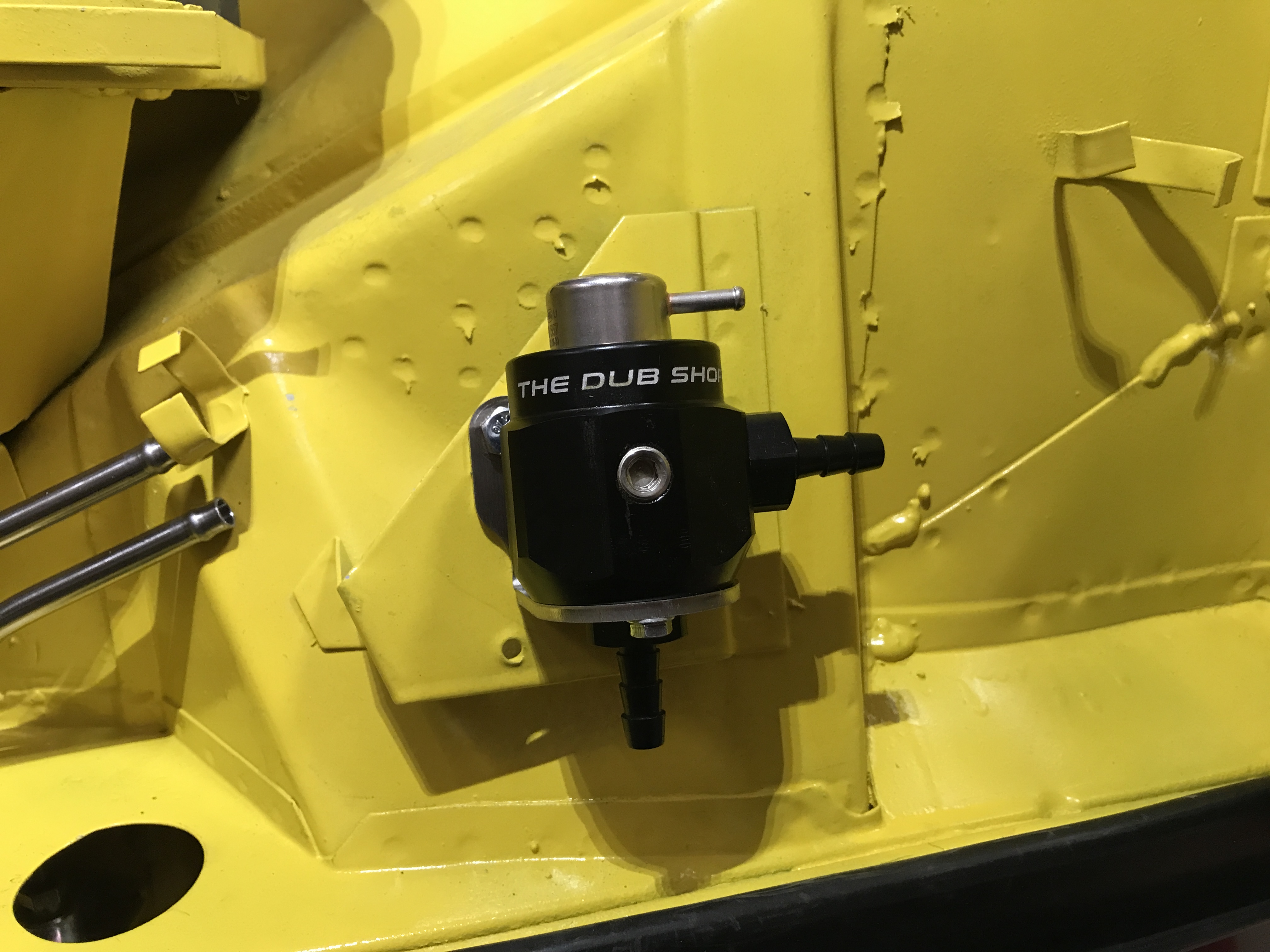

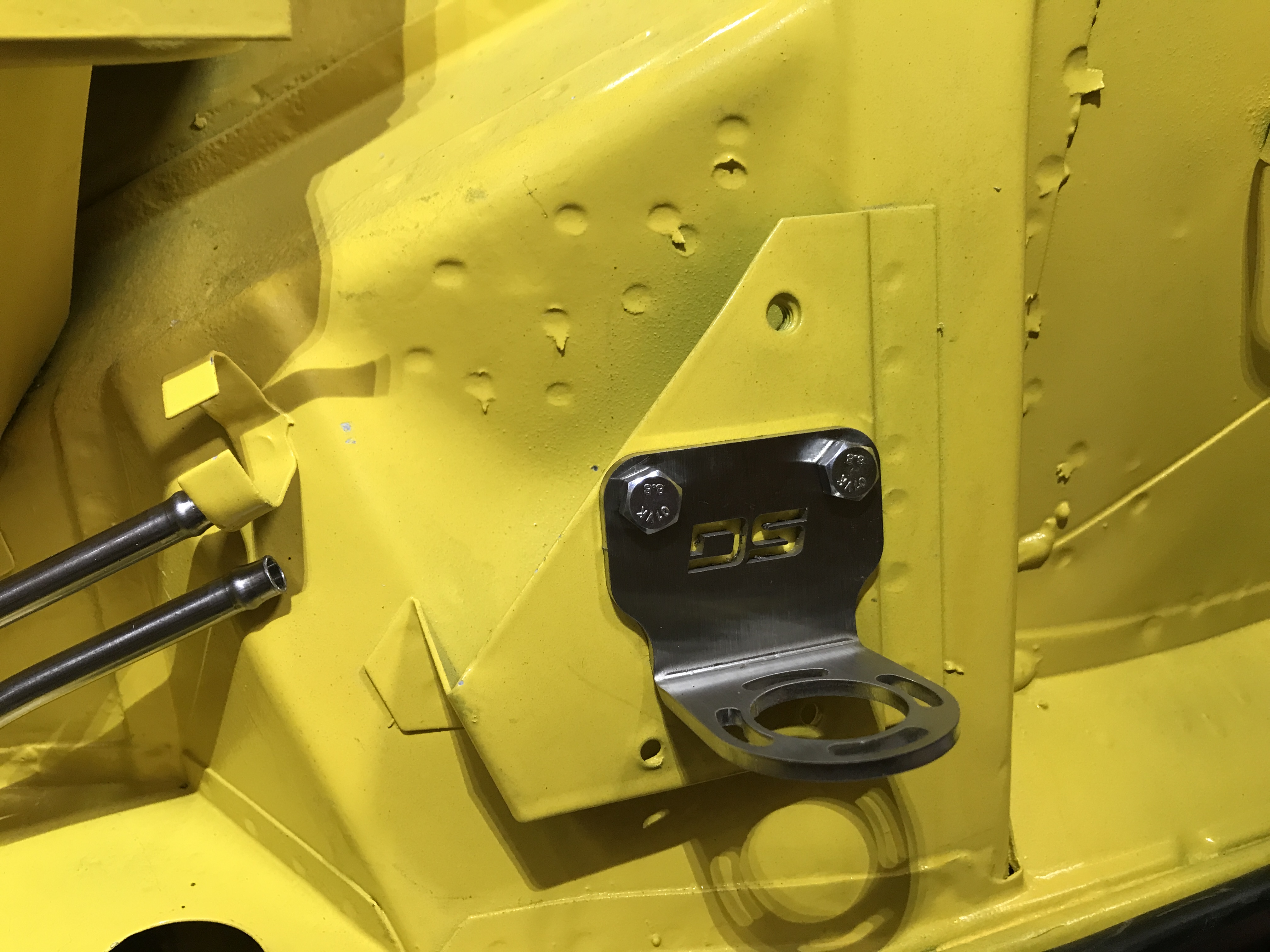

Here's how I mounted mine. First the Dub Shop bracket.
bkrantz
post Nov 15 2024, 08:19 PM
Posts: 8,571
Joined: 3-August 19
From: SW Colorado
Member No.: 23,343
And regulator.

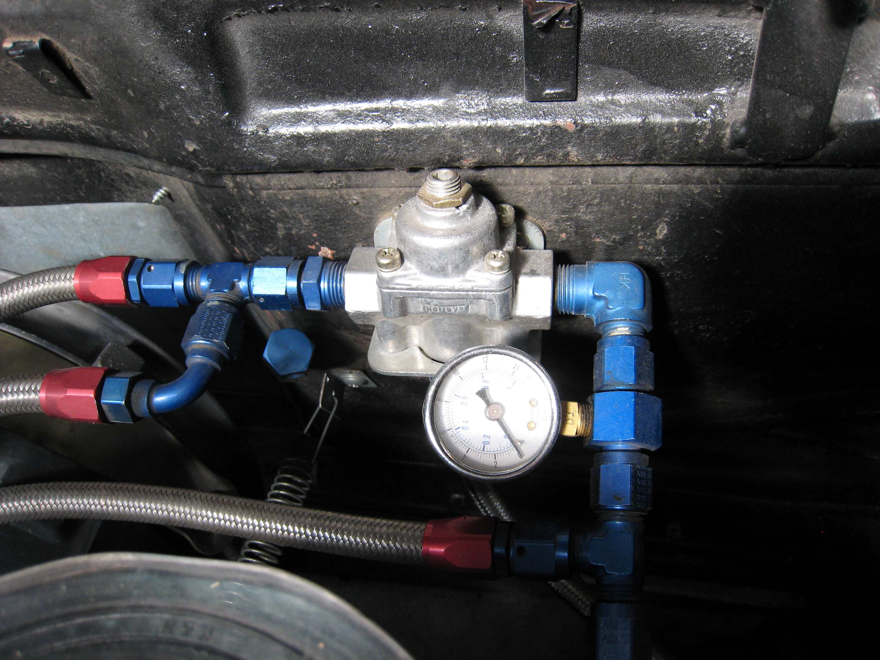

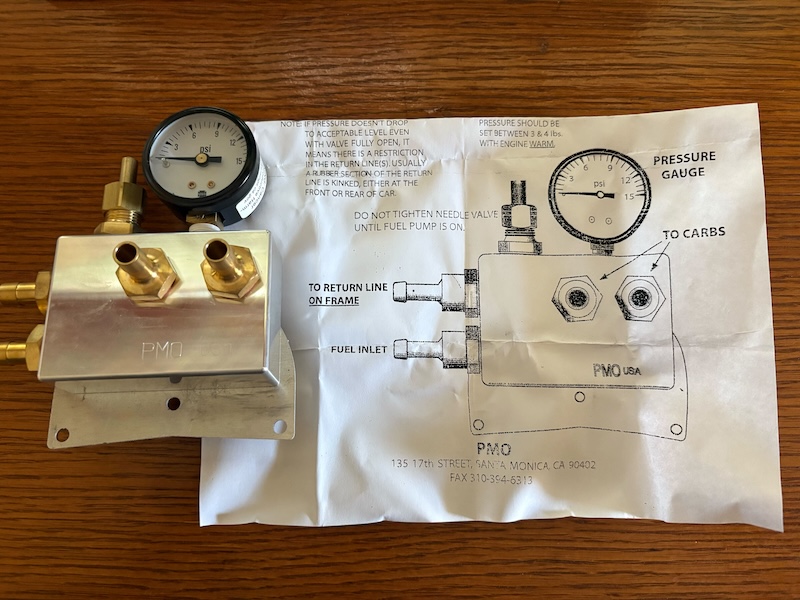

@930cabman - see @Retroracer s comment in this recent thread:
http://www.914world.com/bbs2/index.php?sho...p=3193899&#
I'm currently adding a return line to my carb setup and want a regulator that can be set to 3psi. Apparently, most return type regulators seem to have a higher pressure range.. like >4. This one is low pressure, has the gauge built-in and increases your engine horse power just by looking at it. (IMG:style_emoticons/default/biggrin.gif)

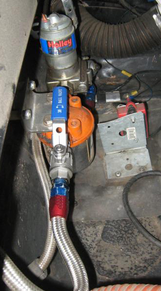

I run a Holley bypass regulator model 12-881 adjustable from 4.5 to 9 psi. The bypass regulator is right after the pump and a second Holley regulator model 12-804 adjustable from 1-4 psi at the engine to feed my Webers. My fuel pump is a Holley Blue 14psi.
In order: Tank - Shut off valve - Fuel filter - Fuel pump - Bypass regulator - Regulator - Carbs.
I've had this arrangement for years on track and now street only. Works great!

@neyen14 - You've got options and I've seen some diagrams out on the Internet that can probably help you. I went with the PMO regulator. I've installed a return line and have dual Webers. I guess this would be an internal "T" out to the carbs.
