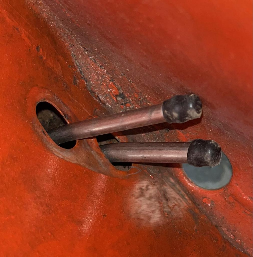

@bdstone914 .
Finally got a chance to climp up and look..
This is what I found….????

thats why I love this place, after playing & working on these cars for years you can still learn something.

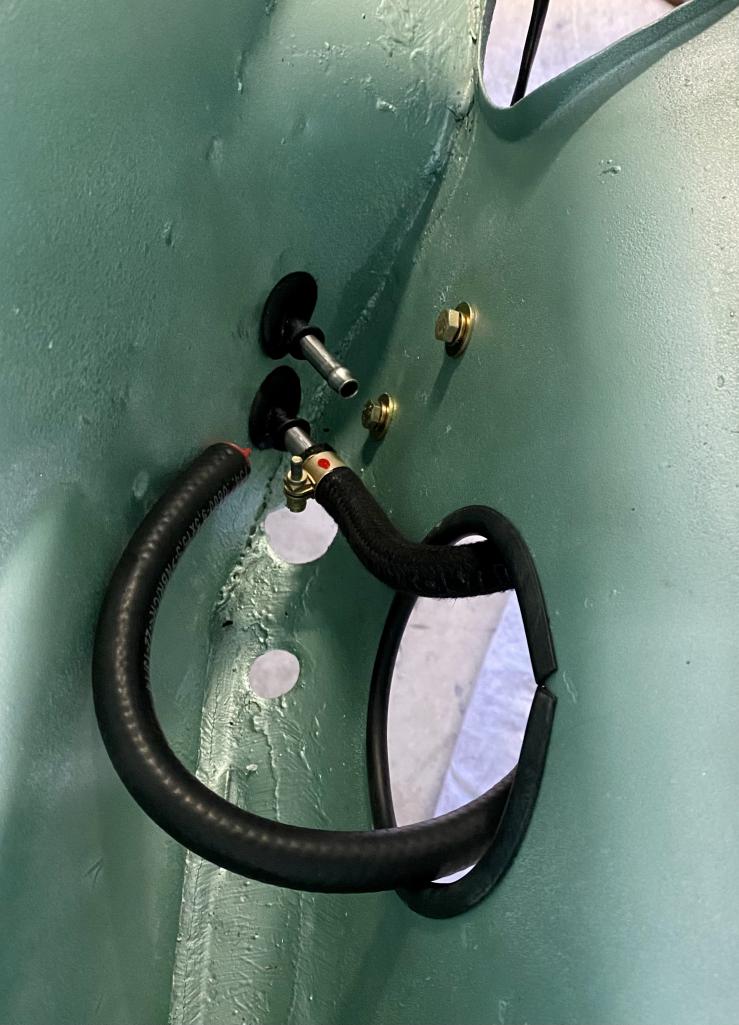

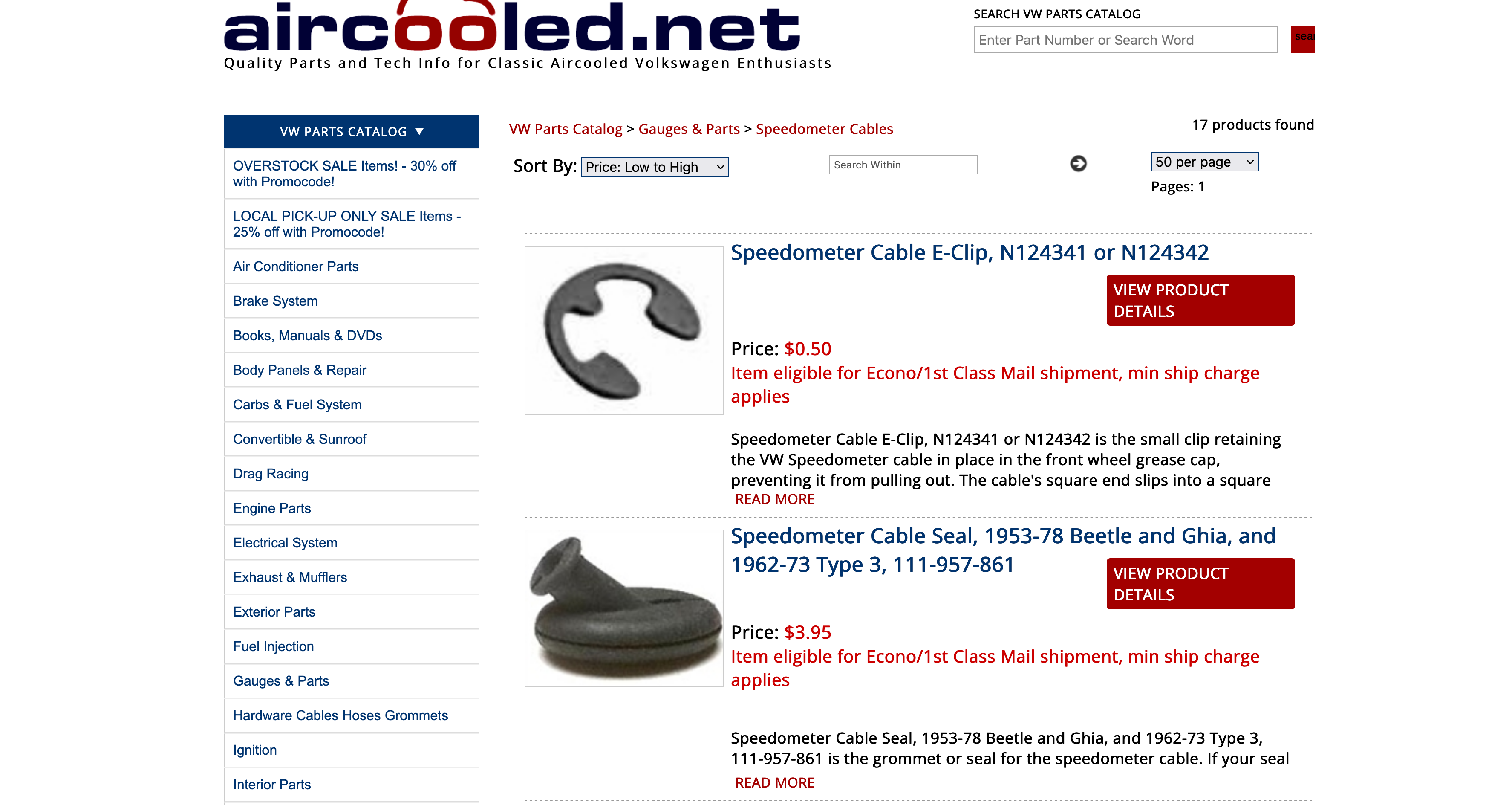

Its the same grommet used for the plastic brake pipes VW# 111 957 861
I don't believe it changed to the large single grommet until late 74 possibly 75 when the pump got moved up front.
This is on an early 914-6 for reference

QUOTE(aturboman @ Feb 7 2025, 11:28 AM) *
Nope. 73-74 certainly used the 2 hole grommet.
I have broken a lot of cars but looking back, fewer of the very early cars thus my unfamiliarity (or is it just old age (IMG:style_emoticons/default/rolleyes.gif) ).
Now comes the originality question what MY did the factory change the chassis & simplify the grommet .. 70-71, 71-72?

Just to clarify, my car is a relatively
early 914/6. # 619

Same gromet as VW speedometer cable

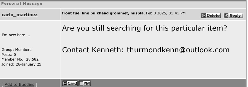

And then this…????
For a couple of rubber grommets..???

looks like a scammer

How is is NOT obvious that this is a scammer???
