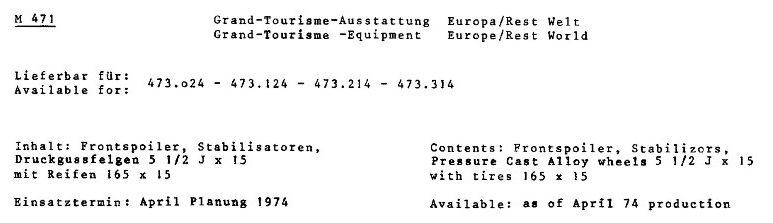

post Feb 6 2025, 06:38 PM
Posts: 9,351
Well if you ask me, I have a different take on the 914GT than the race car version. All very official, well-documented and legit.
The 914GT was a Euro market 1974 model year 914/4 2.0L commemorating the 100,000th 914 made. Offered in two versions Black/Sunflower Yellow & Light Ivory/ Phoenix Red. They were made in limited quantities, loaded up with optional/special equipment, paint scheme, front spoiler, a new side stripe design, and even a dashboard medallion. Many gravitate towards the flared car/big motor version and I appreciate them of course, but the 914/4 version is just as interesting to me and a few of us here on this forum, if not more so. Join us if this interests you too.
AKA the 914 Jubillaumsmodell (100,000 914 celebration) in Europe
AKA the 914 Limited Edition in the USA
AKA the 914 SL (Sports Limited) in Japan
I know, I know...I am on the path less travelled...but diggin' it.
Don't hate me. (IMG:style_emoticons/default/bumblebee914.jpg)
