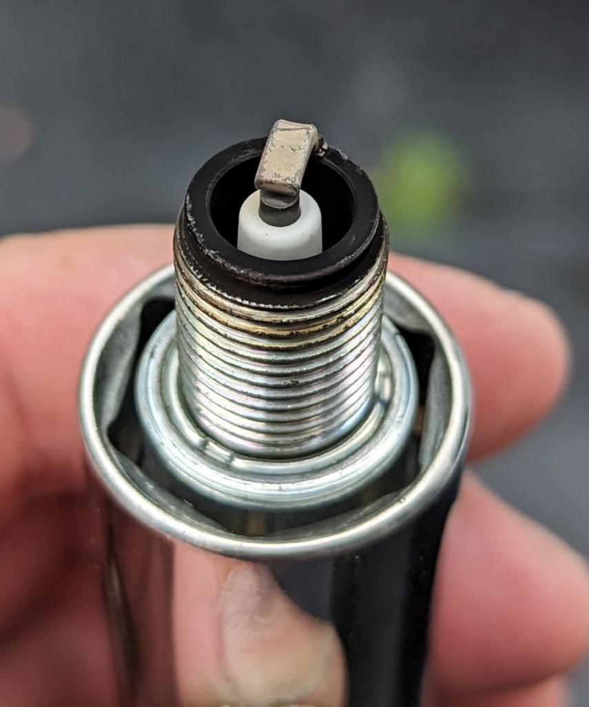

2400-2600 rpm stumble with partial throttle, stumble goes away under full throttle. Runs smooth at all other RPMs. Pulled the plugs, a little lean maybe?
Edit 3-17-25 I found a possible cause; worn distributor bushings causing a variation in the points gap.

That is looking very lean as well. Is this stock? Have you checked the resistance on the CHT? Has your MPS been played with?

None at of those plugs are lean

QUOTE(Superhawk996 @ Mar 14 2025, 08:05 AM) *
Maybe I don't understand your post but are you saying those plugs are not lean? They look dangerously lean. Baked on white powder with little orbs of metal isn't something I would want on my plugs.

QUOTE(emerygt350 @ Mar 14 2025, 12:00 PM) *
Those plugs are no where near lean. Brown / light grey would is completely normal plug color.
The little orbs and the flaking you see are called glazing
The glazing is a result of the incomplete combustion is occurring when the engine is stumbling and missing during the part throttle acceleration acceleration problem he’s having. The glazing comes from the plug heat cycling rapidly as combustion happens and then doesn’t happen. The deposits occur when the combustion isn’t complete (ie missing) and then that deposit gets baked during the time when combustion is occurring.
Solve that part throttle stumble and the glazing goes away

Interesting, i am trying to find my old post when I had plugs like that and everyone yelled "lean!!!" but I can't find it (2022?). It would have been good to know that is a sign of something else.
post Mar 14 2025, 12:31 PM
Posts: 7,025
Here’s your post ?
http://www.914world.com/bbs2/index.php?sho...293&hl=Lean
This is most definitely a lean plug - white as snow

To me that is a clean plug with your 'powder' on the ground. I had another post with plugs that looked just like the OPs. It's the powder coating that I am interested in. If it is the cycling miss that causes that I am happy to find out that is cause. That was, I believe, before I figured out it was the TPS causing the miss. This year (once the alt. Is replaced) I plan and leaning the mixture on the mps. It will be interesting to see how the plugs respond.

I had these plugs under a strong LED shop light which may have made them look more white.

QUOTE(SVG223 @ Mar 14 2025, 07:23 PM) *
It is stock. I just pulled the MPS off and was eye-balling the seal. I have heard of inserting a potentiometer in the circuit to tune, which sounds interesting.
I adjusted the fuel pressure from 27 to 34 psi to see if the miss would go away but it didn't. The car did seem to run a bit stronger at 34 psi or it was just later in the day when the air was cooler.
This engine may have been rebuilt. I'm wondering if resistance should be added to the mps after a slight increase in displacement. More to read. I think no.
Let me introduce myself - I’m the guy the just says (IMG:style_emoticons/default/stromberg.gif) like I see it. I try not to be too harsh but sometimes fail.
Stop trying all the internet “easy” fix rumors that were proven to be BS decades ago.
Putting a potentiometer in the MPS circuit most definitely isn’t a solution. The MPS works by varying inductance - not resistance so adding resistance into the circuit as a troubleshooting technique or a solution is a no-go.
Raising fuel pressure isn’t going to address an intermittent stumble as you’ve now discovered and have verified.
Things you should be doing:
Step#1. Replace those spark plugs - the glazing they have developed can cause misfire. Glazing isn’t easily cleaned off. Spark plugs are cheap. Trying to diagnose an intermittent stumble with questionable plugs only makes the task 10x harder. Look at pic #3 - you have enough build up on the center electrode that it’s thick enough to be flaking off. That stuff is not conductive and impairs the spark from jumping the gap. Do this before doing anything else. Go for a brief drive - you may find that alone cures the stumble. However if it does fix it - you still need to address what is causing the glazing.
Verify, clean, and tighten all grounds. Intermittent grounds cause havoc with FI in general and are a common cause of intermittent issues like stumble and misfire.
Verify the TPS - it can be bench tested. Guesswork not required. Replace the TPS board if it is defective. Testing procedure is well documented. The TPS acts like an “accelerator pump” as you tip into the throttle. Make sure it’s working via testing not guessing.
Verify your Ignition system. I don’t know why this hasn’t come up yet. Ignition problems are very often mistaken for fueling problems.
Ignition to do:
Inspect / clean / replace distributor cap if necessary. Corrosion build up and wear on the internal terminals is a common cause of misfires.
You don’t mention whether you’re running points or electronic ignition - inspect verify it’s all working. Especially if you’re running points.
If using something other than a 123 ignition you need to make sure the advance plate is clean, lightly greased, and smoothly moving allowing timing advance smoothly and consistently.
Verify timing. You need to verify timing advance is smooth and consistent. Especially in the RPM range your having the stumble. Personally - I’d put the timing light on every wire and verify the advance is smooth and consistent and that all wires are firing OK.
Replace wires would be the bottom of my list. It might move up a notch or two if they are ancient.
Do these steps before even contemplating messing with the MPS.
