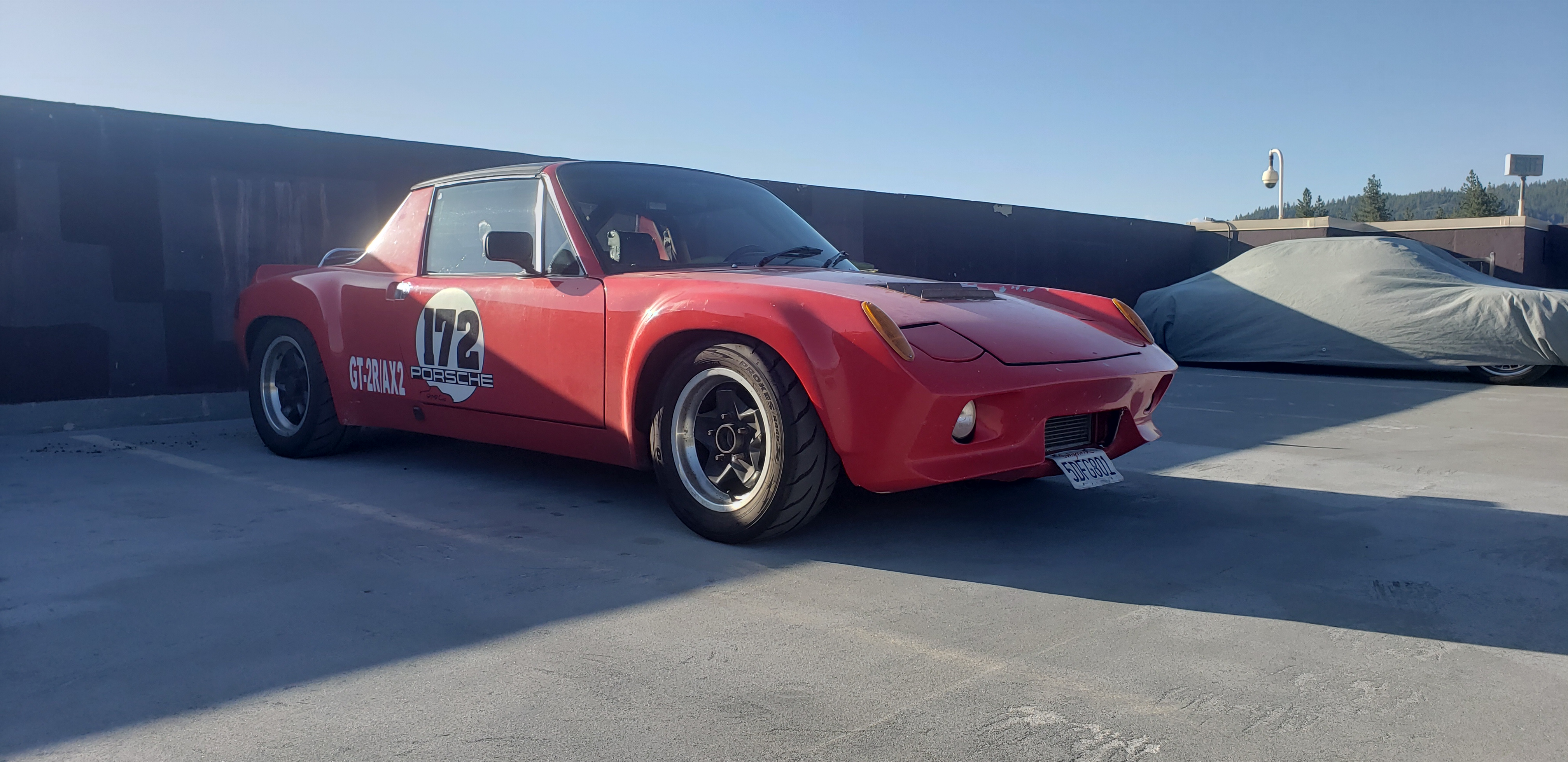

On my GT project with steel flares we are planning on 15X7 fronts and 15X9 in the rear.

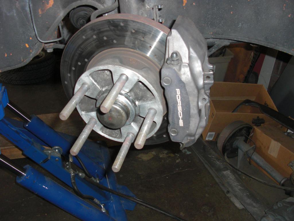

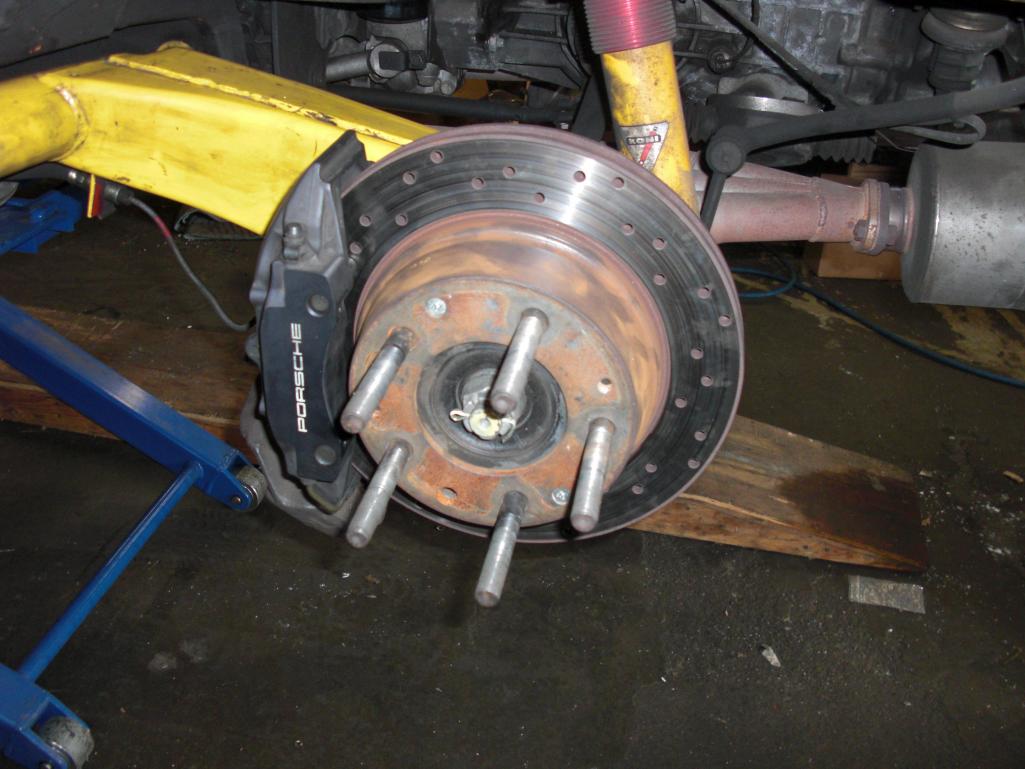

After years of juggling different sets of wheel spacers and wheel studs for different sets of wheels (AX, track, street) i finally had enough and added 100mm wheel studs on all 4 corners.
Now i have one set of spacers for the street and one set of spacers for track/AX.
Easy to swap around when needed.
I never looked back ...
(IMG:http://www.914world.com/bbs2/uploads/post-179-1330326828_thumb.jpg)
(IMG:http://www.914world.com/bbs2/uploads/post-179-1330327329_thumb.jpg)

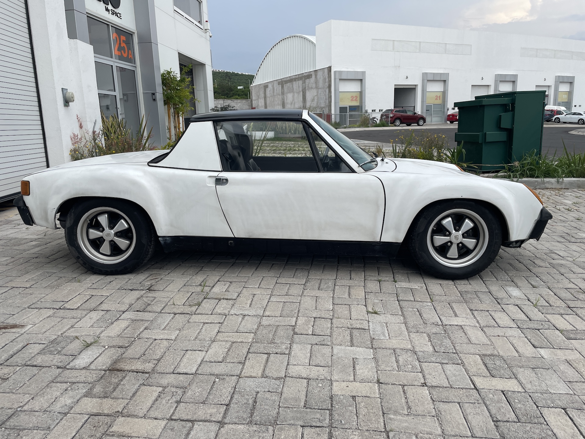

One other reason is that the flares were in the car when I bought it, and I'm trying to use one of the wheel sets I already have instead of buying a new set. This is how the car looked with the 7x15 before going to the body shop.
