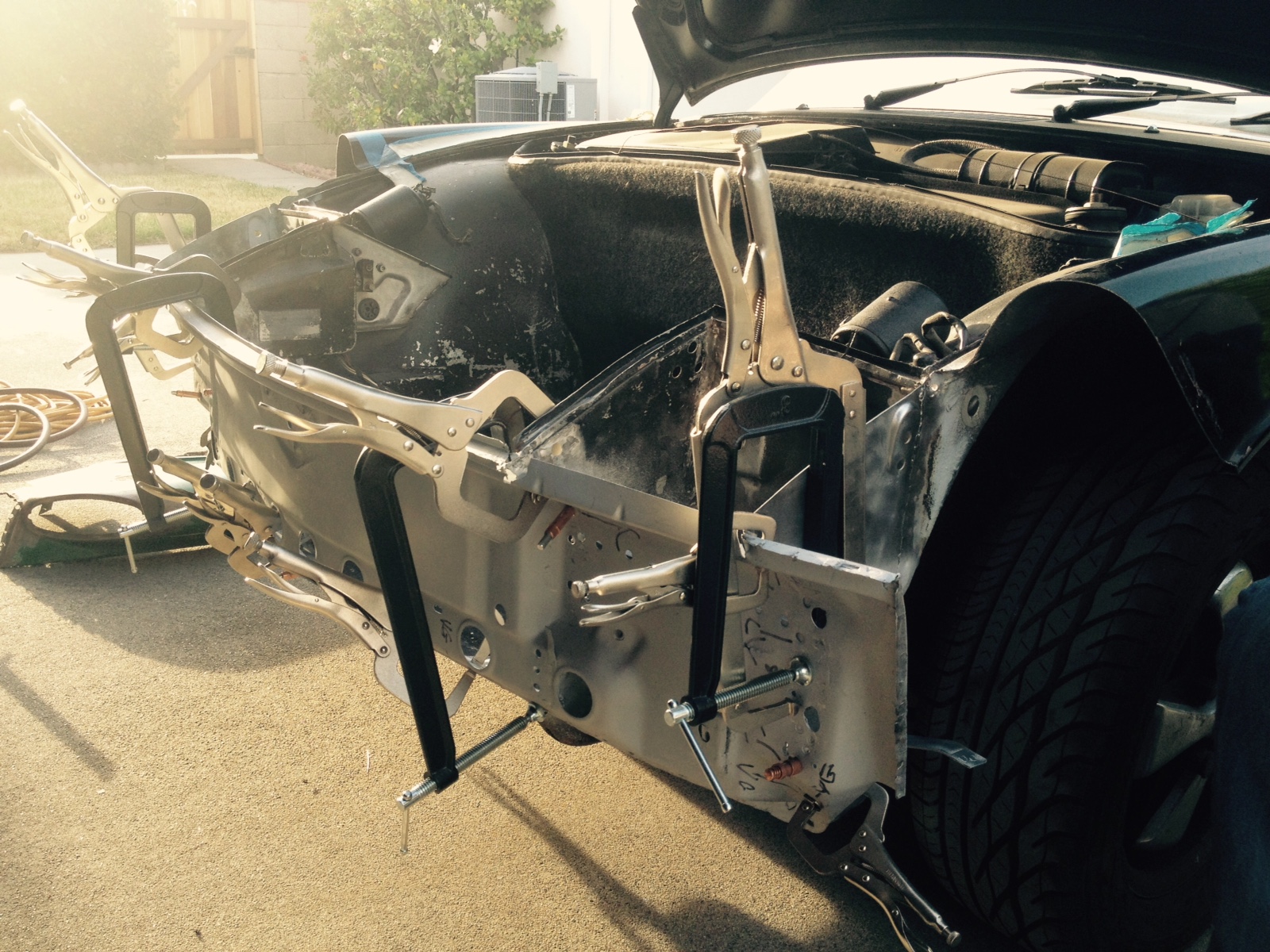

Here I used a ‘74 panel on a ‘72, I removed the half moon brackets. Everything lined up, a little difference where inner panel of the headlight buckets mated to the panel.
Attached Imagem

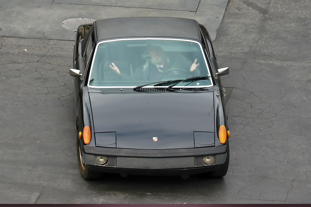

Additionally I used ‘76 turn signal front corners adding the reinforcement brackets for the bumper.
This is the finished product.
