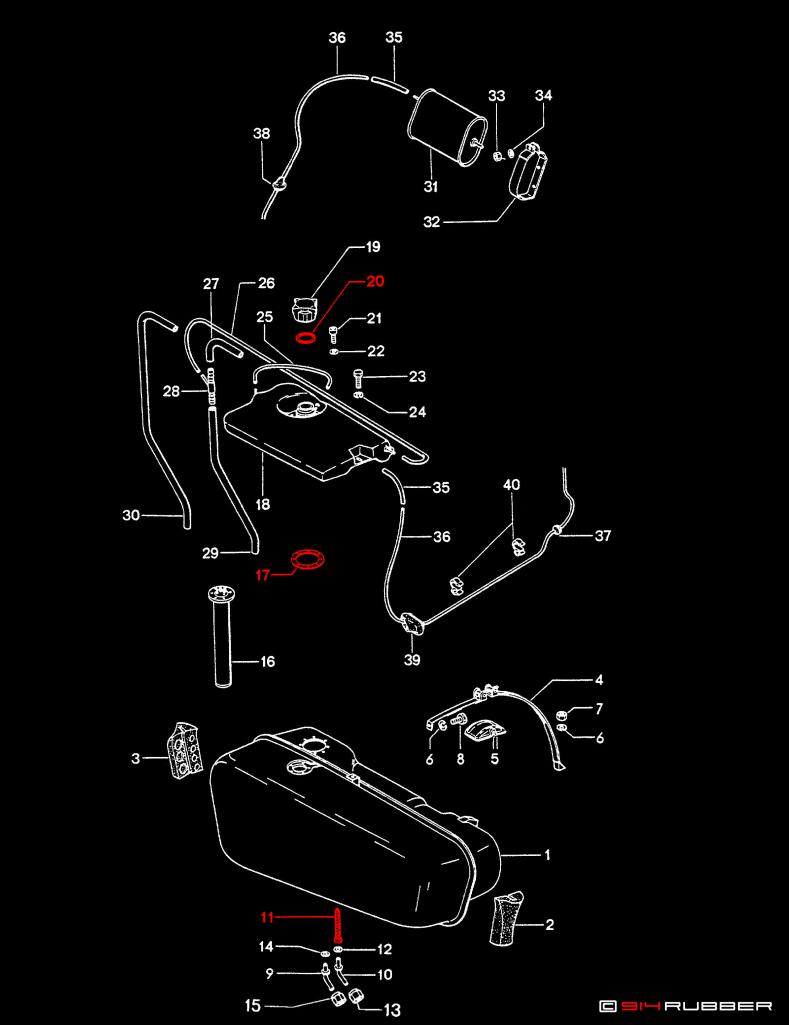

The fuel screen fits into the bottom of the gas tank. The fittings at the bottom where the fuel hose fits to the tank. the screen is connected to the supply line and sits inside tank.
If you have a blockage in the line then the lines should be replaced. If fuel lines are plastic those are as old as the car and should be changed out for you and your cars safety.

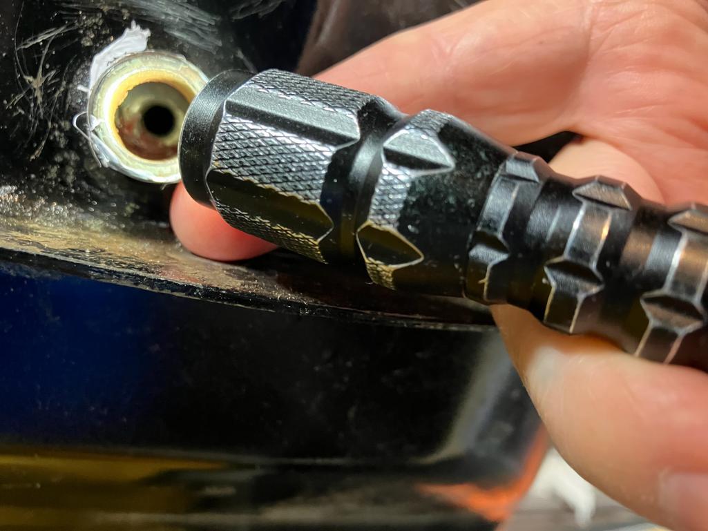

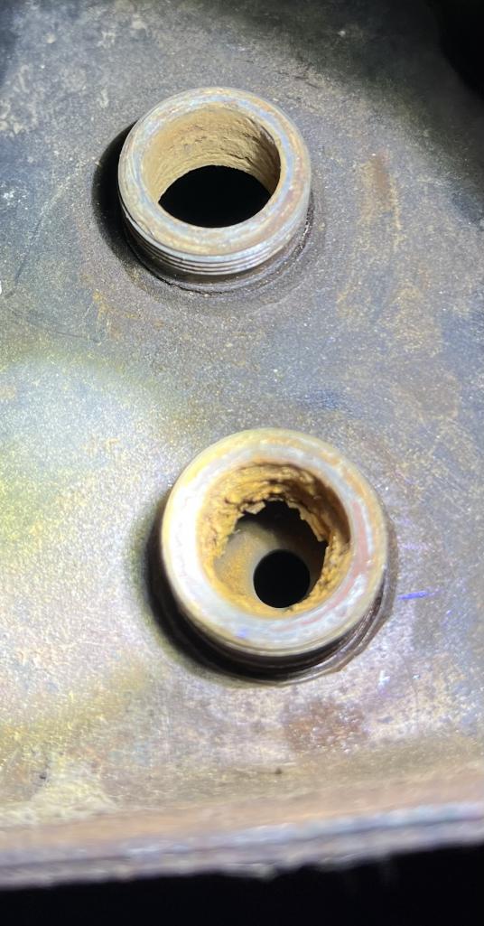

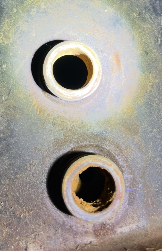

Hello Gentlemen, I have never posted a picture before but I will try. The problem is inside the tank there is a metal piece that will not allow my screen to be installed correctly. It is circular and close to the opening. I will try right now to take and post a picture.

That does not look normal. I will see if I have a tank out I can get to and pull the line off.

That side with the restriction closest to the weld flange is for the return line.

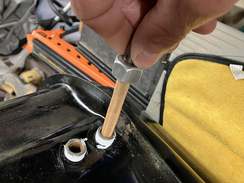

The filter sock goes into the hole that is completely open into the tank.
Attached ImageAttached Image
And ditch the teflon tape on the threads. The seal is established by fiber washers as shown in PET. Fiber washers are available at Harbor Freight, Amazon, Granger, etc. Use the right parts and you won’t have leaks. The teflon tape on the threads won’t do anything to seal the tank.

Yup, Peter Egan is right. I did not remove the tubing, the mechanic at the shop did that. My mistake was looking at the tubing and trying to install it without knowing which port it came from. The screen would not fit into the smaller size port easily causing me to believe it came from larger port. After fooling around for quite a while Ed figured it out!

Rubber spacers? Not sure what you are talking about. Perhaps the "rubber buffers" on the side of the tank (#2 and #3 in the diagram posted by hndyhrr)? It can be helpful to consult the PET and look at the diagrams if you are unsure how something goes together. Go to the tech notes section on Jeff Bowlsby's website and you'll find a link to the PET. Or, here's a direct link:
