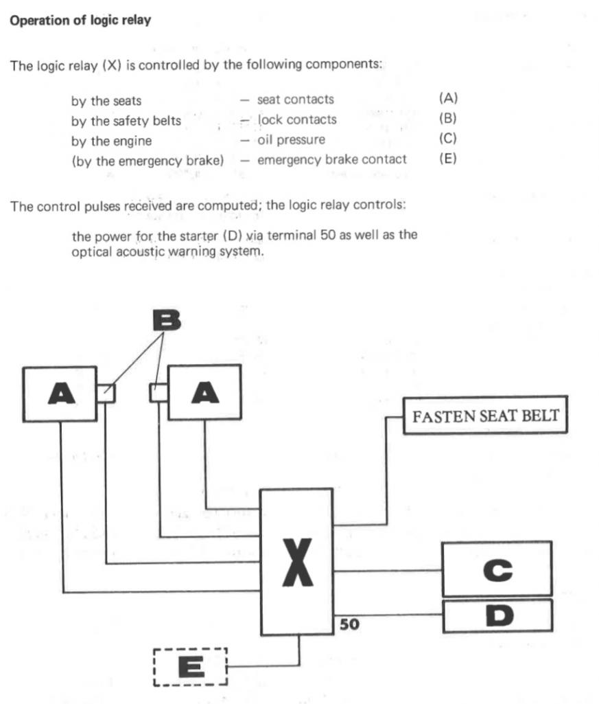

Let’s start with how this thing is supposed to work.
Here is the overview from the service and training manual that Jeff Bowlsby provided from his stash of technical documents.
Attached ImageAttached Image

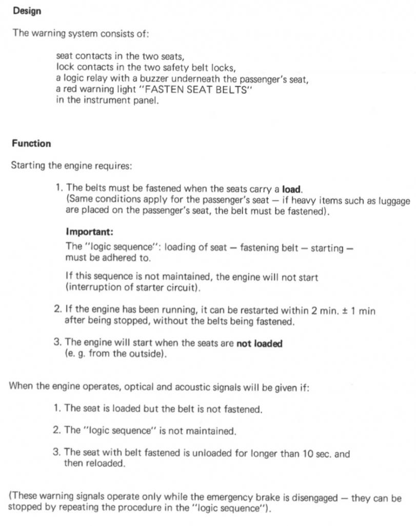

So this is where things start to go astray.
I cannot duplicate the “logic” operation of the training information.
I have two different interlocks that appear to be functional. Neither seems to require that the seat cushion be loaded to enable the starter. I’ll detail this more later in the thread as it progresses.
Second, I have been unable to verify that there is a time aspect as referenced for a restart within 2 minutes +/- 1 minute.
There are 3 electrolytic capacitors in the circuit and it is possible that they are using a RC time constant to affect the circuit. I just haven’t been able to duplicate this and this is why I intend to put the circuit into LTSpice so I can better understand why this isn’t working as it is described by that training document. I am currently working on verify the capacitors. They are 50 years old and although they measure at their rated capacitance, they seem to leak a little more current than they should.
[5/16/25 update - I’ve replaced the 3 electrolytic’s in the best operational relay - still no change in being able to get a seat cushion dependency or a time dependency]
The one thing I haven’t been able to find is a 74’ -76’ owners manual to see how the operation is described there. If anyone cares to post that it would be appreciated.

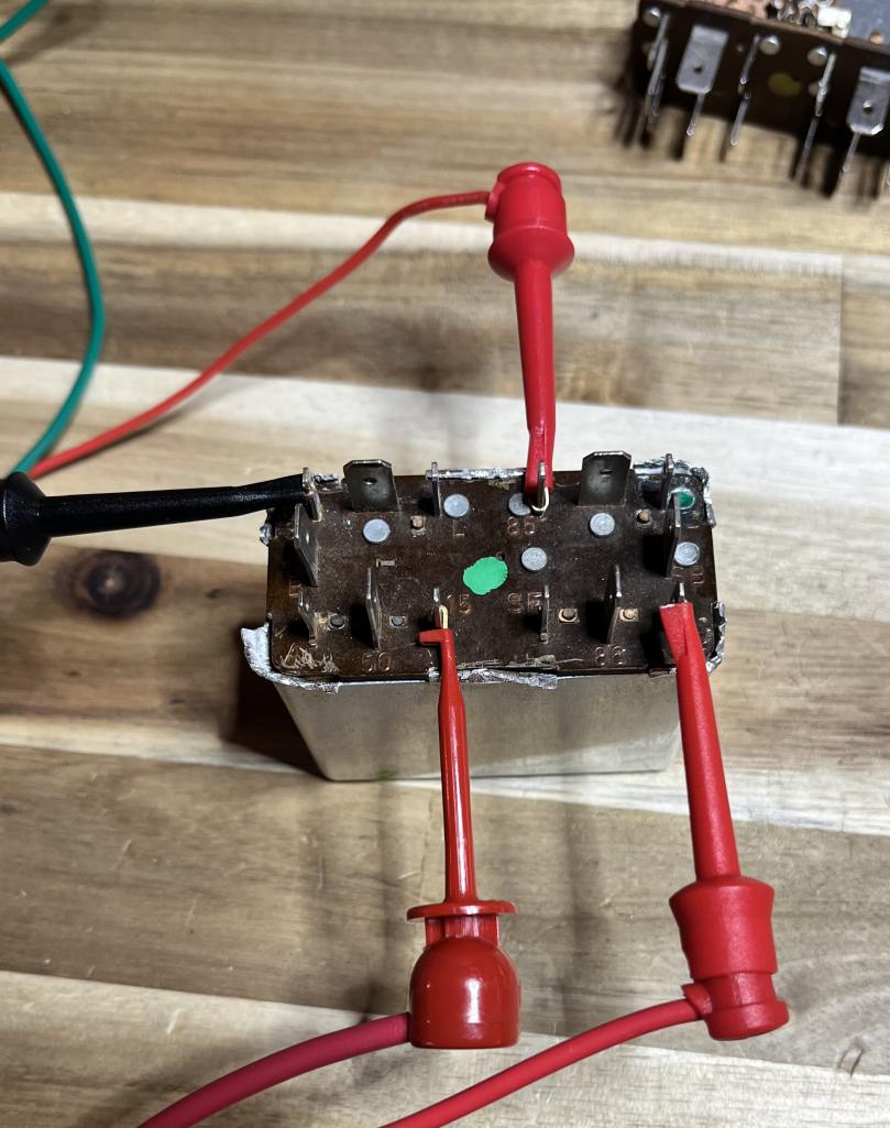

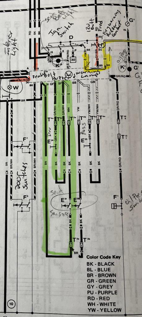

Let’s start with the Haynes / factory manual black box & current flow diagram. This is useful to explain the basic wiring and switch states.
The bench testing will be set up with the following color code:
Ground will be black.
12v power will be red
Switched grounds will be green
12v starter power to the solenoid is yellow
These are highlighted in the graphic below
Driver door only shown as switched ground in green
Door switches omitted - more on that later.
Power enters on pins: 15, 30, 85
Ground is pin 31
Yellow Pins “C” and 50 are the connections that are normally jumpers together when this system is disabled. The connection between these pins is normally completed inside the interlock relay when the seat belts have been fastened and the key is in the START position.

Here’s the basic power and ground Attached Image
post May 15 2025, 03:03 PM
Posts: 7,090

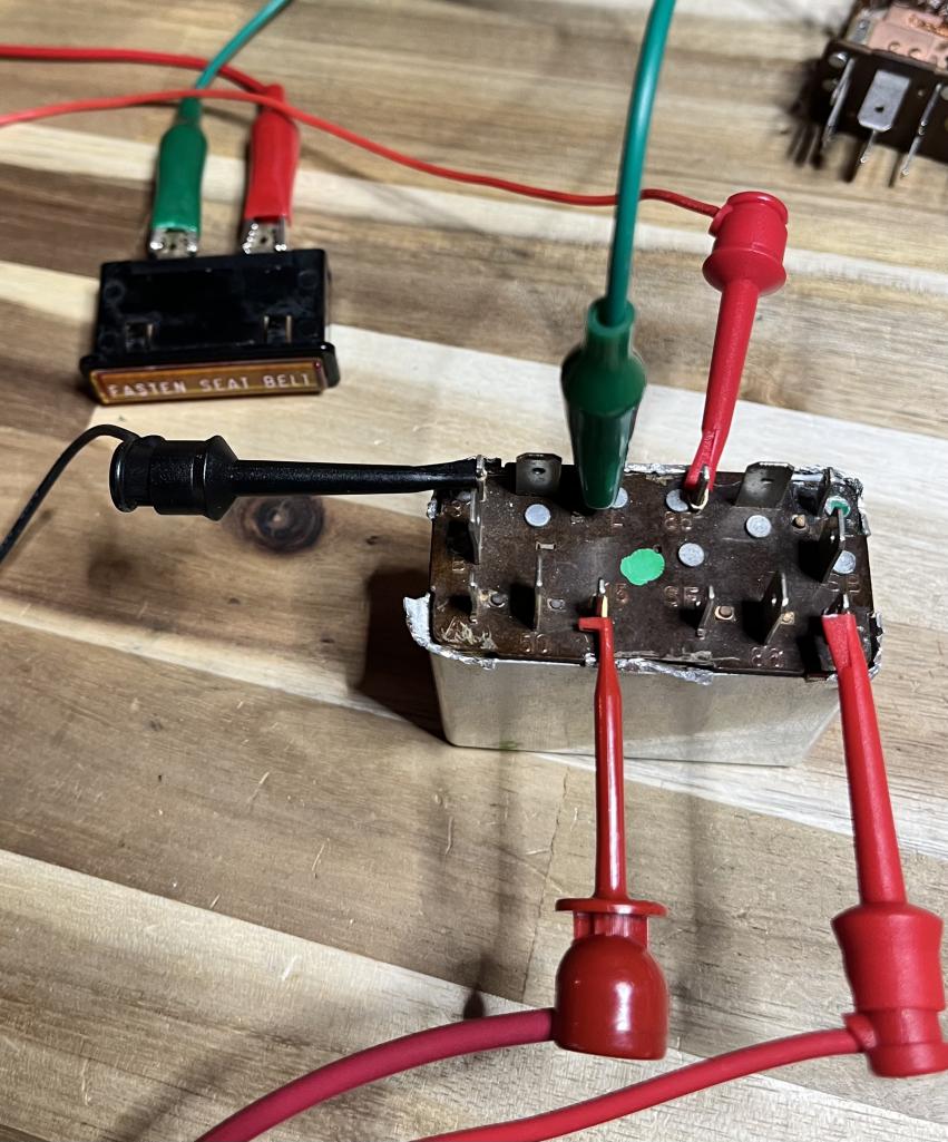

The Fasten Seat Belt light is powered by 12v supplied to one side of the bulb
The light is turned on/off via switched ground coming from the interlock relay on pin “L”,
In the photo above you’ll notice that with no inputs from the seat cushions and no input from the seat belt latch switches - the Fasten Seat Belt (let’s abbreviate as FSB) light is not lit. The buzzer is not active.
This setup represents:
Key in ignition - 12v on pin 85
Ignition on - 12v on pin 15 and 30
Doors closed - no ground connection on pin 86

So let’s talk about the horrific buzzer
If a switched ground is addd to pin 86 representing an open door the buzzer will start screeching. This is shown in the video as the green switched ground wire contacting pin 86.
When the door is closed, the switched ground is removed from pin 86 and the buzzing related to the key in ignition is silenced.
The other way the buzzer can be silenced when the door is open is to remove the key from the ignition. When the key is removed, 12v power will be removed from pin 85. This is shown in the video as removal of the red 12v power from pin 85.
This is the schematic:
https://www.youtube.com/watch?v=XaIyrzDqc9A?si=LNyjKM6TgSI4igj
Note: disregard the yellow starter circuit - I color in my books like a kid and unfortunately that is on the page and not a digital edit (IMG:style_emoticons/default/rolleyes.gif)

QUOTE(Superhawk996 @ May 15 2025, 10:57 AM) *
Here you go. From my 1975 Owner's manual. Page 26 simply talks about seat position and how to properly deploy the seat belt and isn't really relevant.
Thank you !!
Was searching online and couldn’t find a copy - so sort of saying the same things as the training document.
I will try to layout how this is true at least in part via the schematic if not explicitly by the functionality and bench test of the interlock relay.
