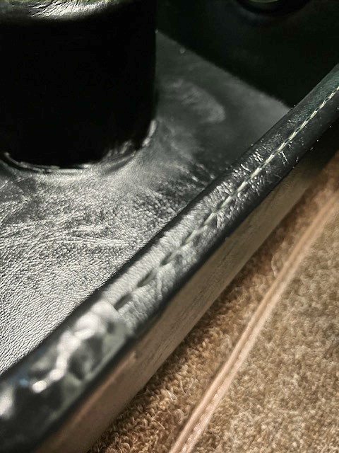

Pics always help. Here they are.
Original, but judges keep nicking me several tenths of a point for this patch job and the heat-sealed seams.

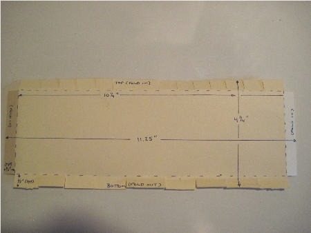

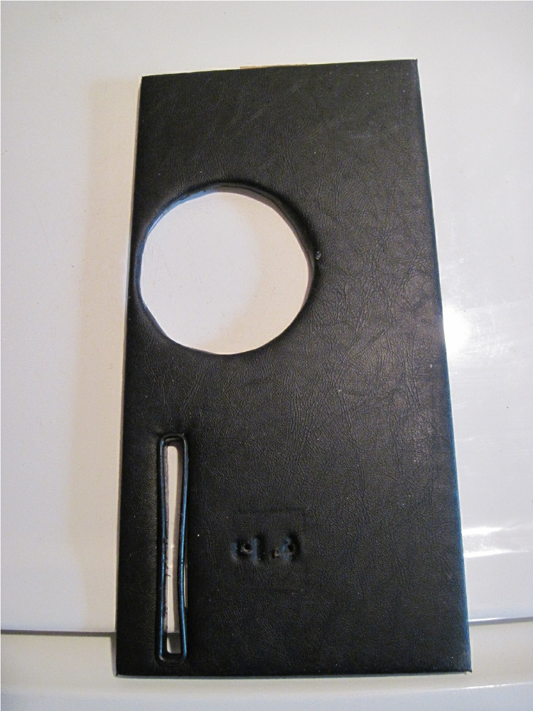

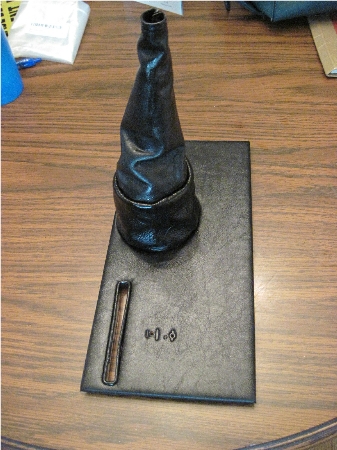

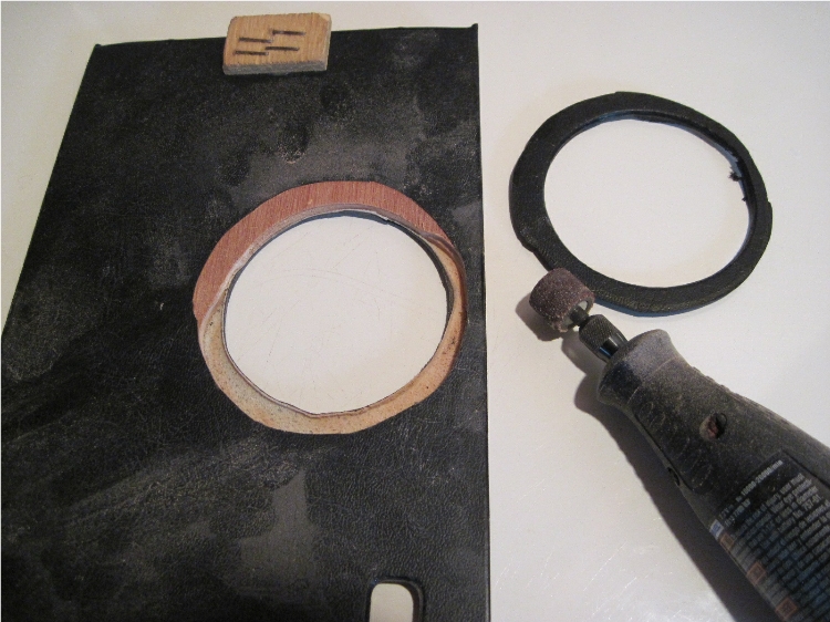

@Montreal914

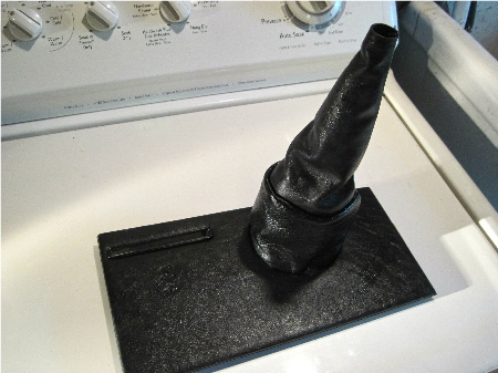

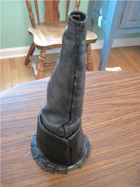

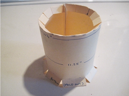

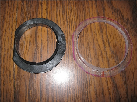

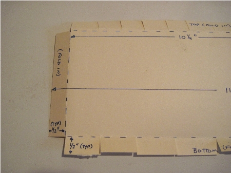

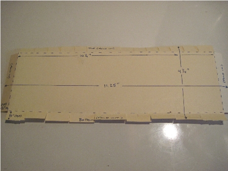

Sure! Got some "nice" leatherette on eBay, made a template for a tower base, shaved the ring thingie under the boot, shaved the bottom panel opening to fit the larger tower diameter, and stitched the original boot to the riser (that was the hardest part). JWest shifter, but same for Rennshift I'd imagine.
Here are pics:
post May 19 2025, 02:00 PM
Posts: 1,823
Nice!!! (IMG:style_emoticons/default/smilie_pokal.gif)
Thank you for sharing. Actually makes that tower stealth and skinnier.
BTW, Rennshift is the product name for JWest Engineering’s shifter. (IMG:style_emoticons/default/biggrin.gif)
