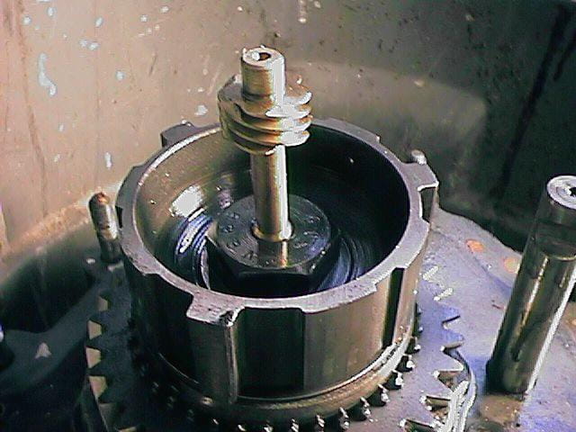

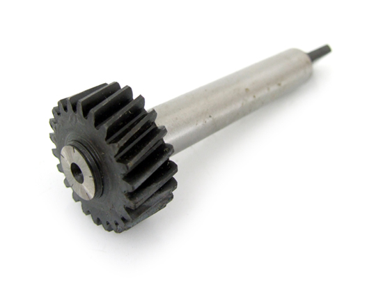

With what I read, sounds like the angle drive , speedo and cable work.
There are a couple more pieces you may need to look at if indeed the angle drive is working..

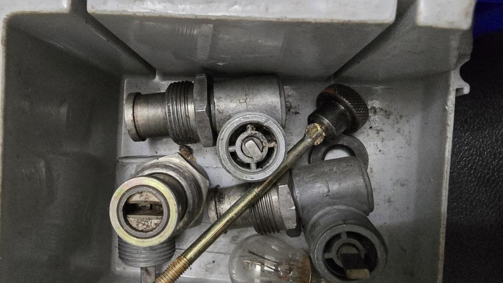

I have never seen either of the drive geras go bad. I have heard the Dansk replacement angle drives are junk. I have three original used ones for $75 each shipped. Call AA but I doubt you will get your money back. Really want to try another one of the same that failed. I would not get either of the ones shown on Thesamba ad. The brass bushing shown on one is 911 and will not work on a 914. I dont know if the drive is 911 or 914. Remove the angle drive and turn the drivr with a screw driver and the other end should turn.
If the other end does not turn it is bad
