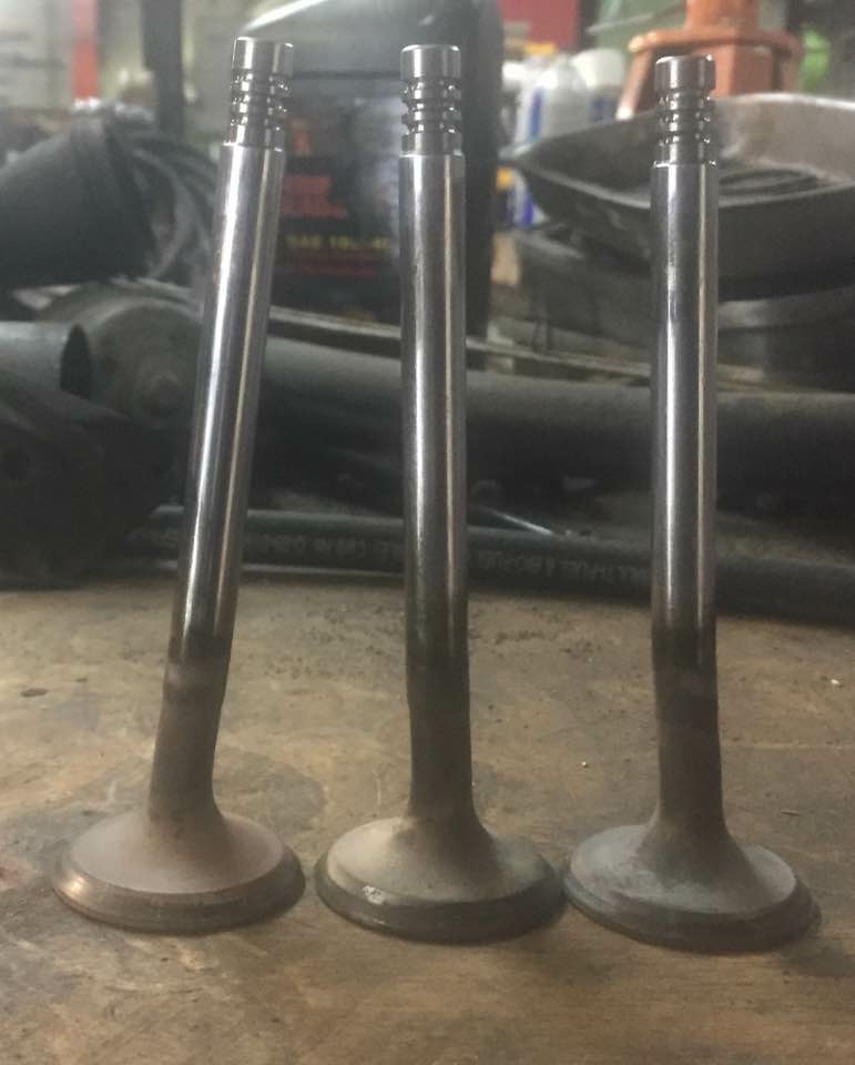

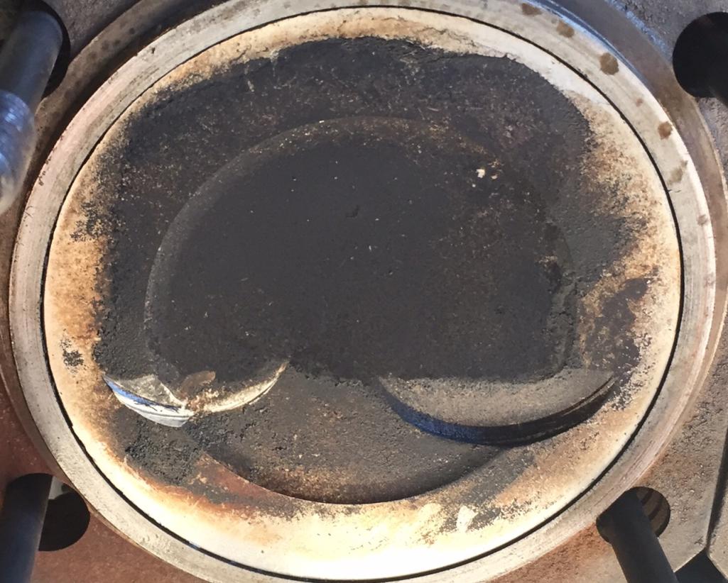

QUOTE(JamesM @ Jul 13 2025, 11:03 AM) *
Now that you have the valves adjusted back to speck, leakdown to see if one bent.
That's where I'd go. I "money shifted" the 2L racer engine at Lime Rock a few years ago and that was the culprit. I'm thinking it hit around 10k. It was bad enough to where the engine would not even start, not enough compression...
I don't know if that was a factor in the crankshaft failure a couple years later...
