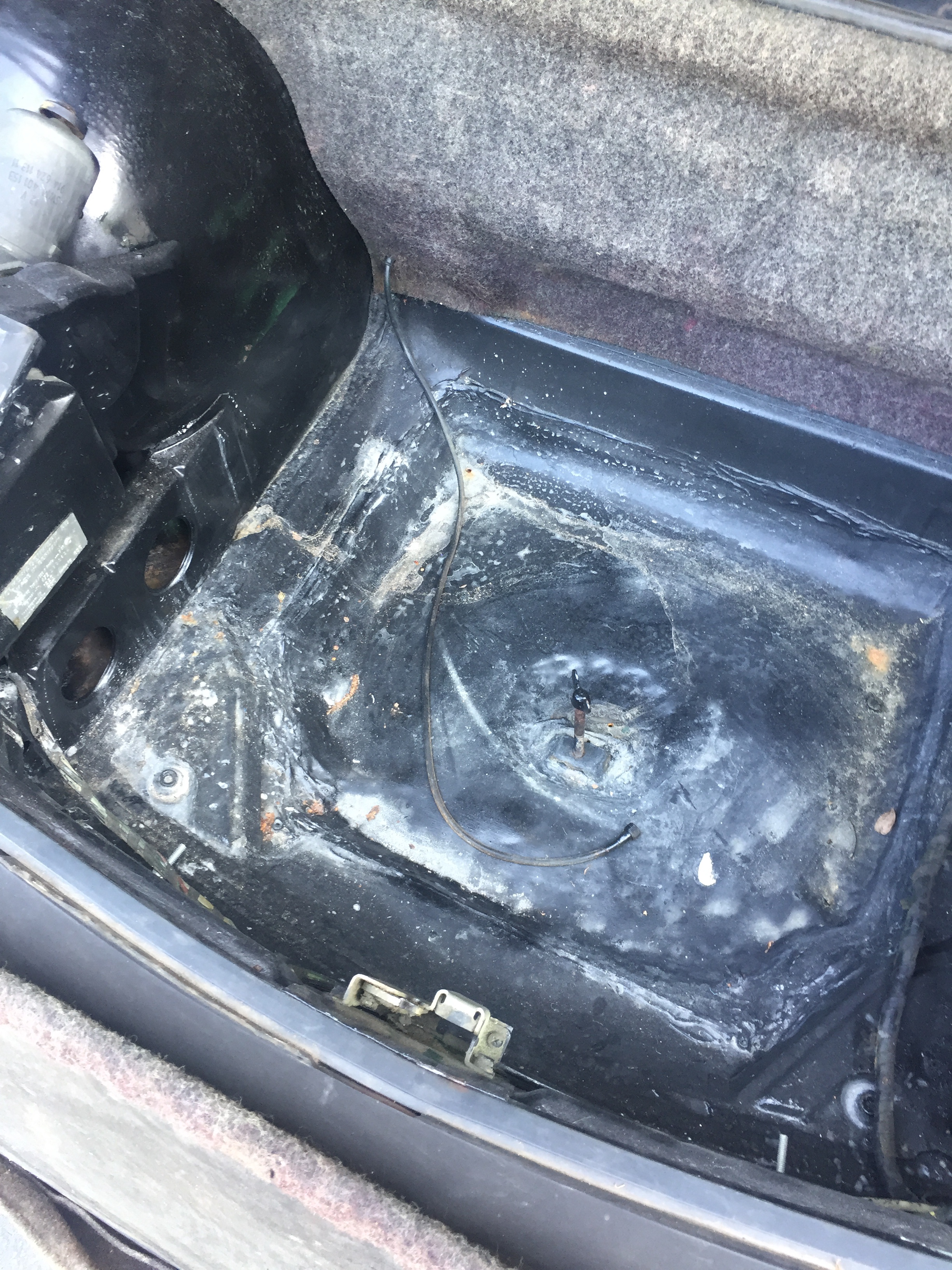

This looks like a good starting point and if the car is running, $3k is definitely a good deal. That being said, it will require a more thorough investigation to assess its condition. If your friend you've known for 20 years is offering it to you and you are serious about it, you should buy it and take him for a spin once in a while. Win-win. (IMG:style_emoticons/default/driving.gif)

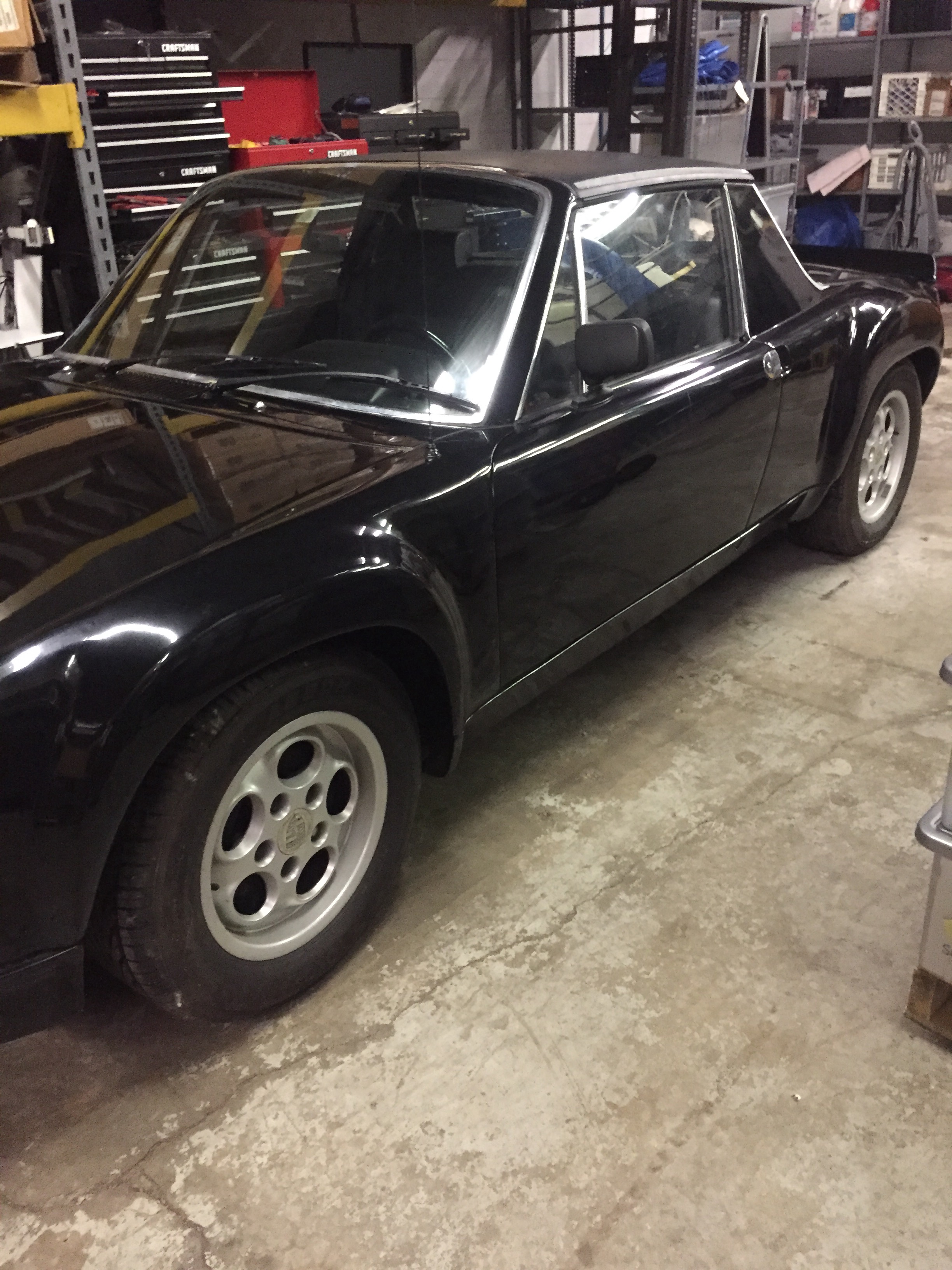

Front end doesn't seem to show previous crumbled impact. What are the flares material steel or fiberglass? Original color seems to be Zambezi green.

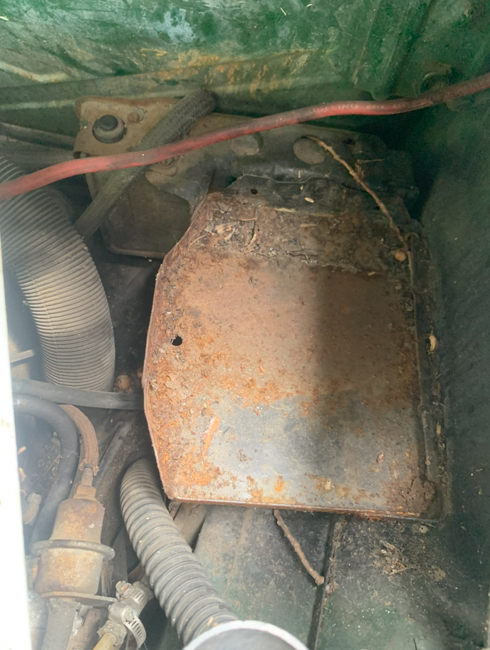

You will want to further check that under battery tray area (hell hole) but clearly you are aware of it since you have an initial picture of it. Having been store inside for many years was probably a good help!
You will also want to pull the rocker panels off to see if the jack point are in good shape. Be careful not to snap the screws on the underside of the rockers.

BTW, I like the look of the phone dials with the flares. Somewhat less racy, more classy with the black.

(IMG:style_emoticons/default/agree.gif) until you know the actual condition of the car, you have no idea of value. Find someone who knows how to assess the condition of the body. Pics won’t do it until you know where to look.

Pull the rockers on any 914 before purchasing
Rust will add 10k to the repairs
And traditionally previous owners are often not aware or even choose to be not aware of rust

From the pics it looks good but I would make sure you get into the longs. Without knowing what's hiding I think it's a good looking car, if the longs are in rough shape it's only worth as much as you are willing to put into it.
I suspect the engine is going to need some TLC.just by the condition of the hoses. As long as stuff like the mps is still good, none of that should be too expensive. It's the body work....
And yeah, see if one of us are in your area and we could help. Dr914 also has a helpful video up on YouTube.

I agree with having a thorough pre-purchase inspection performed of the typical rust spots including the longs, the hell hole, the corners of the cowl adjacent to the upper corners of the front hood, the rear trunk floor and the headlight buckets. If those check out fairly well, $3K is a great price. Especially considering the fender flares, 5-lug conversion, sound dash cover and chrome bumpers that appear to be in good condition.
