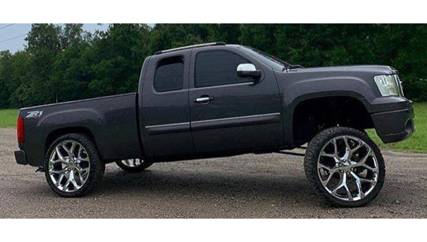

Front looks right, back is jacked. Generally if you follow the line at the bottom of the doors and fenders to the wheels, they will bisect the center of the wheels. I believe that is approximately stock height. Front is correct, back is too low for some reason. Needs eyes on to figure out what is going on.
Is that the Carolina squat on a pick up truck?

That poor 914 looks like it's trying to do the Carolina squat. Haha
