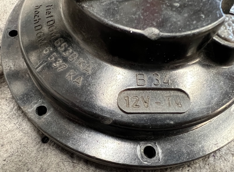

Can someone offer clarification on the frequency markings? I have been through several threads, but am not clear on how to distinguish. Does it literally have "335" or "400" on it?
The back of my horns don't have that. This one I believe is an early horn since it has bolts instead of rivets. Best I can surmise, the "T4" is the indicator? Its mate would be "H3"? Can anyone confirm or clarify? Maybe this is not a correct horn?
ALL MARKINGS molded into rear
tiet DCM 6536 KA
Hoch DGM 6537 KA
B34
12V-T4 (think this is low)
(Hella) Made in Germany
4
(A) 71300/1
G1
AGREE TP AR
614/615/
