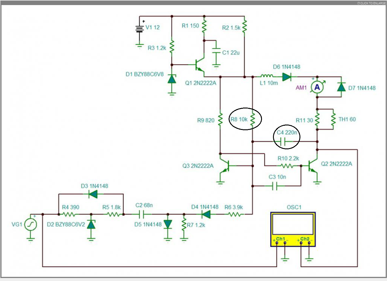

Guys,
I have a beautiful 1974 (yes, I have had this for 50 years) 10K VDO tach installed in my 1974 914-4. I have 123Tune distributor and all works well except the tach reads @2/3 speed.
I have tried the Ashlock Tech. Tach-Adapt that is sold by 123Tune and it does not work with the 10K. When I hook up the 10k to the Tach-Adapt it is totally dead. I am using all the same tach wires as the original 914 tach uses.
Interestingly, the Tach-Adapt does work with the original 1974 914-4 tach. I can alter the speeds shown on the 914 tach with a flick of a micro switch inside the Tach-Adapt.
To further the confusion, when I hook up the 10K VDO tach without the Tach-Adapt, it works fine at 2/3 speed as you would expect. I am using the same wires on the harness as the 914 tach uses.
Now, I am electronically challenged, but I have soldering skills. I also have access to an electronics lab here at work. I do not have access to any technicians as we have shut down that part of our EV business. The lab has hundreds and hundreds of diodes, resistors, connectors, wire of all sizes, flavors and colors and of course all the analyzing equipment.
My question for the smart guys out there is: Is it a matter of changing a diode, resistor, capacitor or other and to what value or color stripes. If I had this info and knew where to remove and replace the parts, I could do this and not give $400 to Hollywood or other gage repairers.
Below is a schematic of a 73ish 911 tachometer which, one would think would be very similar to the 10K (with different lighting of course). Frankly, this is all I have to go on and it could be a foolish assumption. I have read that I need to change Resistor R8 and Capacitor C4 to make this 6 cyl tach work on a 4 cyl engine, but unfortunately values were not specified.
Is there an EE or other smart experienced person out there that can help me?
Thanks in advance,
Paul VDL
