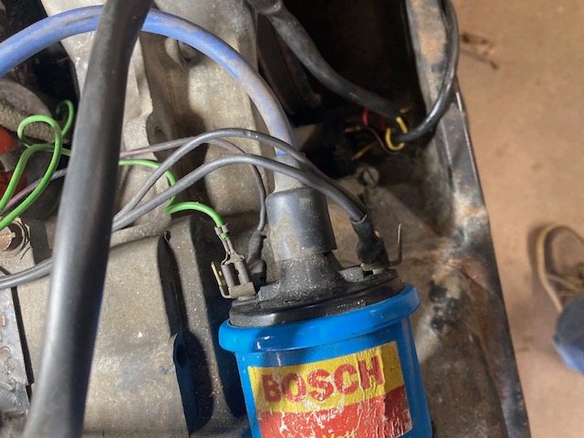

heya, Im responding after who knows how long cause of school and other things. Yea I wouldn't mind a pic of mainly the harness that goes to the ignition coil. Im trying to wire up the engine bay since i put the motor back in, and it seems like there was a crackhead before me that flipped everything on its head and nothing is in place..
Ignition coil is the last thing before vacuum hoses.
