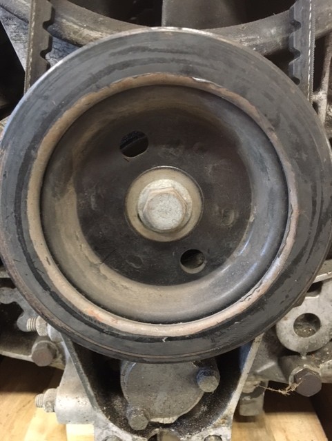

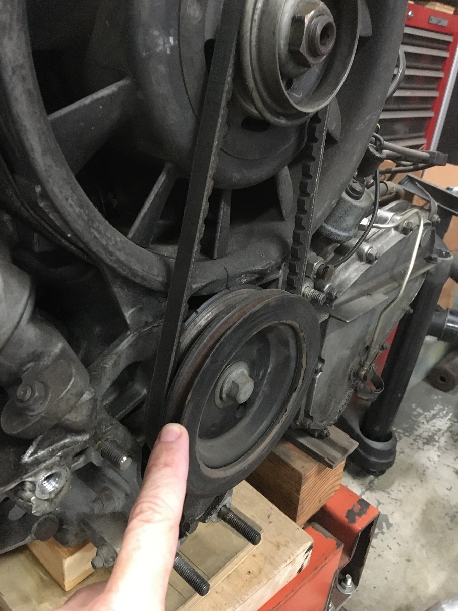

I would like to get rid of this double pulley on the crank of my 86 3.2 engine and replace it with a single pulley like the early engines.
Which year or engine single pulley would be compatible (same diameter) as a replacement? Would it have the same timing marks?
Or, have people drilled the spot welds to get rid of the A/C pulley? (IMG:style_emoticons/default/confused24.gif)

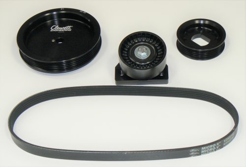

I'm changing the V-belt and dual pulley like yours on my '86 930 to a Clewett serpentine flat belt like modern vehicles. Thus getting rid of the ridiculous belt adjustment via shims.

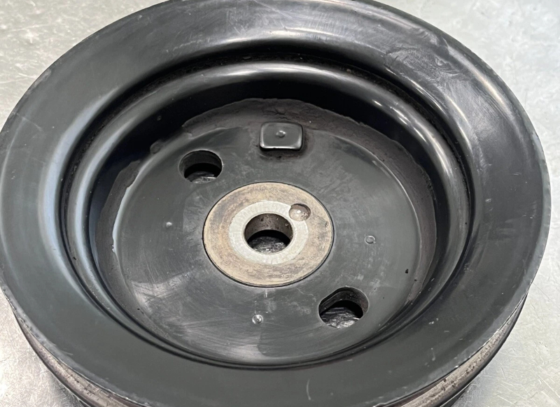

74-89 crank pulley will work TDC and 120 deg. marks correct..
I have cut the ac pulley off in a lathe, Drilling spot welds works too.
some 3.2 double pulleys have a balance weight spot welded on .. I think cutting off the AC negates the need for the balance weight....are least close enough for street.

They have a version with the stock ratio.
3.2-3.3 Serpentine fan belt conversion 1984-89 - Stock Ratio
I bought the version with the crank trigger as I'm getting rid of the distributor and going coil on plug.

Yes, people do remove the dual pulley on a 3.2, either with a single pulley or modifying the stock one. A lathe makes it easy. One advantage is you don't need to use the expensive and harder to find Carrera engine mount.
The Clewett pulley system does specify a Carrera mount so I'm guessing it's pully system is slightly wider than a single oem pulley.
I don't know if the Clewett pulley fits in with the Maddog mount. It probably does but I haven't checked. Removing the a/c portion of the Carrera pulley or housing the correct earlier pulley is really the best and most cost effective way to insure it will fit perfectly for your six conversion.

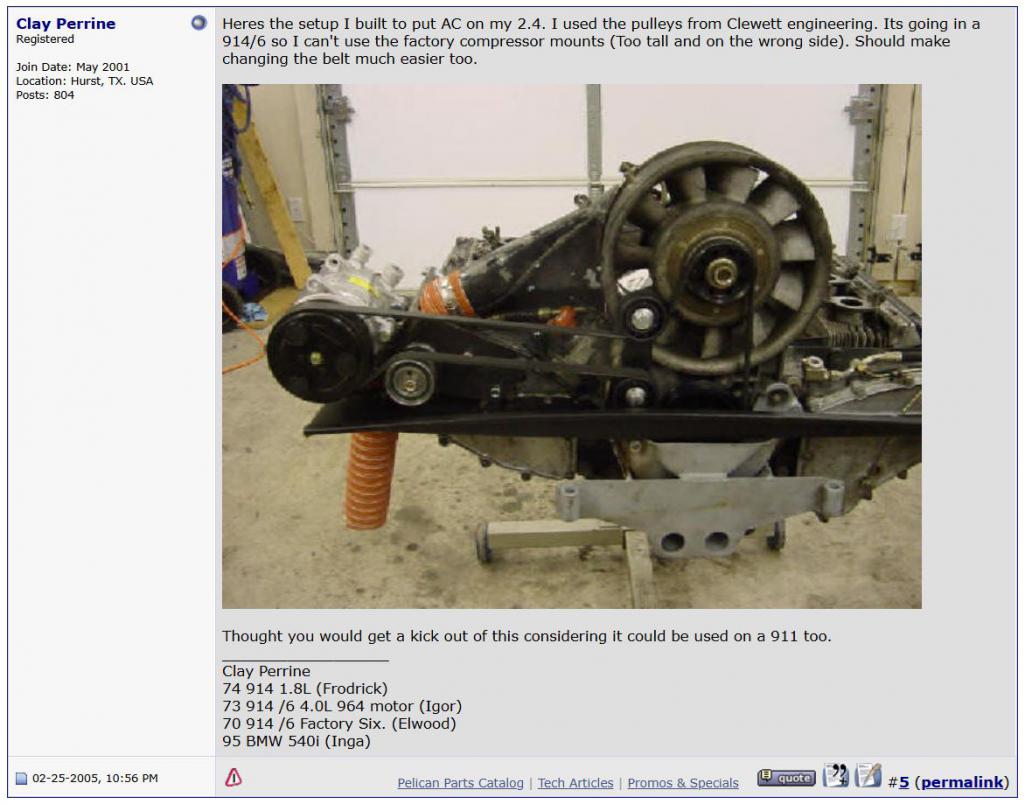

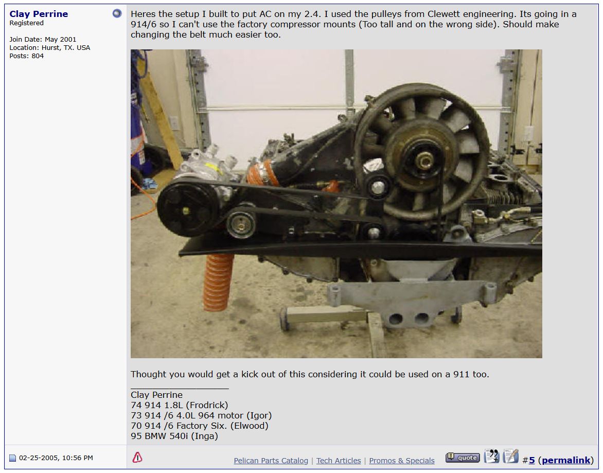

Looks like @ClayPerrine used a Clewett setup as a foundation to an A/C integration and was using a Maddogs (or similar design) dual support like I plan on using. Here's his post I found on the Pelican forum.
Clay, is the first pulley above the crank one the regular Clewitt tensioner? Do you remember having fitment issues with the engine mount? I know it's already been 20+years, but if you have any recollections, I would appreciate. (IMG:style_emoticons/default/beerchug.gif)

I built that using the Clewett pulleys on the crank and the fan. It worked fine, and the belt was easy to change. But the extra stress on the timing box cracked it and it started to leak oil. The tensioner I used was the timing belt tensioner for a Nissan 300ZX (engine number VG30). It is a simple eccentric idler. It was a very heavy setup, all made from plate steel.
Looking back at it, I don't see how to change it. The engine actually expands when it warms up, so you can't extend the front support to the engine mount. These days I would say get a high output alternator and run an electric AC compressor.
