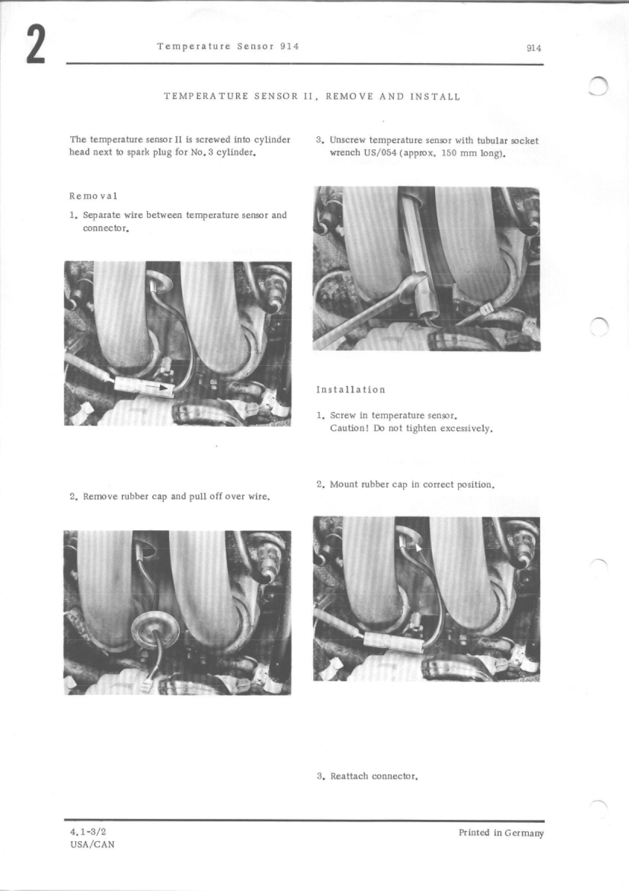

Thank you for the answers to my reques. Head temp sensor has been ordered. Should be here by Tuesday. Tried to find the right size socket. Not sure if it’s 17 mm. Can you tell me what size I should be looking at?
sdthomas
post Oct 12 2025, 09:56 PM
Posts: 65
Joined: 14-June 11
From: Seattle
Member No.: 13,193
13 mm deep socket. Just removed mine today.
This thread might help.

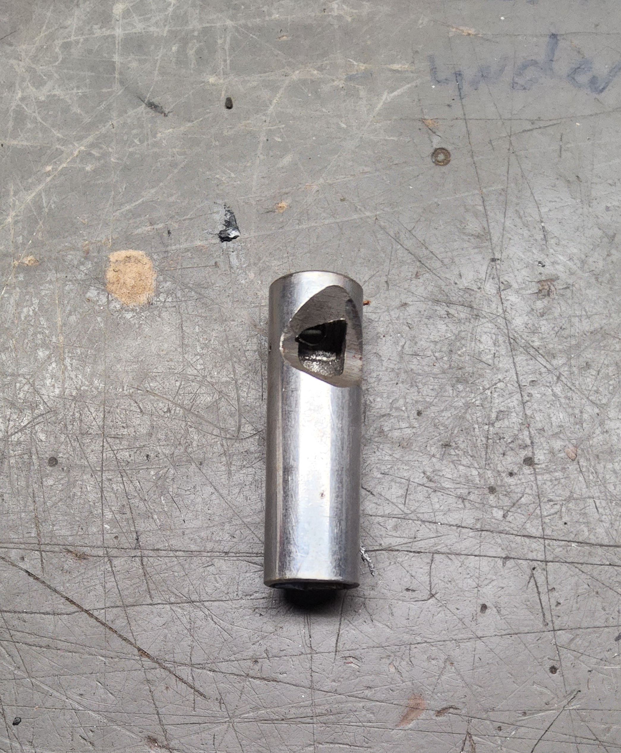

Another way to make a tool is to grind one corner of a 3 inch cheap extension
Pass the wire through the 13mm socket and through the ground corner of the extension
