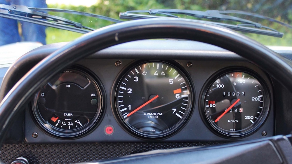

for fun - here is the instrument binnacle on the marchart car.
with the EGR light mockup - adhesive sticker (IMG:style_emoticons/default/biggrin.gif) .
indication car is pretty original i would say - virtually untouched from its time with marchart and his work at porsche as an engineer. marchart was of course one of the prime managing engineers of the boxster (and as it turns out a big fan of the 914).
engine bay is schmick too - but not restored.
museum director sent me some shots of that for 1.8 research work.
