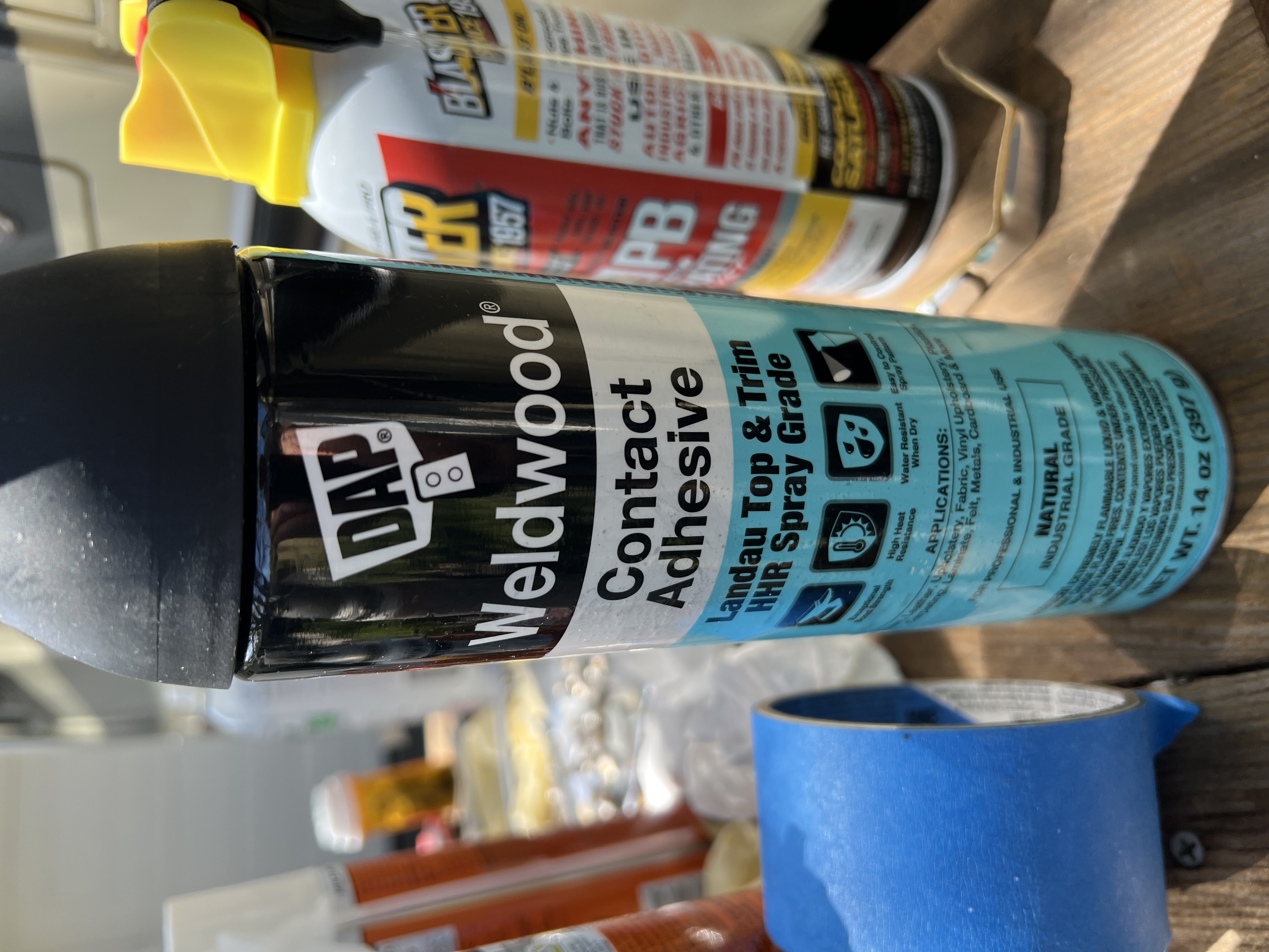

I learned of this stuff through ownership of a GMC Motorhome. It stands up to high temperatures seen inside MH interiors and sprays on with little overspray. Used it on my 914 targa vinyl with nice results.

Get the weldwood Landau, not the cheaper one. Cheaper weldwood works good at first, then gives out when the weather changes a couple times. Never again!
