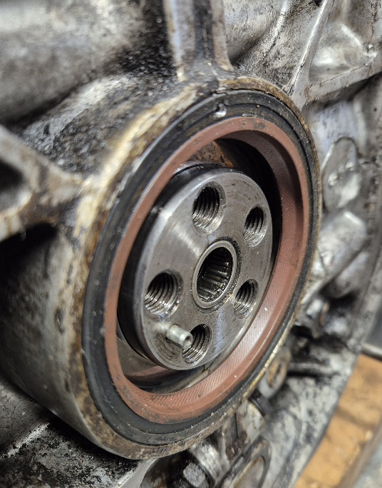

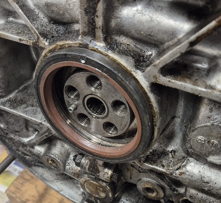

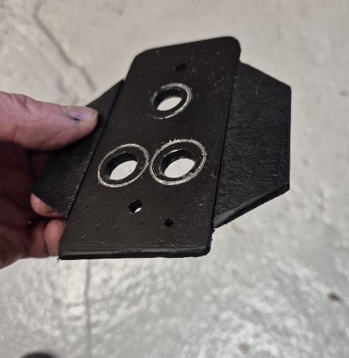

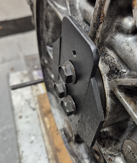

Well is this homegrown tool to easy or?
/Lars S
post Oct 13 2025, 04:56 AM
Posts: 4,290
looks like a winner to me

Very nice. Why is there a small hole in the seal, or is that an old seal for demo?

I use a stub axle and tap it in.
Stub axle is the same diameter as the seal

QUOTE(Geezer914 @ Oct 13 2025, 01:46 PM) *
Yes its my demo seal (IMG:style_emoticons/default/smile.gif) ....have put it in and out a few times just for testing, works great!
/Lars S

QUOTE(bdstone914 @ Oct 13 2025, 05:35 AM) *
Nice tip! Now I have some use for the stub axles I have sitting on the shelf.
At least on my VW engines that rear main seal needs to go in just a bit further than flush. The last time I used my Empi seal installer on it the seal ended up leaking as it just pushes it in flush. If I remember correctly there is a slight chamfer that the seal needs to go to the inner edge of. Haven't done one on any of my 914s so that may not be applicable here.
