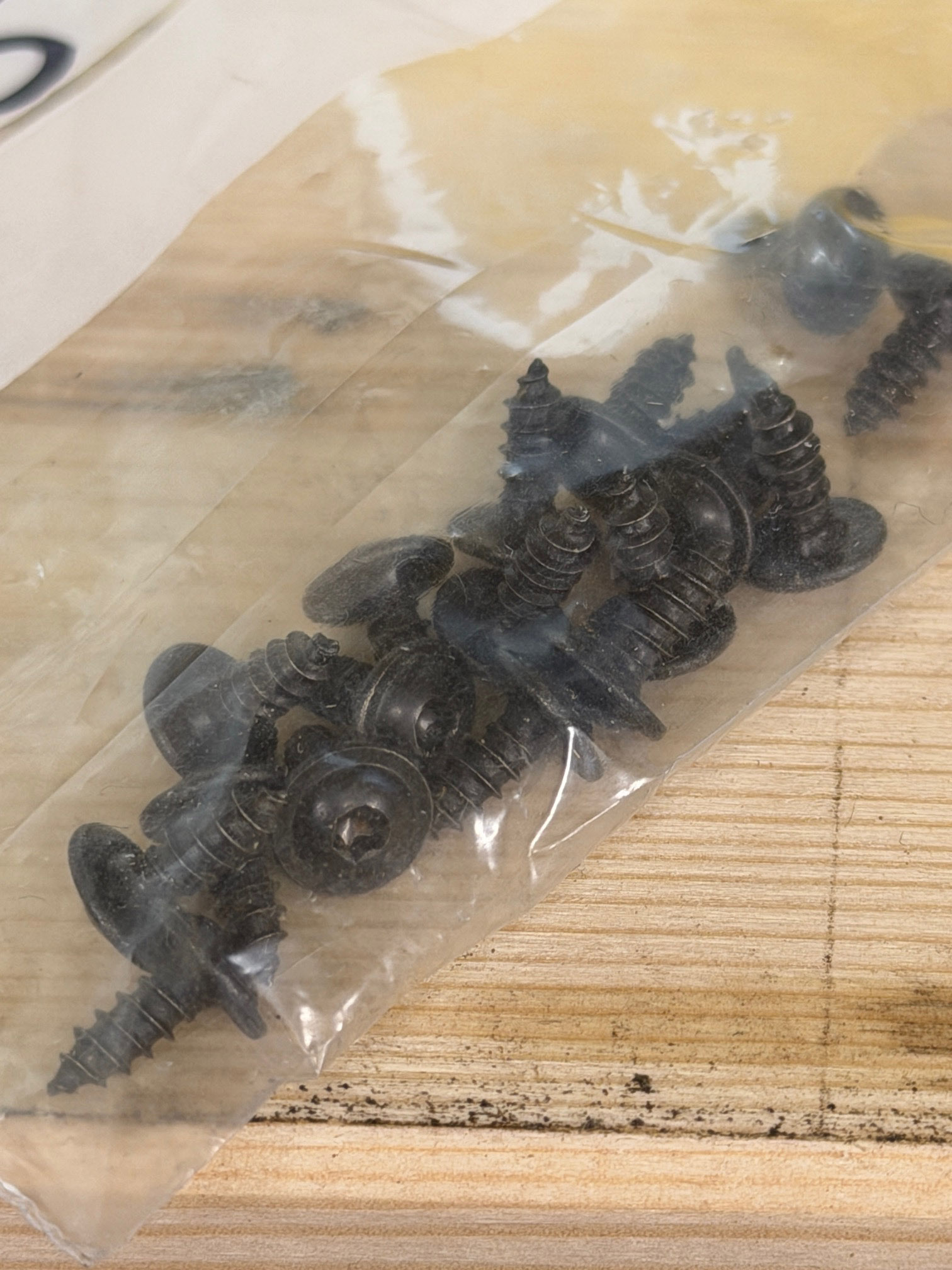

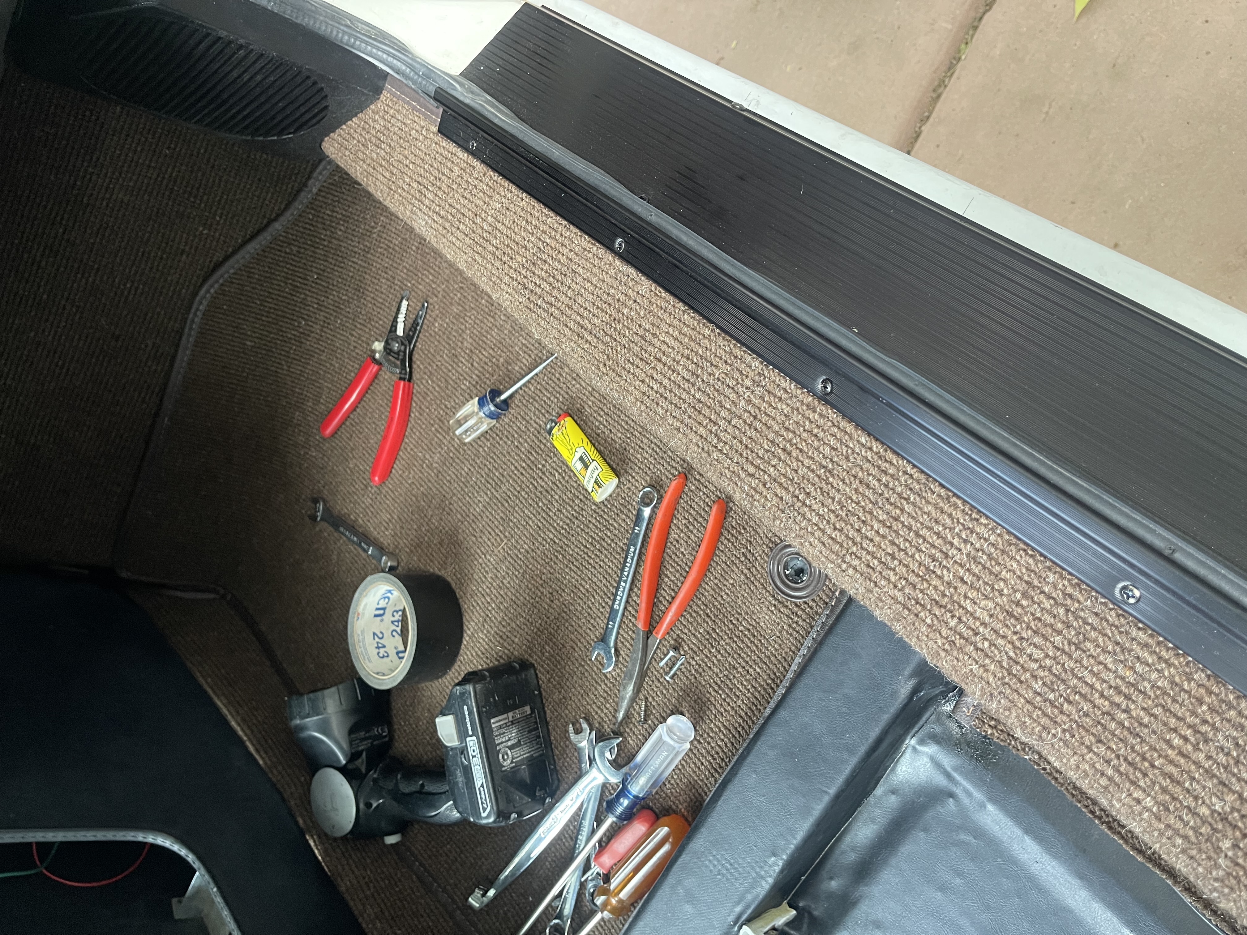

Black screws easy on and off ( stupid little plastic rivets are for people with little fingers)Attached Image

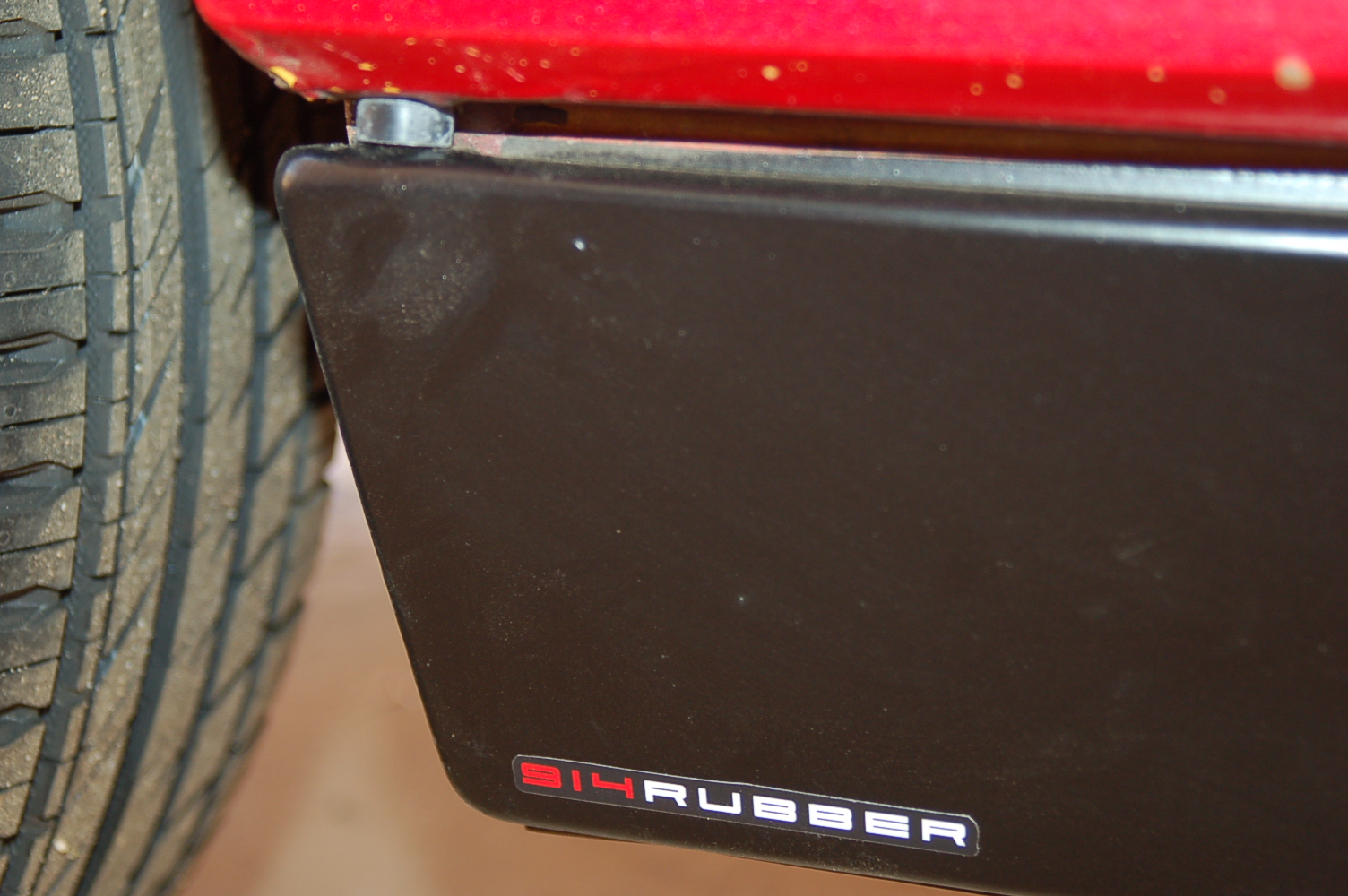

Member No.: 43
914 Rubber has the plastic Rivets

QUOTE(Front yard mechanic @ Oct 17 2025, 05:22 AM) *
Those take screws. He is talking about the rocker panels not the carpet strips

QUOTE(bdstone914 @ Oct 17 2025, 08:19 AM) *
I used black screws in both places, worked fine and I prefer this solution for ease of R/R - but not before messing around with the infuriating little nylon rivets. (IMG:style_emoticons/default/headbang.gif)
