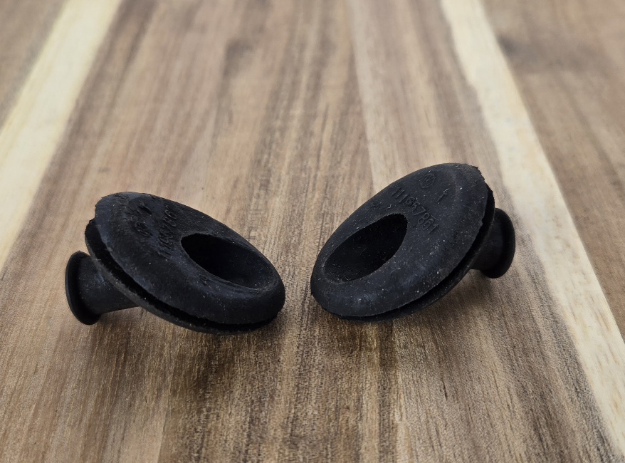

I have this one.

My 1970 914-6 uses two individual front bulkhead grommets for the fuel lines under the gas tank. The double hole grommet is too large to fit.

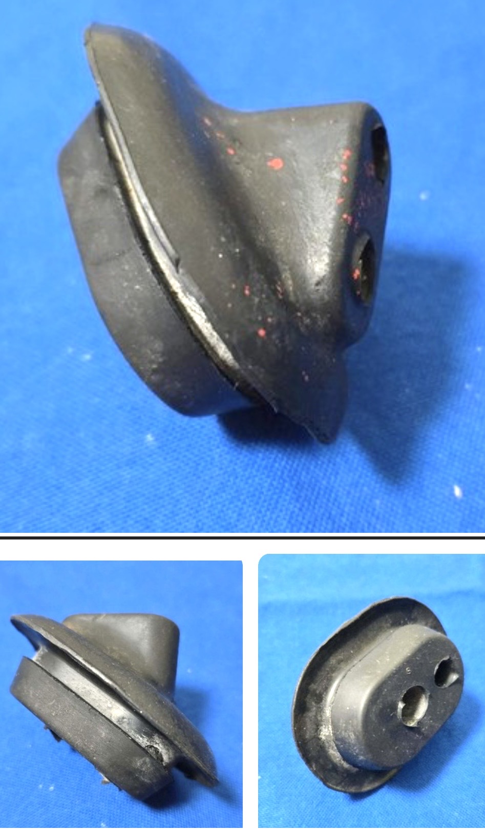

very early cars (70 ?) used a couple of simple line grommets but did switch to the 2 hole grommet pictured through 74?
Last a updated 3 hole vers was installed in late 75-76 cars
The 2 hole vers presumably has asymmetric sized holes to fit the metal tips on the lines.
The late version has 2 symmetrical line holes + the 3rd is a small one for the charcoal evap system that was now the tunnel.

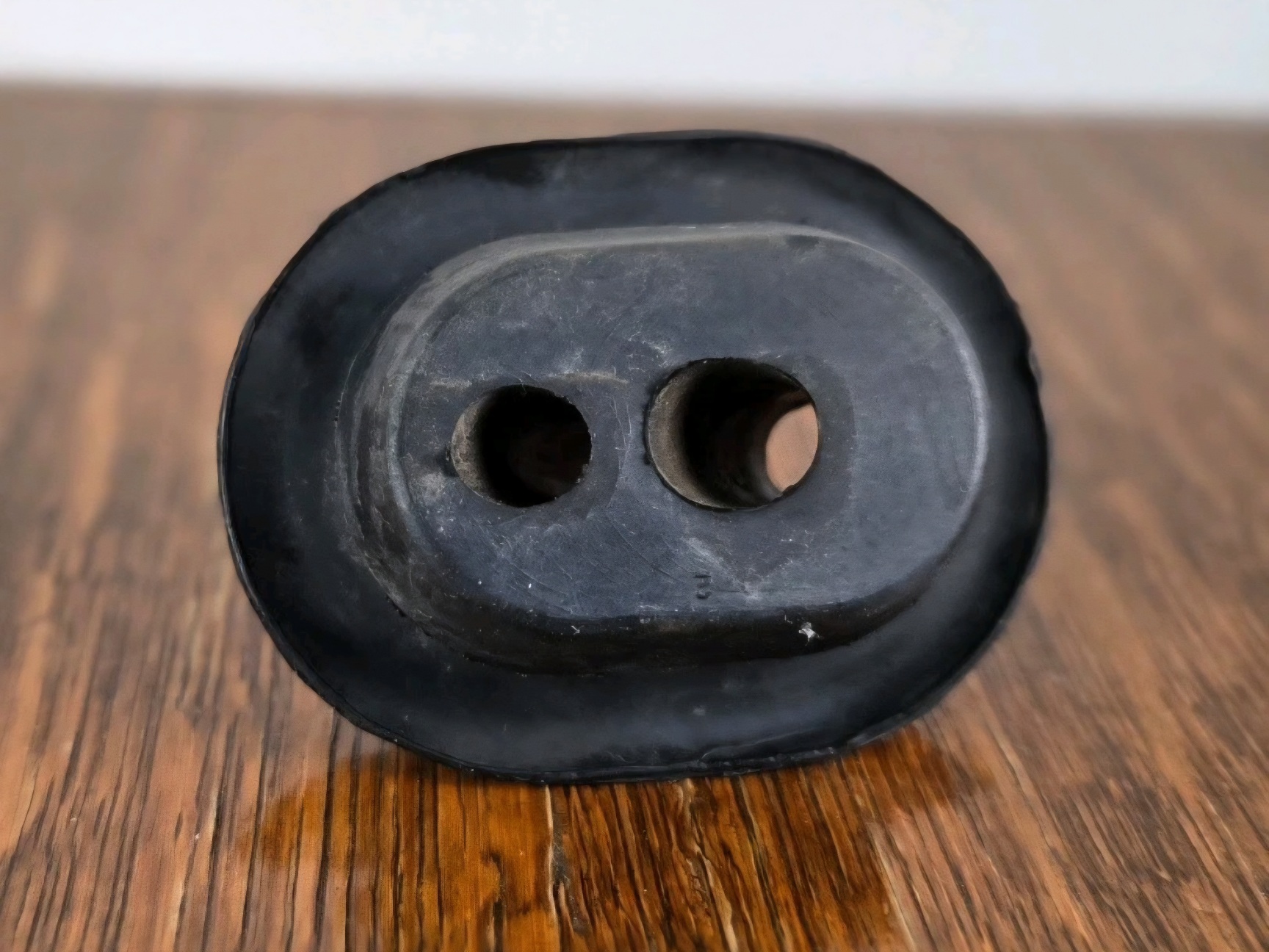

These are the ones you need for under the tank. Pulled from a early 70 chassis. Not dry rotted.
Message me if interested

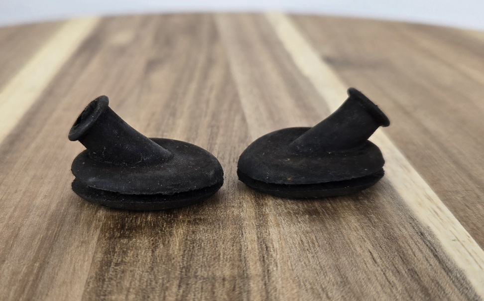

They are the same part number as VW Bug speedometer cable grommets that go under the front fender. They are readily available from most VW parts suppliers, and I believe from 914 Rubber.

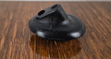

They are available new from Porsche for about $10 each and Uro parts.
Probably available from VW too.

From VW shops they're about $3.00 each, or less.

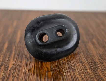

https://www2.cip1.com/c16-111-861/ $2.34 each
