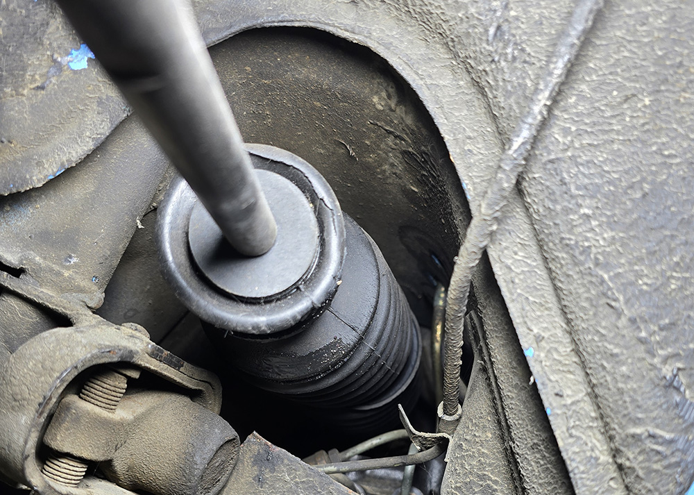

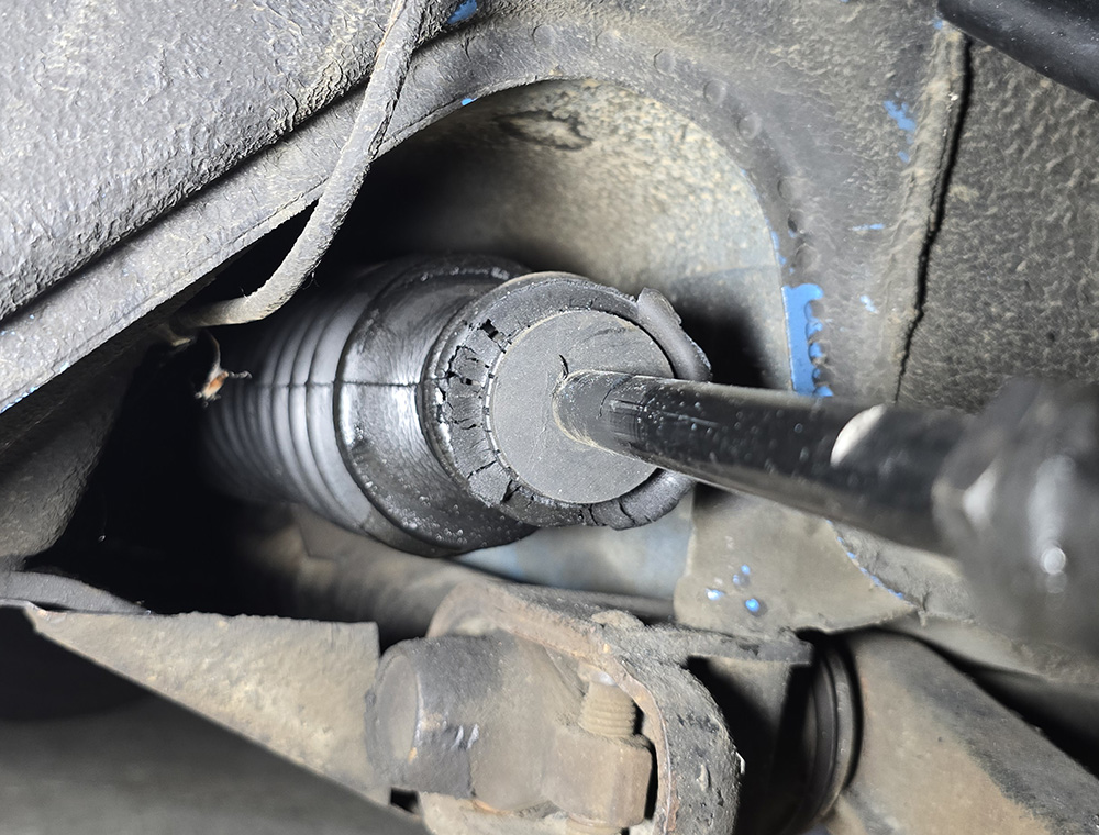

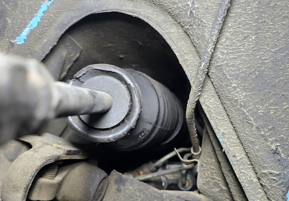

I was working on the ole 914 this weekend, getting ready for the front sway bar install, and found the boots on my steering rack were smoked. I went to order new boots and the standard boots on the websites didn't look like what was on my car.
I think the car already has Turbo Tie Rods on it. I wanted to put this out to you guys to see what you guys think. Are these Turbo Tie Rods?
Thanks!

Yes. Those are turbos.

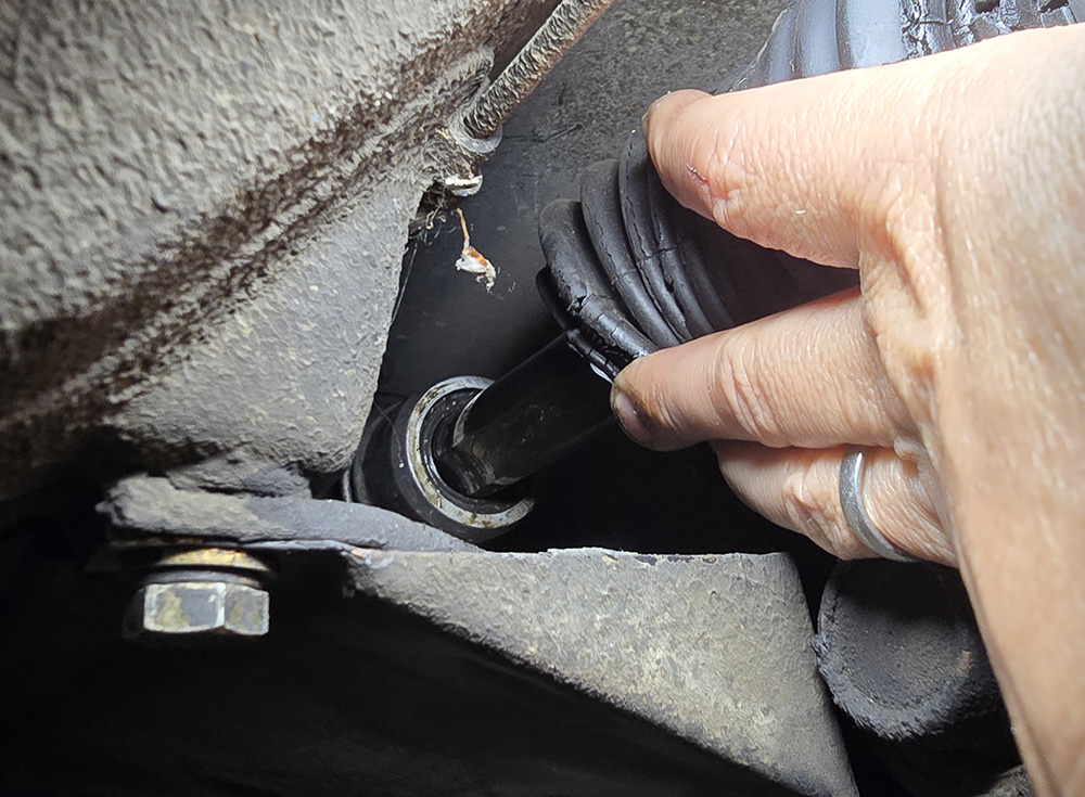

Excellent! I thought so. Does anyone know if I can replace the boots without having to have the car realigned? I feel like I can pop the tie rod off and unscrew the whole arm from the rack without adjusting the length. Am I dreaming?

Yes that should work.
