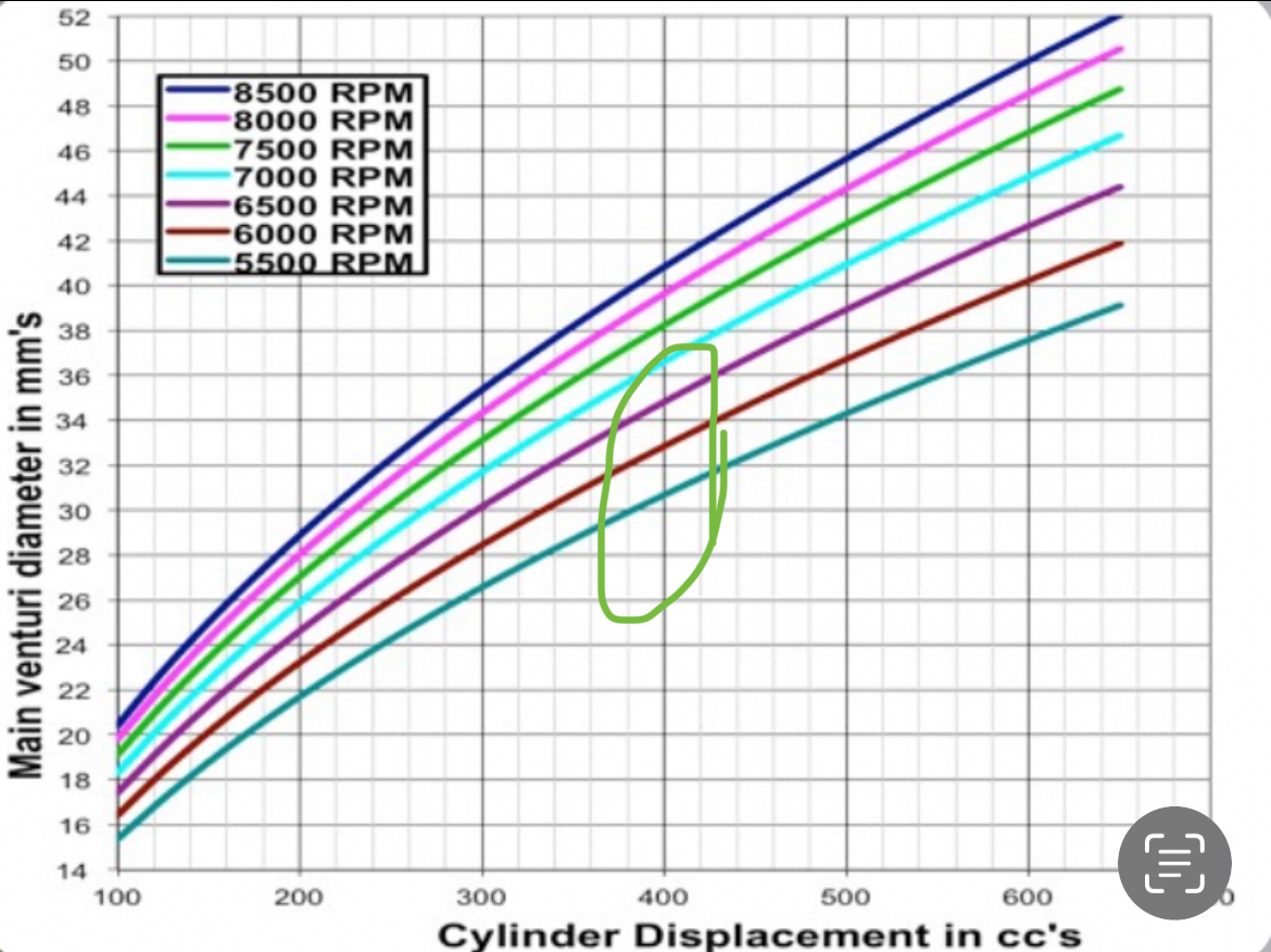

The chart below is for Horsepower not drivability. Usually 4-6mm smaller than this chart recommends for good vacuum signal, air velocity, and driveability. You give up a tiny bit in the top end but unless you’re on track - you’re not running at redline for any significant part of a drive.
The TiN were for 2.2L and they come with 27.5mm Venturis. So are we to believe that Porsche didn’t know how to tune? By the time you get to 32mm you’ll start trading throttle response for top end gains. Attached Image
For a 2.4L you’re going to be about 30mm which will probably work a little better with the MFI cams (assuming that’s what’s still in it).

Thanks for all of the responses.
Not looking to over do it here, just get enough flow to better match the larger displacement. She is to lean know and I'm running out of mixture adjustment.
I do not know what cams the engine has.
Very helpful chart, appreciate you posting that.

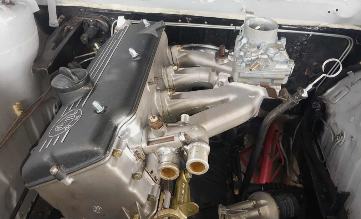

This engine & carb (internet photo not from my car) but same setup.
Was a good intro to bigger carburetors not always better. Luckily I had some guidance on that from some of the diesel power generation mechanics and a guy with a 911 that took me under his wing.
