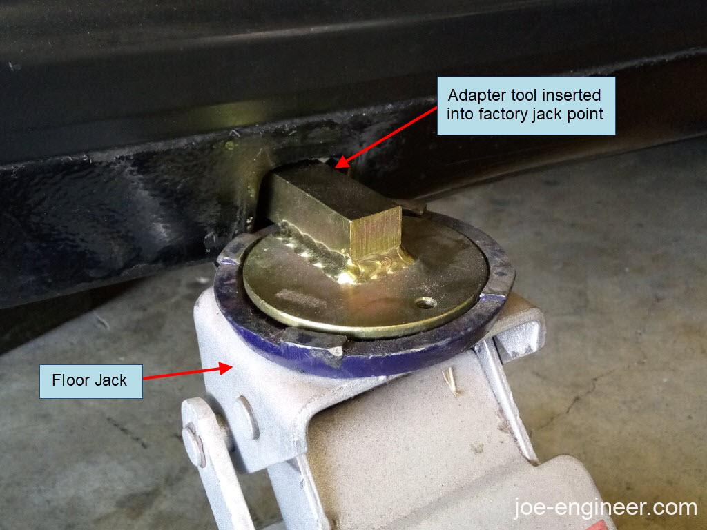

Those "donuts" are not designed to jack up your 914. They will bend/deform.
Use a jack plate inserted into the jack point Porsche designed for jacking up your 914.

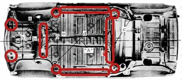

Here is a diagram showing where you can place stands. Although it shows the "donuts" in the diagram, those are not good/safe locations for jacking up your 914. You decide where its safe and less prone to damage your 914.
When we don't jack up the 914 using the jacking point, we use a 4x4 (maybe it's 6x6?) piece of hardwood that goes almost the entire width of the car and is placed under the firewall when jacking up the rear and under the area behind the front cross member when jacking up the front. Since we use a 4 post lift and two tall stands, it is very quick. One stand on each side of the 4x4 and then lower the lift and lock the safety catches and we're ready to work.

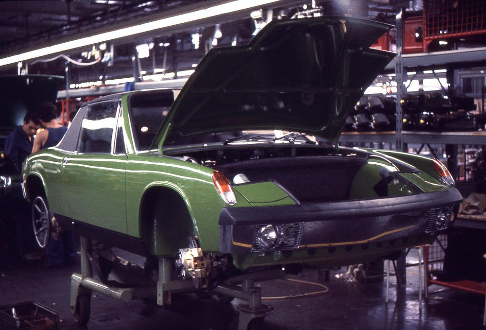

I am with you on this but apparently the donuts were for attachment during construction and were all joined to a single jig so no one donut ever held the weight alone. I can see that, but just try and stop me from using them as jack points...

The donuts fit the pins on the car carrier that moved the cars down the line during construction. It’s not very heavy duty metal and they tend to bend easily. There are stronger points on the car that work better for raising the car.

Now, if you had some kind of a jig to raise the car by all 4 "donuts" at the same time like the factory assembly line, maybe it's OK. But, if you jack the car up by just one, they can and do bend. With enough experience with 914s, you must have seen it before, right?
Either way, using the jacking point with a jack or a jacking plate is how Porsche envisioned owners to jack up their 914s.
