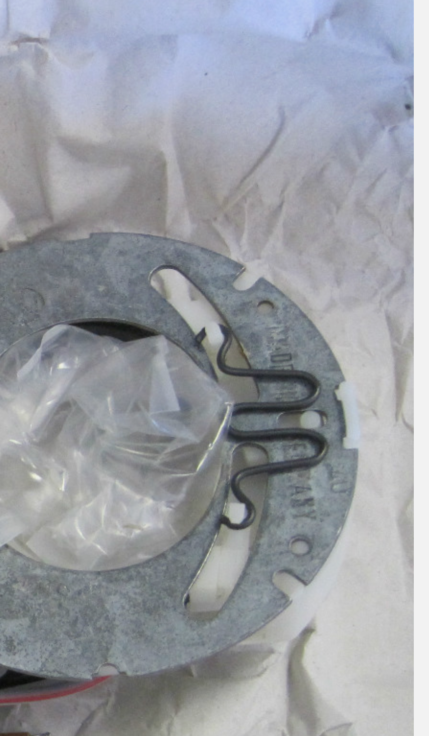

Make sure these pieces are in place in the switch. Plastic pins break and spring falls out.

I have fixed this a few times in my '74, the 70 seems to have no trouble.
With the 74 I replaced the entire turn signal assembly for another problem and then this occurred as a result. seems that the entire operation is dependent on a variety of systems to be lubed and also aligned........lovable analog car....... specifically the depth of the turn assembly when sitting in the hub is critical, in my 74 the NEW assembly was not quite built so that it sat firmly in the hub (these assemblies are made for a variety of cars, so they may be perfect in a beetle, or Ghia, etc.)
I may go back in there....may not.....
Also, there is a requirement for the wheel to turn more that 180 degrees for the auto-off to work, in NE most of the intersections are NOT 90 degrees.........
hhhmmmm....after this I am energized to get back in there and fix this!
