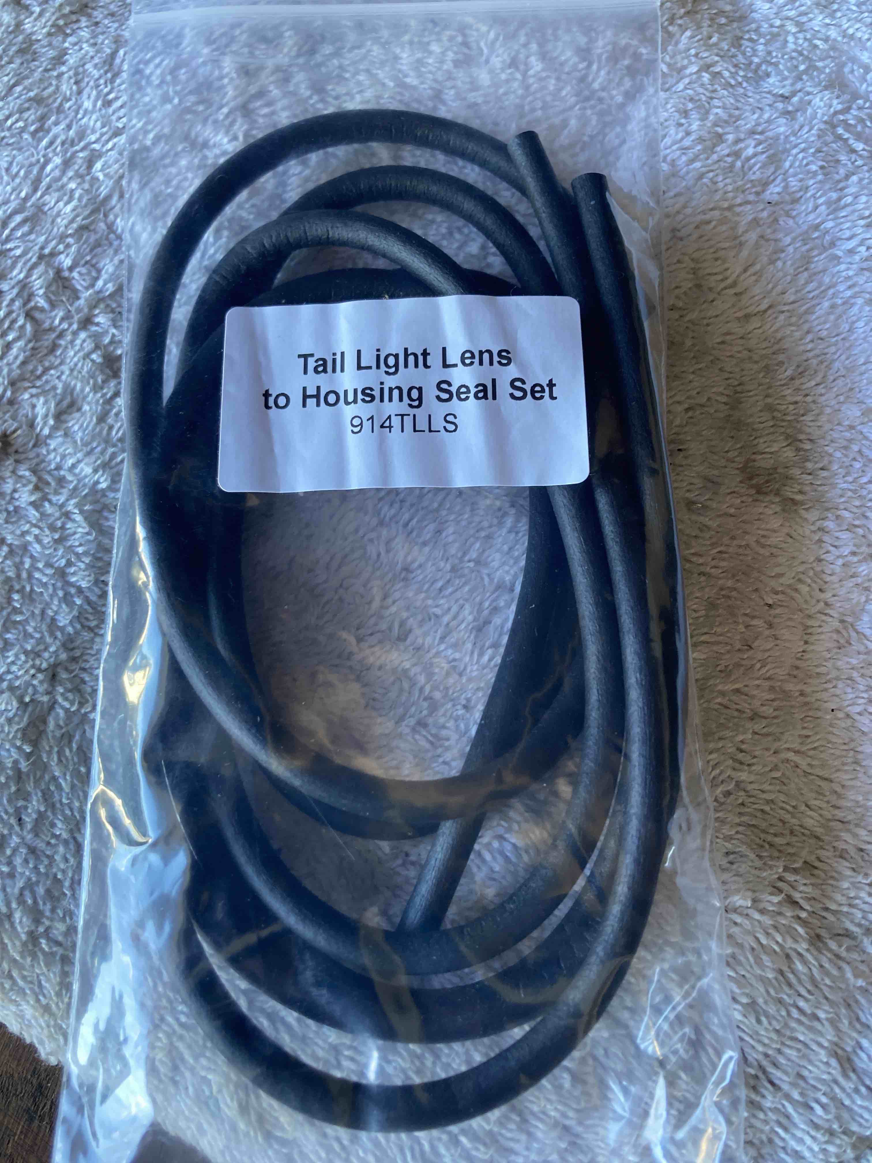

I purchased a set of led rear lights from Spoke and decided I should update the gaskets around the tail lights lens so I purchased this from 914 Rubber .These do not seem to match the gaskets I currently have on my car. Did I purchase the wrong seals?

i bought those last year, and they fit fine
don't forget the trunk seals as well!

Don't forget to put the seam on the bottom. If/when water gets in, gives a place to drain.

You can also just buy rubber/silicon cord from GraingerSupply.com It takes about 10 feet.
