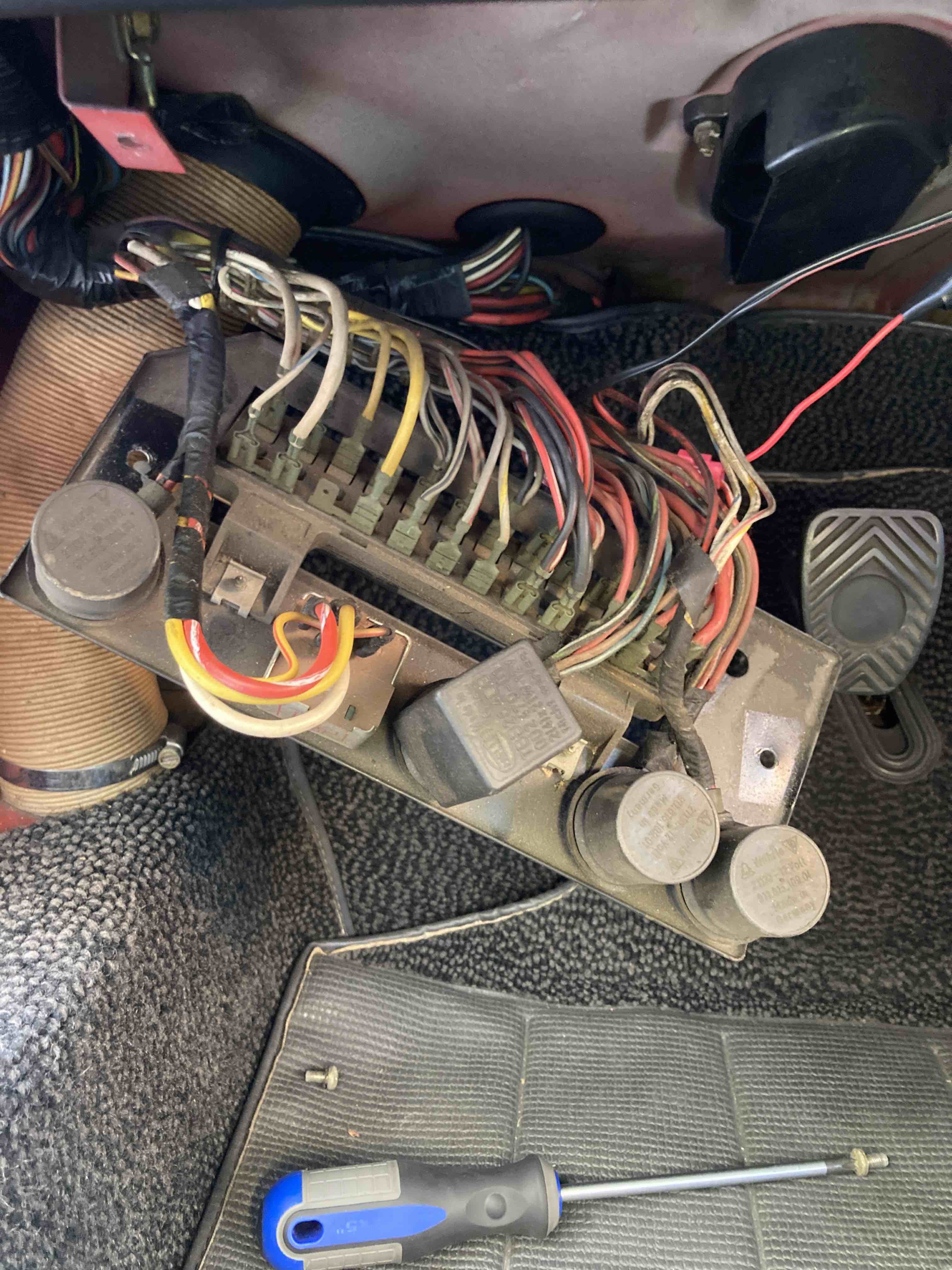

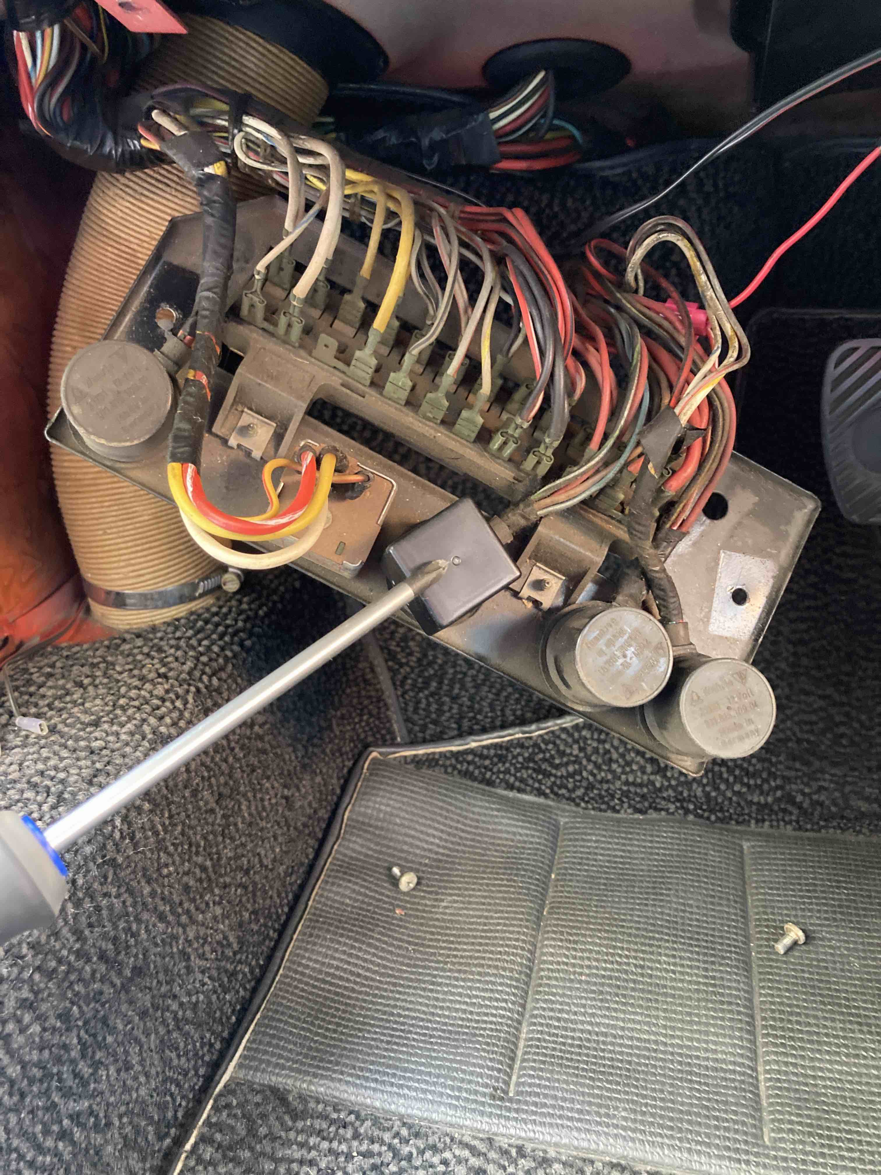

QUOTE(Ron914 @ Oct 22 2025, 11:31 AM) *
I looked under the dash and do not see where the flasher mounts .Do I need to remove a gauge to access where this installs ?
Nope, super easy, just remove the big screws from the fuse panel, the flashers are on the back.

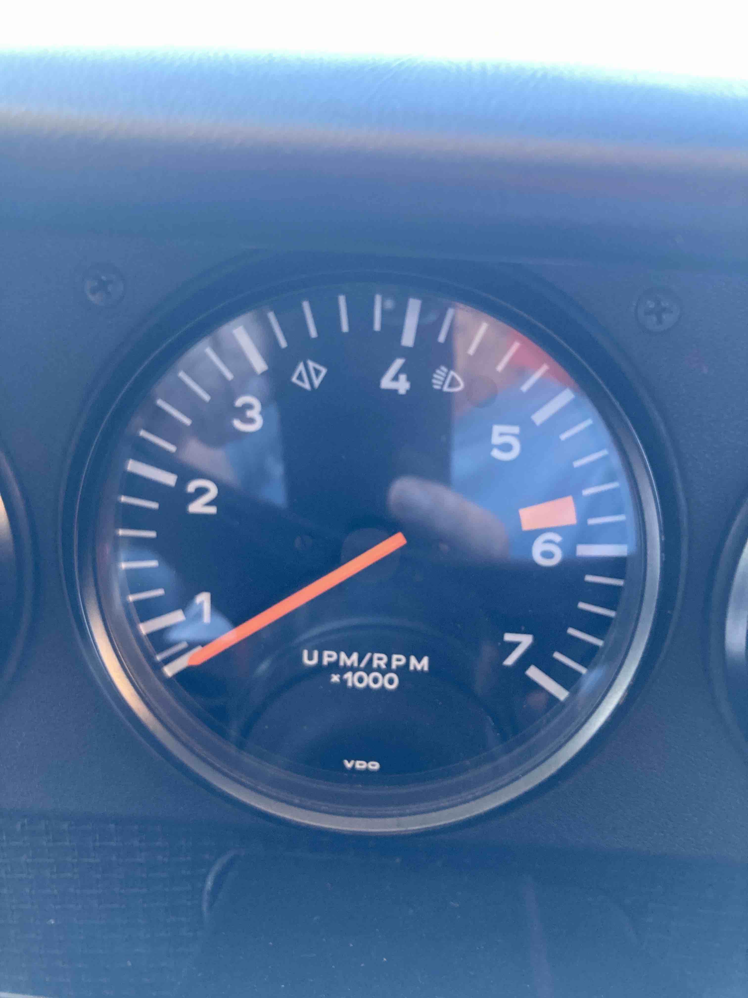

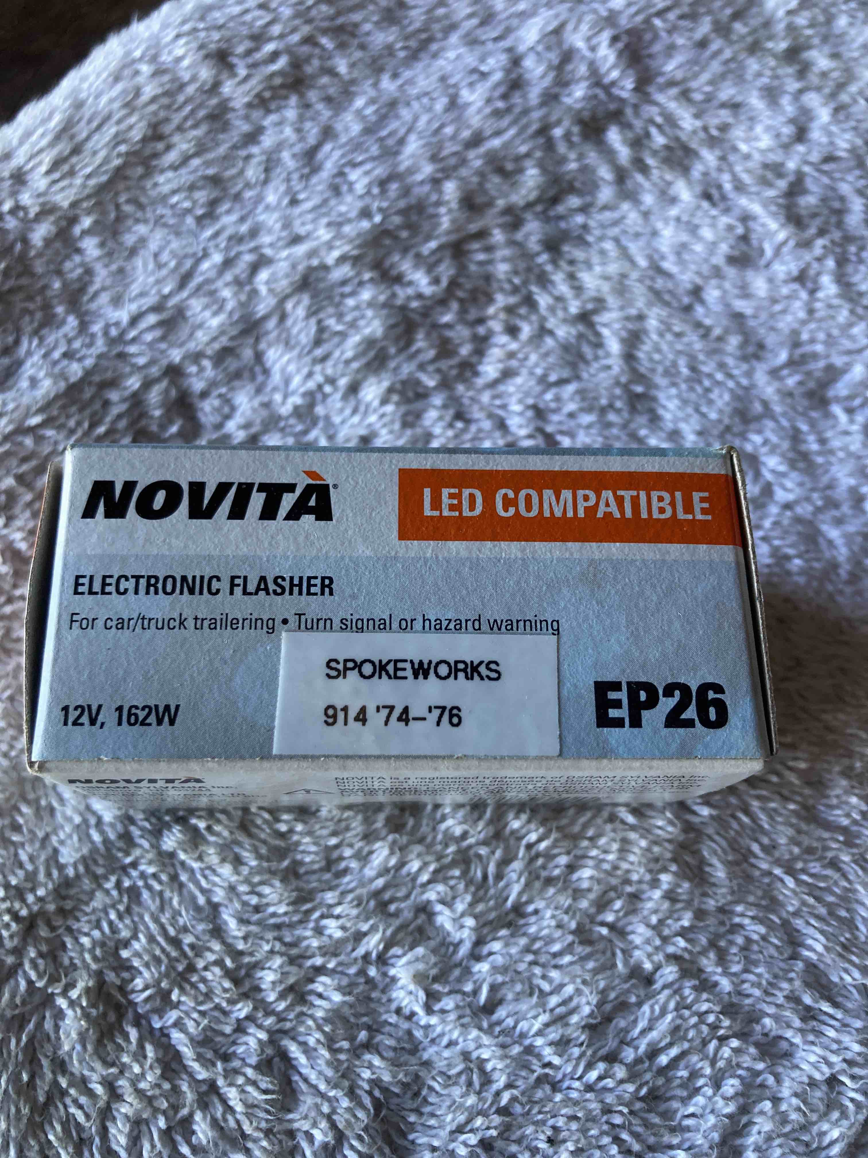

Thanks for your responses . I was told I would need the new Flasher for my 1976 but I will see if all works before I install it . I think it has something to do with my indicators in the tach ( I only have one light for both turn signals ).

Just did a quick test and the front and rear turn signals all blink but the indicator on the tach does not . I believe this is why the new flasher is needed .

Bummer that did not go well . Installed the new flasher heard a click noise when I activated the left turn signal and now no turn signals flash anymore . Took out the new flasher and put back the old one and my turn signals no longer come on when car is running . With the key off I can activate either left or right turn signals and the front turn signals light up and the rear turn signals come on (plus the brake lights ?)but no longer flash ? They blinked before I messed with the flasher relay but just did not have any indication at my tach indicator.
Rear brake light should not be coming on when the turn signals are activated . I have the modules that make both the turn and brake lights come on together but have not installed them yet. Also I have not touched any of the rear light connections . Wondering what went wrong I only installed the new flasher ,all lights worked as should after initial install ?
Ron, you are correct on the indicator not flashing with LEDs and the OEM flasher relay. This is a safety feature designed to let the driver know that an external turnsignal bulb is burned out. ie., the indicator does not light up.
LEDs look like a burned bulb drawing very little current. EP26 is configured to drive the indicator any time flashing occurs.
EP26 is LED-compatible and is OK with standard bulbs. Not sure why you had an issue with EP26. It should still be ok. I can send another replacement if you think this one is damaged. Weird because EP26 is pin-compatible with the OEM flasher and should behave the same.
