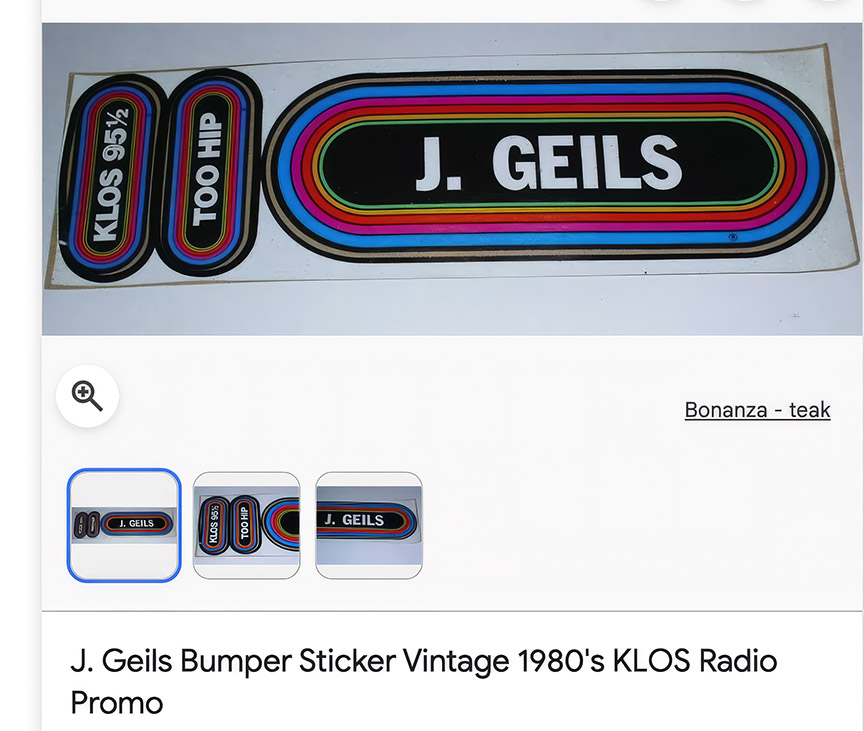

That J. Geils sticker must remain.
post Aug 23 2026, 02:34 PM
Posts: 4,074
QUOTE(FlacaProductions @ Aug 23 2026, 07:50 AM) *
KLOS was a station close to me growing up. Mark And Brian show was very funny.
Restore the car and the sticker. Sticker $29. on Ebay
