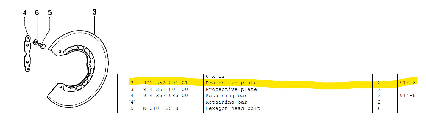

AFAICT, from the parts manual, there are two different parts listed for the /4 and the /6.
The /6 part having a 901 (Porsche) part number, and the /4 part having a 914 part number. I don't know what the physical difference is, or which ones are actually on my car. Note that the /6 rotors are 4mm larger in diameter then the /4 rotors - that might be part of the difference. Or maybe the cutouts for the calipers are different... No idea.
My backplates are painted in any case, but so are the calipers... which are /4 calipers being used with a /6 rotor.

What I learned I put in the post in the parts vault: 901.352.801.201, Protective Plate - Disc brake rear 914-6 . It appeared to me the -6 was ~308 mm.
I pulled that dust shield off our factory 914-6. That said, the car has some modifications so it's possible it was replaced at one time. I don't think so though. They fit the stock rotors quite well. They were very rough, so hard to tell what the original finish was.

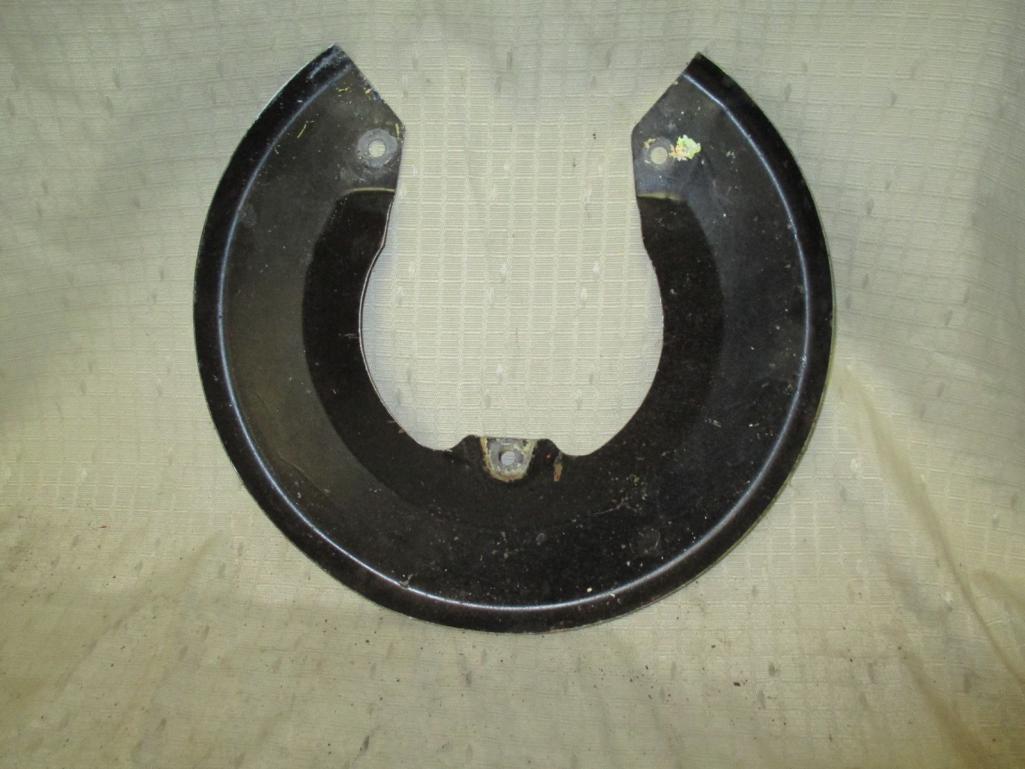

I do recall a thread where this was discussed in depth, and had photos. The six shield is larger, and the four shield will fit inside the six part with some clearance. I think there may have been other detail differences such as change in the radius of the lip bend.
post Nov 13 2025, 12:25 PM
Posts: 9,319
I am not going to say I am even remotely correct. The reason being that Karmann always had different suppliers through the production run. It has been well documented that different parts showed up in other coating configurations than Dave's picture shows it to be black.
