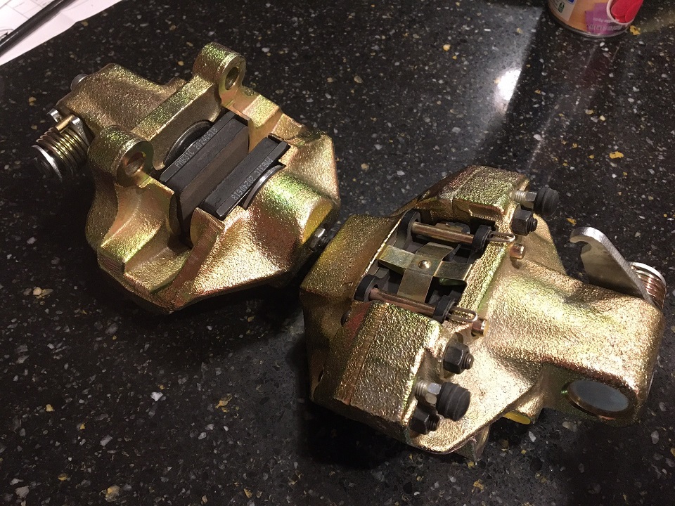

I got a set to try out.
post Dec 5 2025, 08:56 PM
Posts: 1,972
I must have lucked out as mine arrived fully dressed! (IMG:style_emoticons/default/smile.gif)
Ordered directly from PMB, $825 to my door.
EDIT: These are the non-vented ones.

I have these in my car but in stock 6 form, cant wait to drive and test it out!

The early 930's used a S caliper front and M caliper rear. These 914-6 rear calipers are basically an M caliper with a parking brake. The 930 weighed 2650lbs +++, compared to our light weight cars. Unlike the heavy turbo's, it should be near impossible to overheat our rear rotors, even when they are solid disks.
