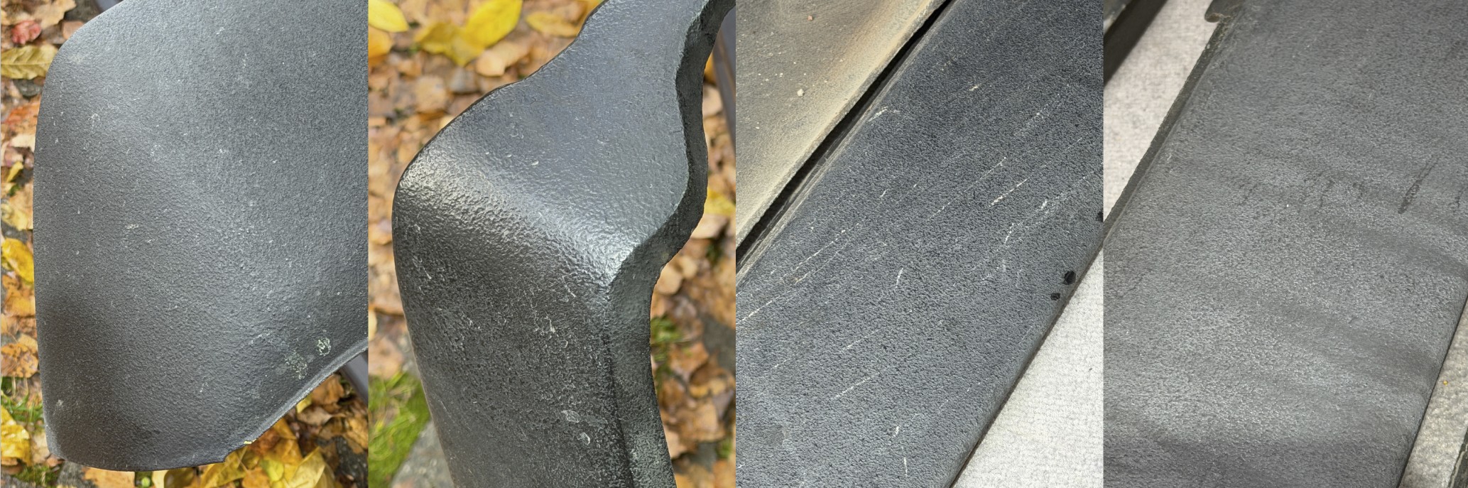

OK, thanks guys... Looks like a light "orange peel" style texture will be fine. Will talk to my paint guy about whether he wants to use an undercoat texture first, then overcoat.
Currently mine look like this (Front, Rear, Right, Left). Think they're somewhat too matte - possibly due to age.
"Original" is not really important, nice looking is...

pretty sure they shot them with schutz first then the black over that.
its satin black.
i believe it might have been the same with the bumpers.
how they got the orange peel? but its a differently scaled and textured orange peel on the bumpers.
i still have orig paint on mine. thats my reference.
looked at closely the rockers do not exactly match the valences in terms of orange peel texture. (IMG:style_emoticons/default/biggrin.gif) they probably got done in batches separately at different times. (IMG:style_emoticons/default/biggrin.gif)
stockpiled? and installed on cars.
