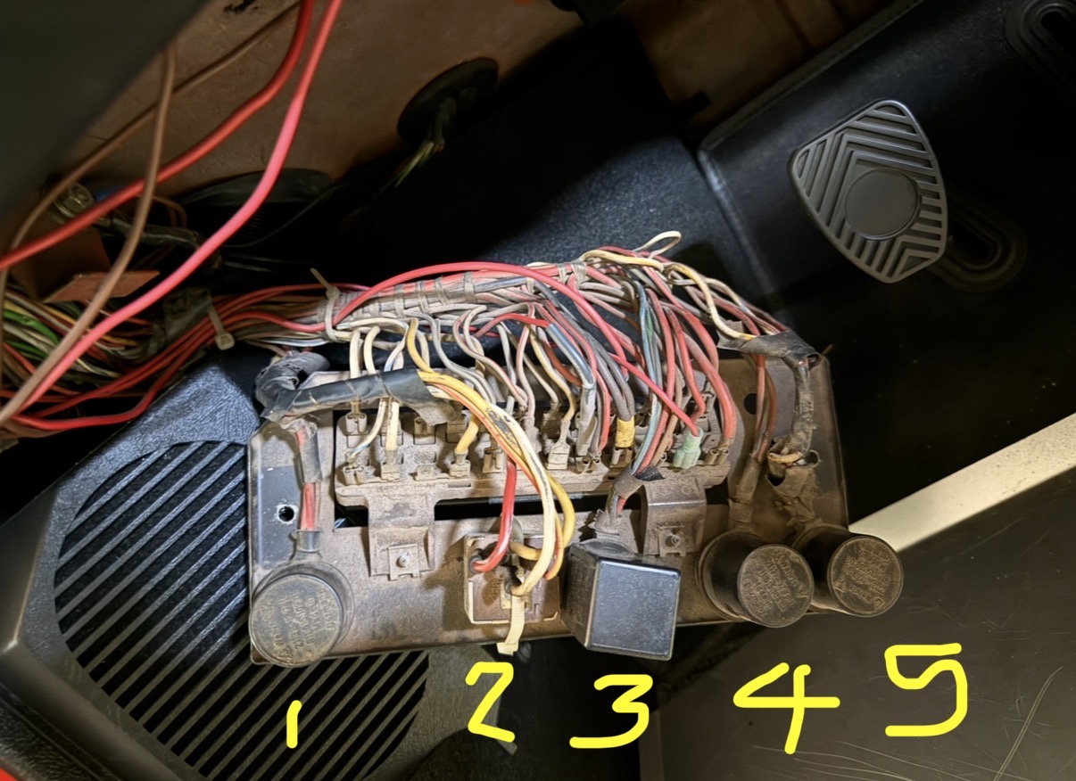

1974. Which one is the horn relay?
post Nov 17 2025, 02:14 PM
Posts: 11,458
post Nov 17 2025, 03:17 PM
Posts: 9,121
A round one with these wires going to it:
-Red
-Red/white
-Brown/white
-Black/yellow
Its J4 on the 1974 schematic here: https://bowlsby.net/914/WiringHarnesses/doc...4_MAIN_1974.pdf
NARP74
post Nov 17 2025, 05:29 PM
Posts: 1,440
Joined: 29-July 20
From: Colorado, USA, Earth
Member No.: 24,549
Like Jeff said, don't get too hung up on location, YMMV. Mine have been moved around over the year for some reason.
