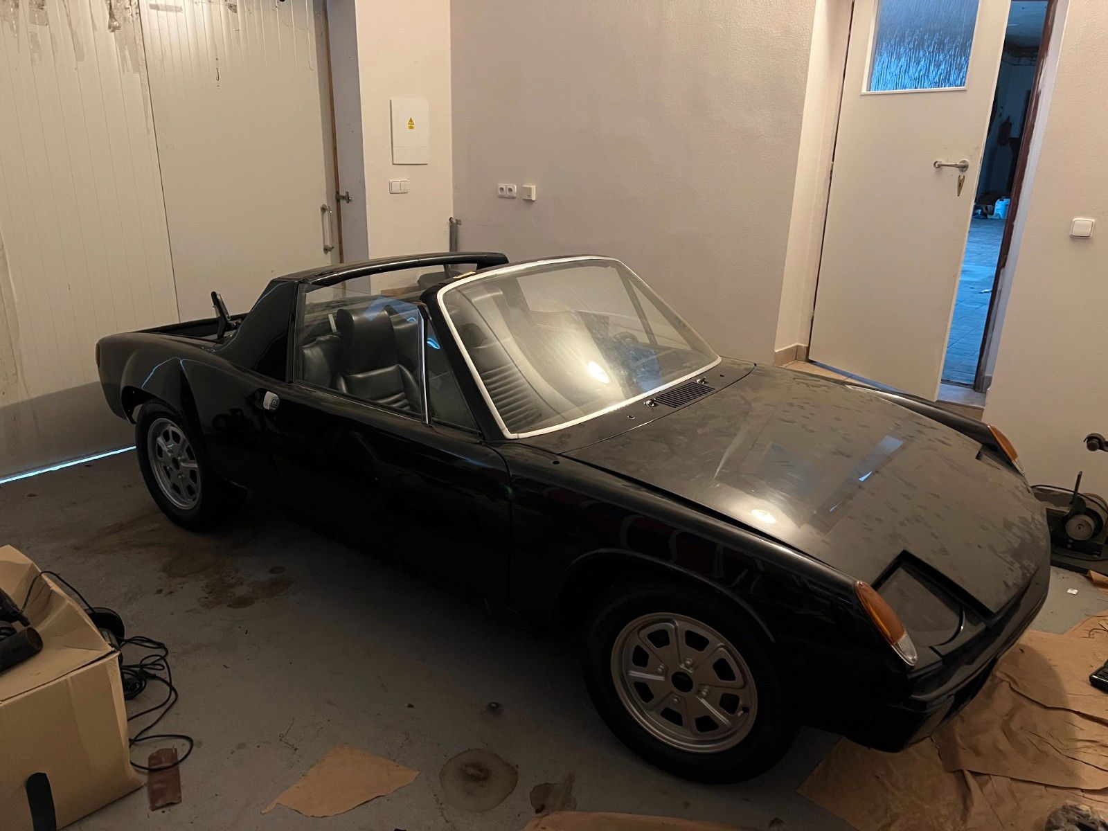

Unfinished project Porsche 914 appeared for sale not far away from my place some half a year ago. So I went there to have a look. Due to the personality of the seller and obvious intention to sell cheaply we agreed on buying price. Project is 75% finished and there are plenty of spare parts (He had a donor car). But some parts are missing too.

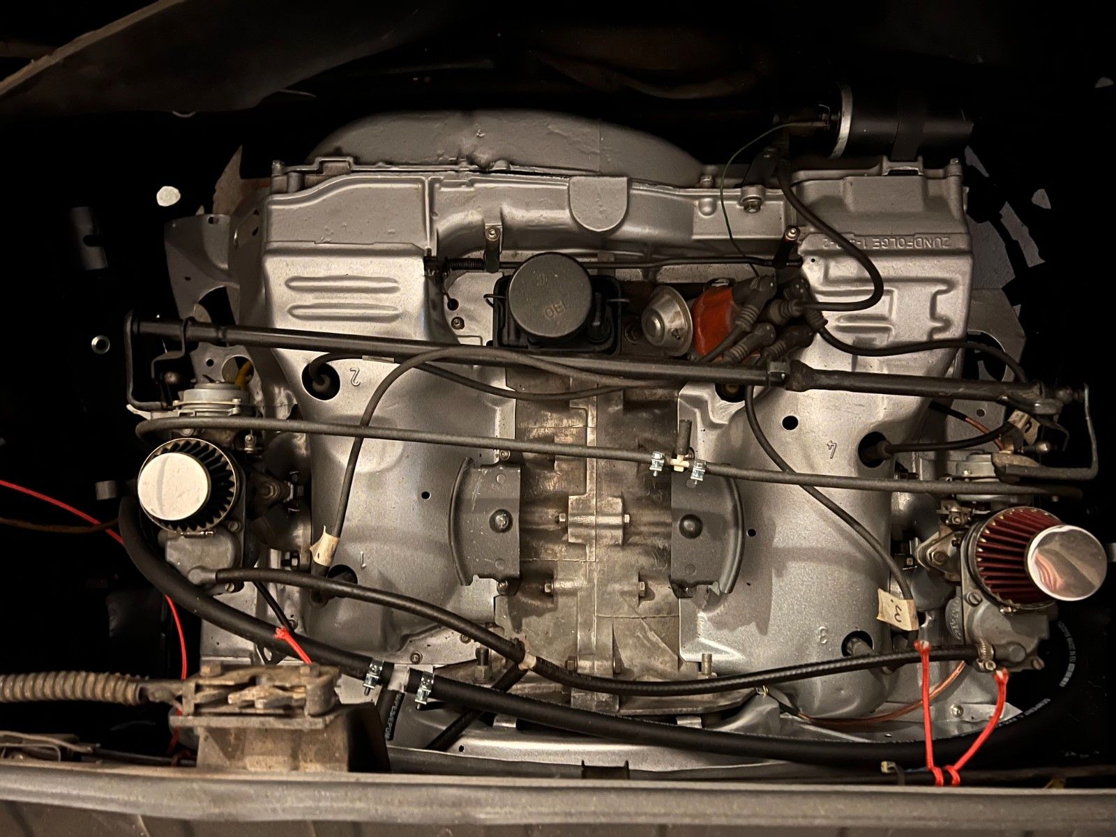

1. There is 2.0 refurbished T2 bus engine in the car. That will be removed and sold as it is. From all the spare parts I have I would like to build 2056cc engine using my 1.7 crankcase and 1.8 heads (will need to source 2.0 crankshaft and rods, the right camshaft, 40 Webbers, 96 cylinders and pistons).

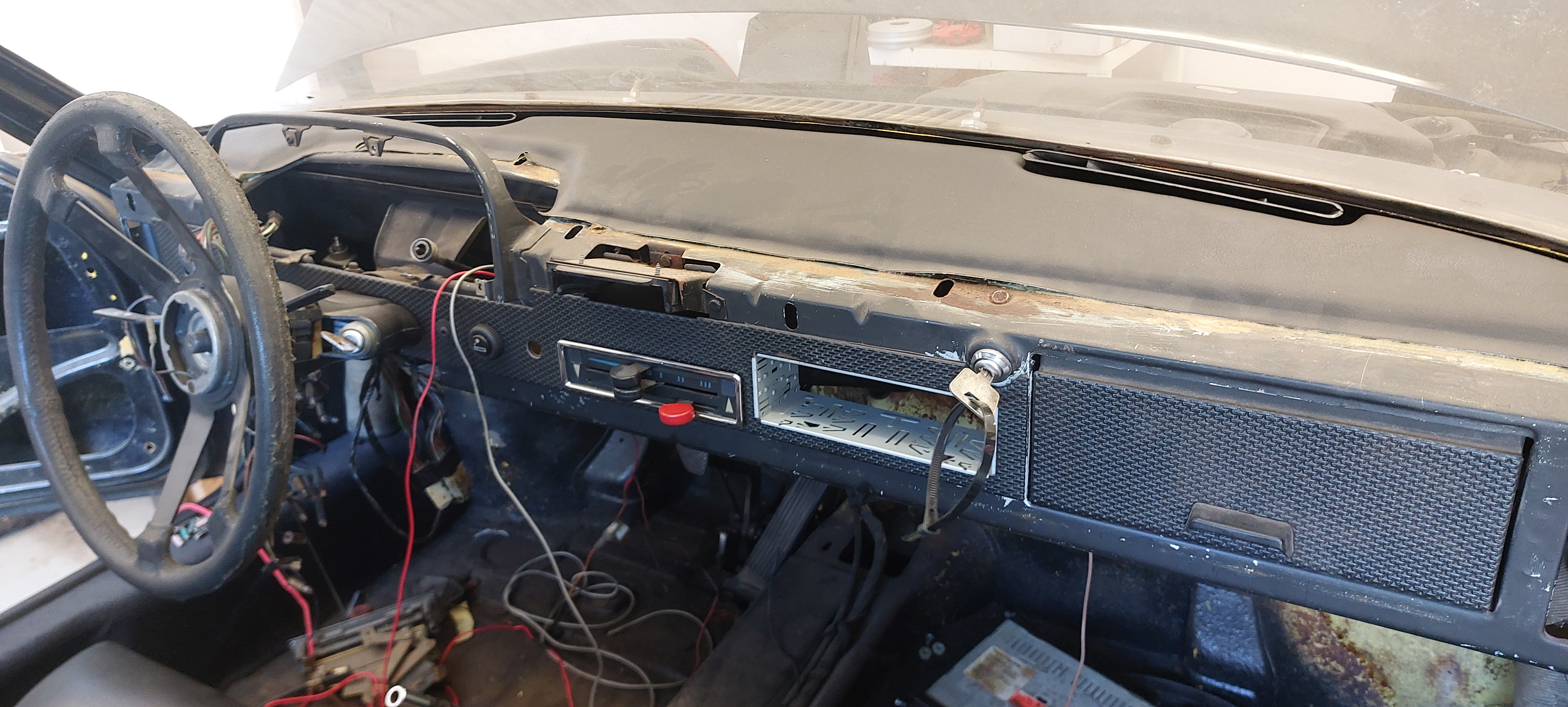

2. Car electrics – One is in the car but seems to be a bit messy. I have a complete spare one but it´s far from being perfect. I would like to remove FI wiring and add central locking, electric windows, DLR, intermittent wipers, electric windscreen washer
3. Car body is sound and recently resprayed. But I don´t like the colour and the rear wheel arches. Therefore it will be converted to GT flares, will be lowered and go on 16” 205/225 wheels. I would like to weld some reinforcement into the tub.
4. Car interior will need to be done from scratch – All the door window and targa roof trim and seals is missing. I want more like Sheel sport seats. Dashboard to be assembled. Foot pedals to be assembled and connected. New carpets installed.
