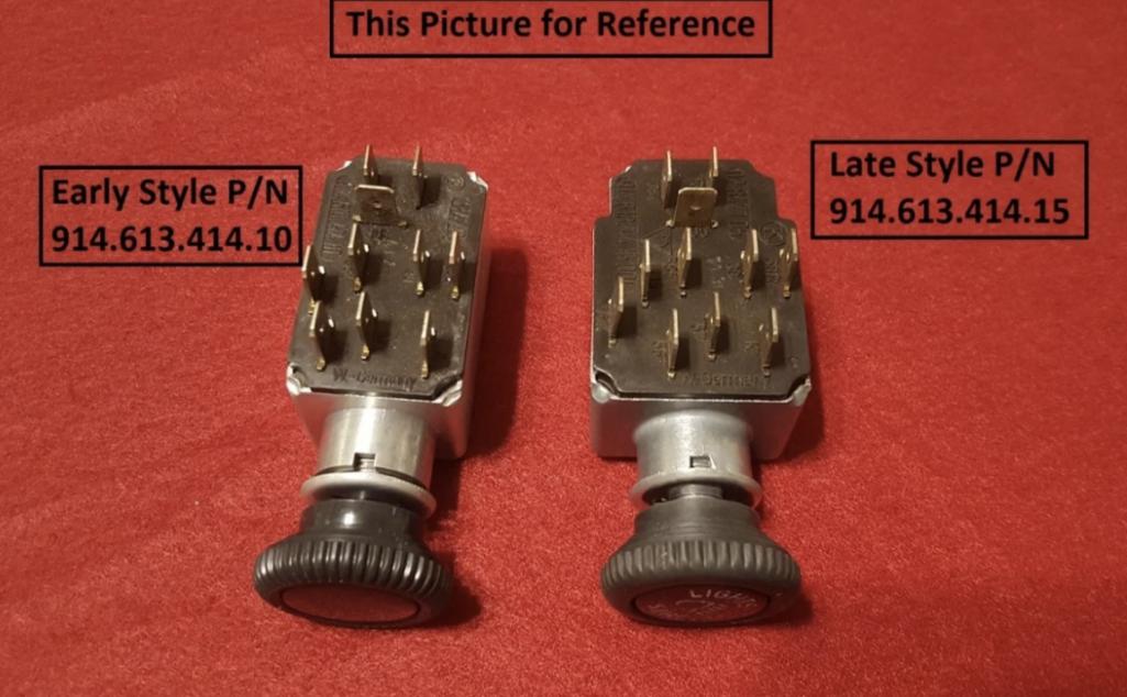

Yep.
There’s an early and a late headlight switch. I think ‘73 was a transition year. So you could have either switch.
Remove your switch and take a pic of the side with the electrical connections and the part number if possible. The number/pattern of electrical posts will indicate if you have early or late.

The two versions can be identified by the number of spades:
Early are 10, Late 11

I believe all 73 cars had the early switch.
Drop the fuse panel and.
Pull the switch out to confirm. Leave all wires attached.
I have some early switches. Im in Riverside.
PM me and I provide my cell so we can talk.
Bruce

QUOTE(DC_neun_vierzehn @ Nov 23 2025, 06:16 PM) *
Yep.
Pic from the web
