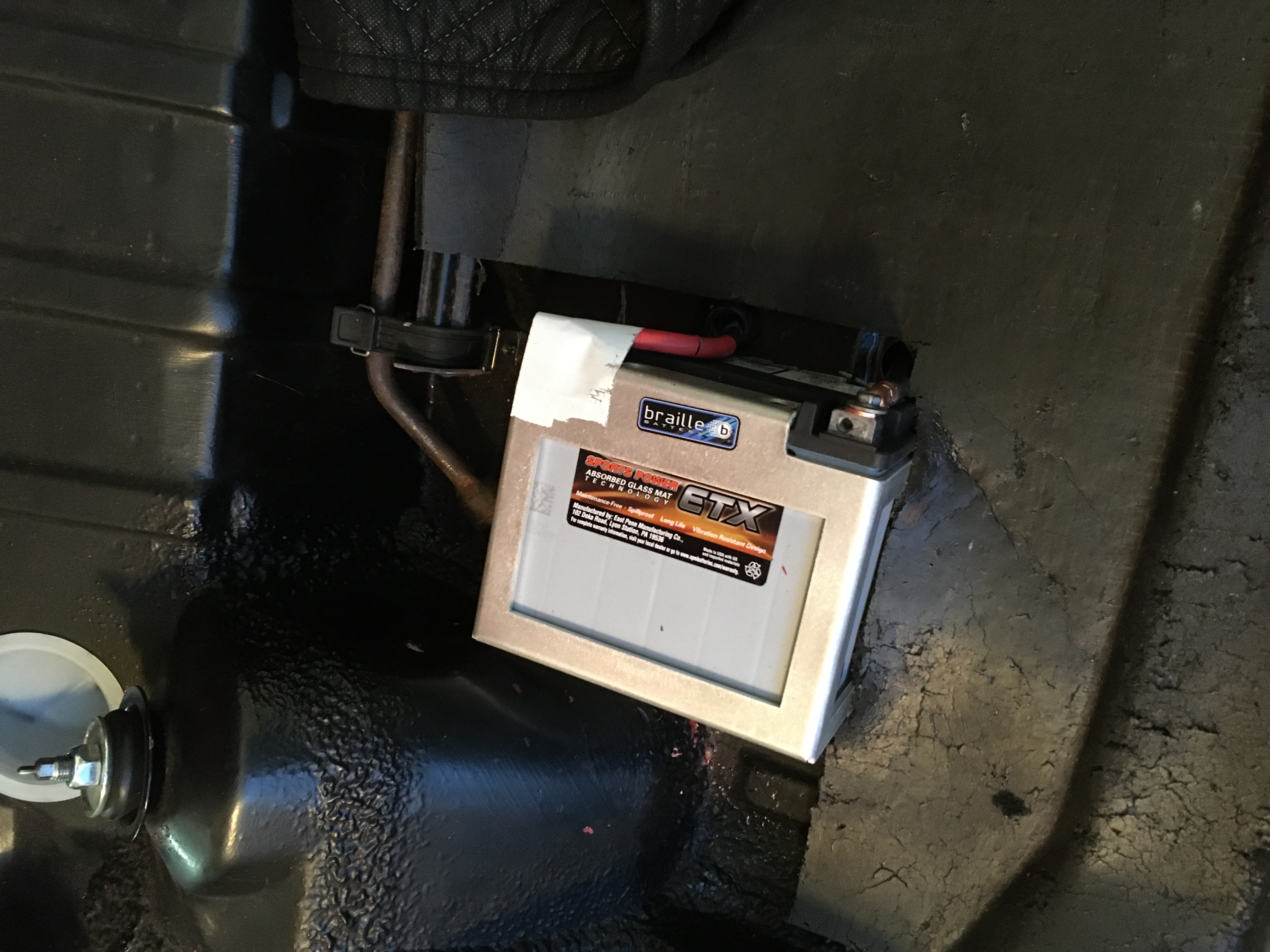

I went with Optima seven years ago. Very happy. But also moved the battery to the trunk. Best, MarkAttached Image
