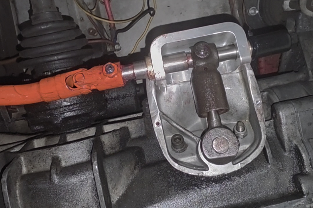

Thought I'd share some recent upgrades and fixes for the shifting issues that plagued my 914.
Symptoms included:
-Grinding when going into reverse or first gear, whether I was stopped or coasting to a stop for first gear.
-So much shifter slop, the sloppiest, loosest, bucket of gravel shifting you can imagine. Was tough to find a gear at all sometimes.
-Shifting performance declined to the point that I was no longer able to find first, or fourth/fifth.
-Clutch pedal was very loose and outside of the bounds of normal.
So what did I do about it?
I decided to take some time to inspect bushings throughout the entire shifter linkage system and no surprise, they were trashed. The firewall bushing was half missing, gear shift bushing was "wallard out", and rear console didn't look so hot either.
So I got some new bushings and decided to go with the Tangerine Racing side shift linkage upgrade kit and firewall bushing kit.
Here is a link to the install video for anyone that is interested in doing this upgrade: https://www.instagram.com/reel/DQx6ISSkcmw/...zRlODBiNWFlZA==

The shifting experience is now much tighter and feels amazing. I know that I will never have the super tight short throw experience that I had with my NA Miata, but for a 50 year old machine, it's great!
I did find that the clutch cable was loose and tightened it up at the tranny. There is a double nut setup on the tranny side where the cable attaches. On the test drive, I felt a pop in the pedal and sure enough, the double nut was loose and the transmission exhibited a little bit of a clunk when going into first.
Perhaps I should try a nyloc nut on the outside to try to prevent it from loosening up at all during driving? Any recommendations? Safe to say that the clutch cable tension may have been a major part of the original grinding issue when shifting into first and reverse.

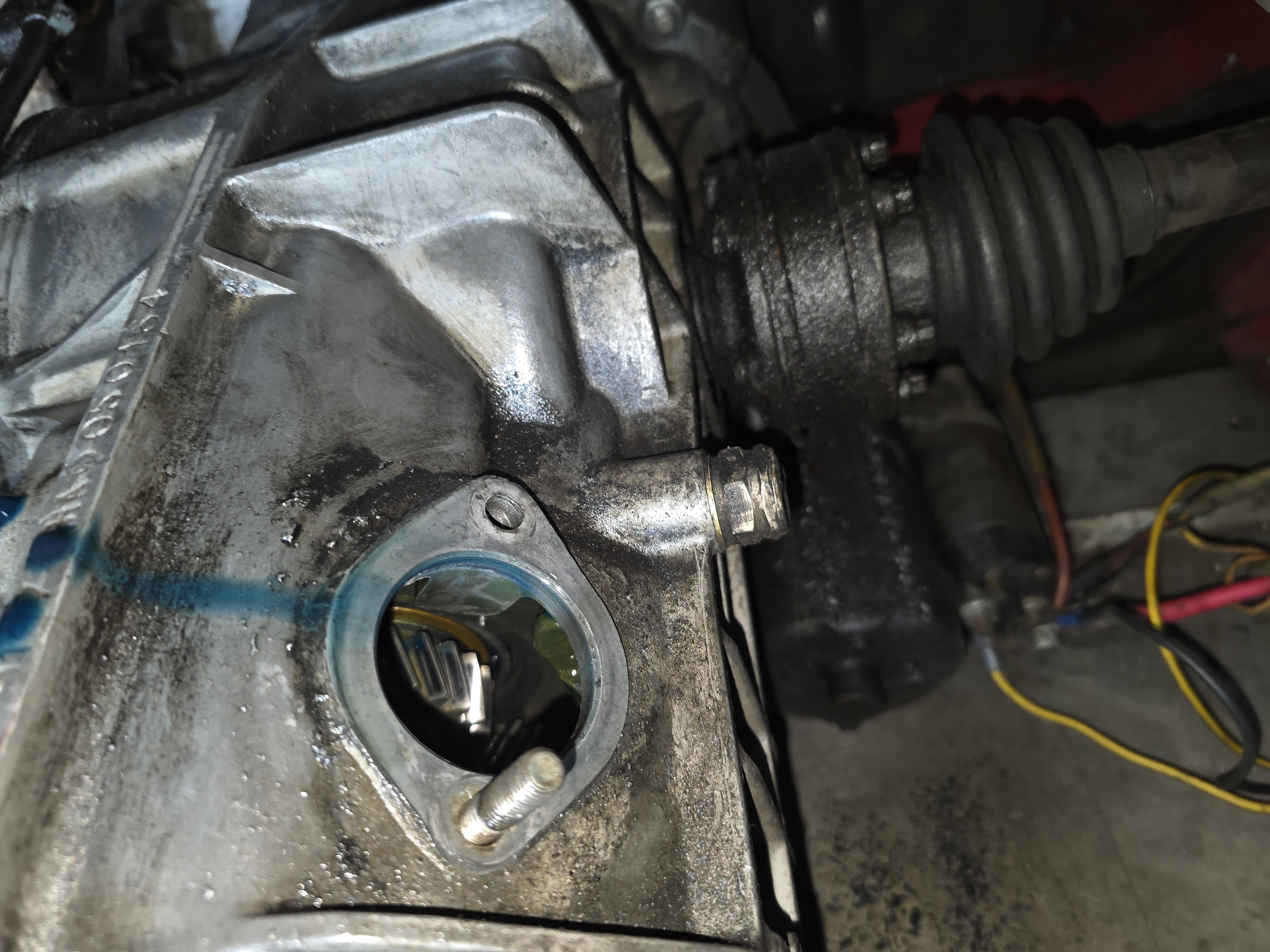

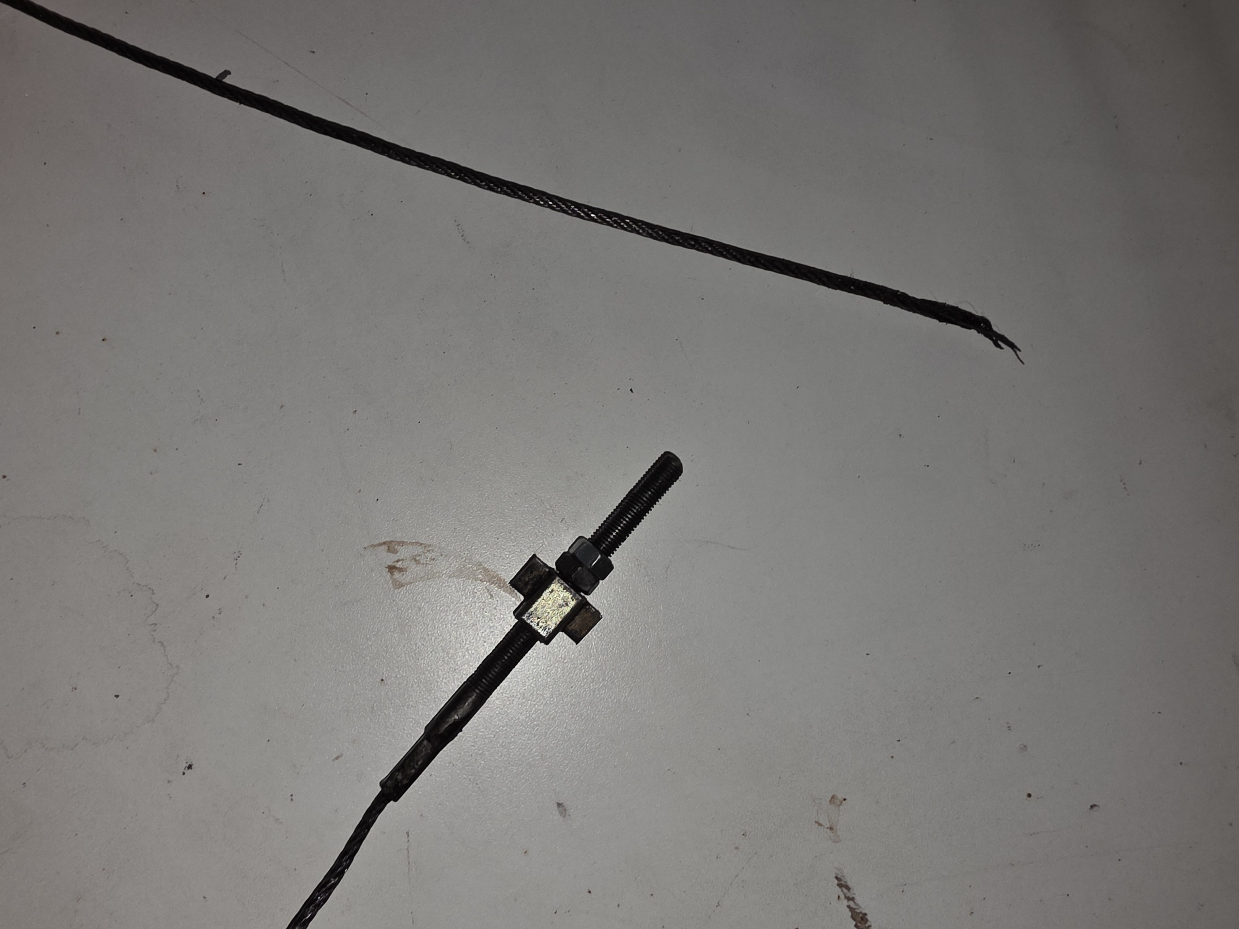

One step forward, 2 steps back.
After driving the car a few more times after adjusting the clutch cable, I noticed it loosening up again. The double nut was not the issue and I believe now the cable was fraying further and further until it finally broke. That's fine, I can put a new cable in.

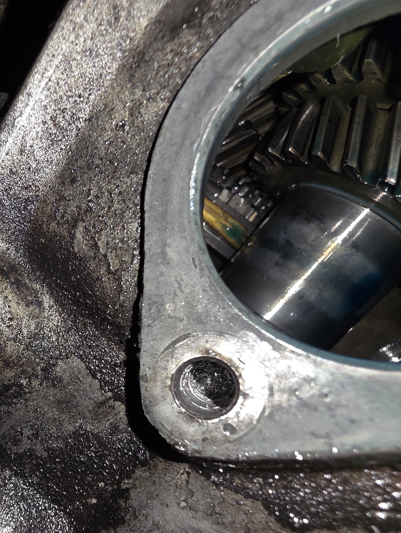

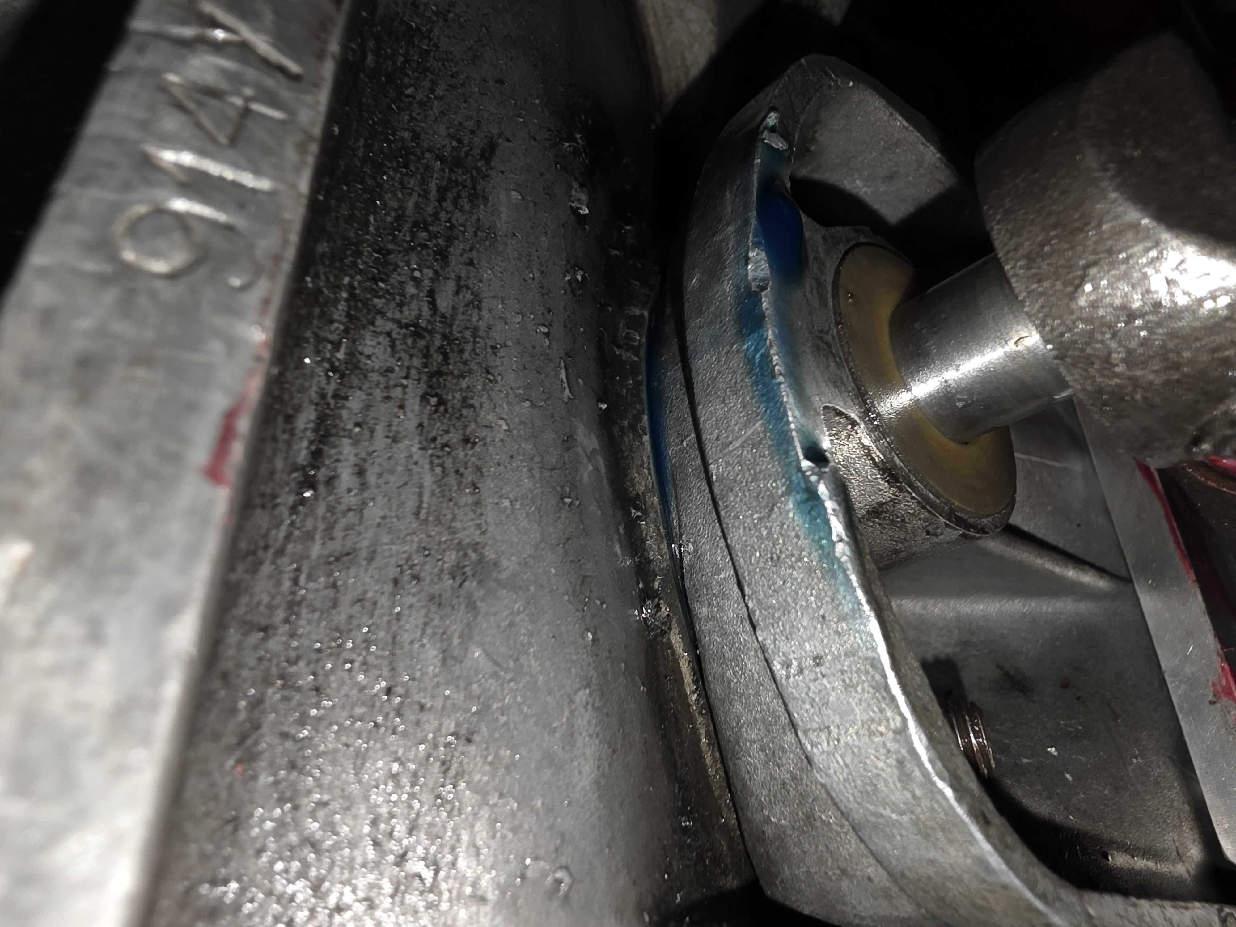

The bigger issue is an unreasonable leak between the shifter console and the transmission. I believe that there should be 2 studs with nuts holding the console on but in my case, there is one stud and one allen bolt. Not sure what happened to the stud previously. The bolt hole threads are stripped and the allen bolt cannot be tightened enough to close the gap between the console and transmission.
Any advice on what to do here? Heli-coil install and maybe a new stud threaded into that?
Broken clutch cable
Console leak

Stripped bolt hole, threads are gone
gator914

One stud and one bolt. Weird

From: Granbury Texas
Member No.: 29,004
I'd helicoil that hole and put a stud in it if you have enough room.
New (O-ring/gasket?) for console.
I purchased an extended clutch clevis puppy for better cable control too.
https://pmbperformance.com/products/billet-...nyhtszMeT7CXKKw
That one is for a 911 but the 914 one was similar.

Member No.: 10,102
Take the blue stuff out and use old school gear oil.
Matt

From: LA
Member No.: 28,238
I think that is the direction I'm headed. And I will try to find a stud that matches the original to thread into it. There is no gasket between console and transmission that I am aware of, but I could make one.

QUOTE(gator914 @ Jan 6 2026, 06:02 PM) *
Do you have any pictures of the rennline clutch cable clevis installed? Looks pretty cool.
QUOTE(Ninja @ Jan 5 2026, 07:44 PM) *
There is an 'o' ring that is used to seal the shift console ,was there when I had mine out to modify and replace oil seal ,it is shown in the Haynes manual but I have no idea of the size.
Helicol is the only fix as mentioned ,cheers.

post Jan 6 2026, 05:28 PM
Posts: 3,220
QUOTE(gator914 @ Jan 5 2026, 04:10 PM) *
These work really well especially with softer metals. I've never had one fail. Add a stud and you are done. Not cheap, but worth the peace of mind.
