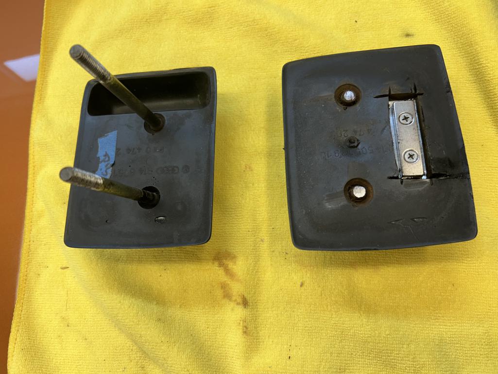

I made a pair that would work. First, I cut off the studs. Then I cut two recessed in each
Rare earth magnets were epoxied in each recess.
Now, just hold the rubber bumper guard where you want it. They are on very tight.

Finally:

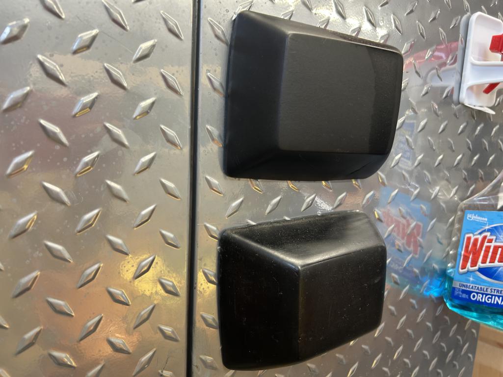

post Dec 1 2025, 08:03 PM
Posts: 9,954
And attached to my tool cabinate; it takes a good pull to remove
I bought the Magnet from Apex Magnets; they have a huge selection

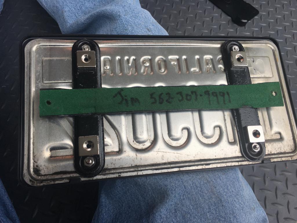

post Dec 1 2025, 08:10 PM
Posts: 9,954
I made my license plate magnetic too; that way I can clean behind it.
