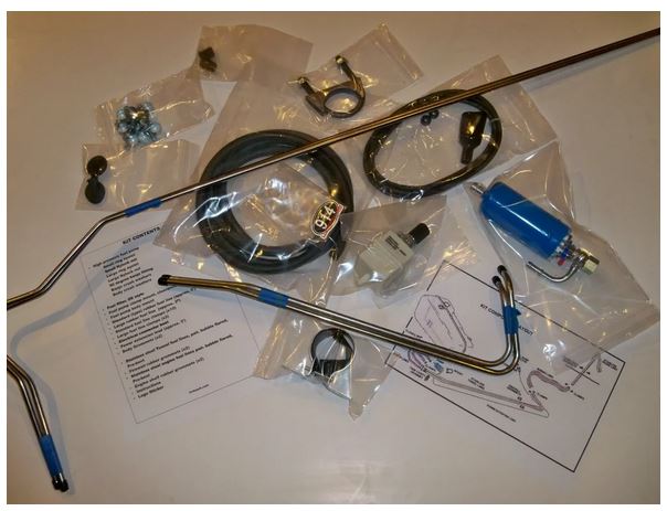

Here is an option. (IMG:style_emoticons/default/aktion035.gif) KIT

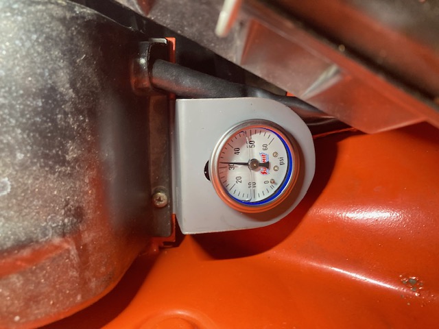

I am far from an expert, but I also have a 74 and have had my share of fuel delivery problems. I did replace my OEM fuel lines with stainless, 4 pcs from Pelican. My three port pump was rebuilt when I bought the car and works great! One hot day my car wouldn't start, I thought the notorious 914 vapor lock but turned out to be a kinked fuel line underneath the tank.
I've never had a vapor lock problem with the stock pump in the factory location and I live in the Sunny South.
Your results may vary.
I have installed a fuel pressure gauge visible from outside the car "just in case".Attached Image

I picked up the 4 piece kit from Chris, comes with everything you need. Get the one for 75 and up because its design for cars with the pump up front. Mak3 the rubber lines long enough so that you can loop them so they dont kink. It is a straight forward install.
