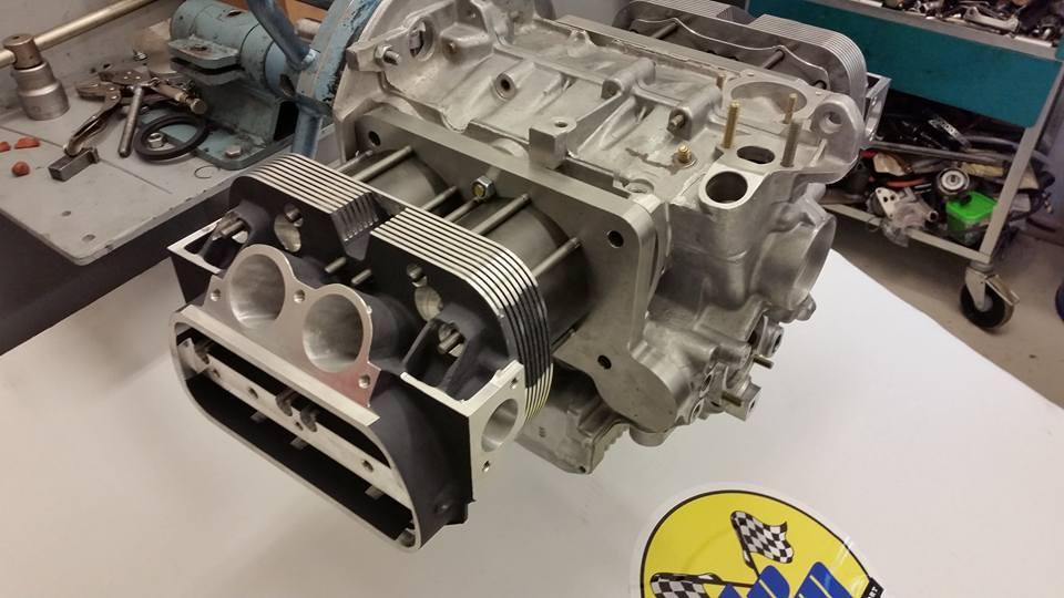

I know the corvair power plant is old and antiquated, and many newer engines could be used with more power etc etc. but I'm wanting to stay air-cooled for dumb sentimental reasons and a Porsche -6 is out of budget by leagues and other vast units of measureme. I have a crazy hare-brained idea to do custom side plates (similar to https://www.thesamba.com/vw/gallery/pix/2153784.jpg and use maybe 102MM Deutz cylinders, with something like Yamaha XT600 four valve OHC air-cooled head.
Crazy I know. It is obviously much faster and easier to just put a Subaru in it, or build a big T4 or a Porsche 6. BUT I enjoy fabricating and machining things, have a lathe and mill and access to casting equipment and Fusion360 for CAD work.
Off the top of my head the biggest hurdle would be getting custom cams or somehow combining 6x single cylinder cams.
