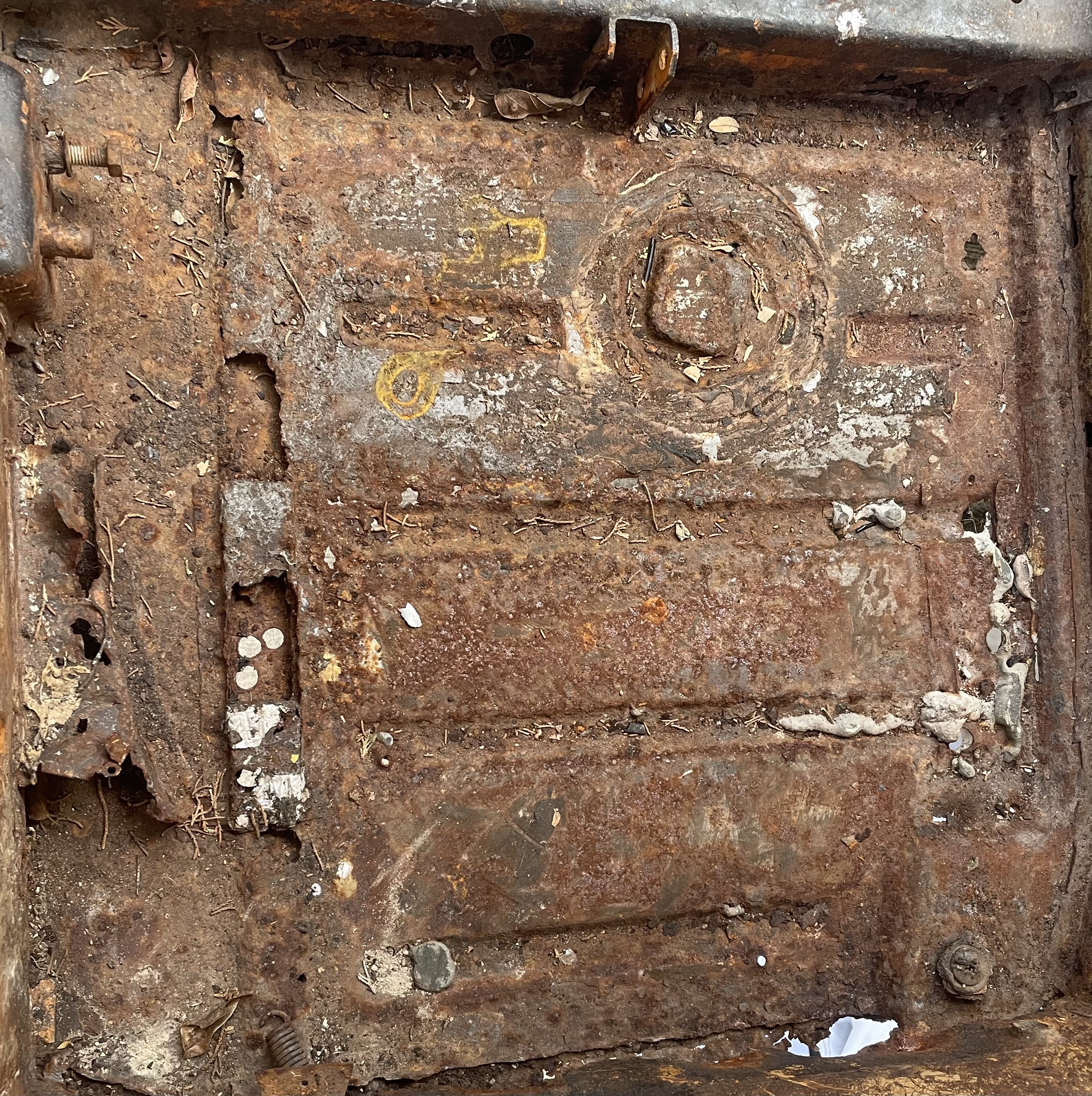

The floors were Swiss cheese (see the before pics) worse than I’ve seen on a car that I’d consider a good rebuild candidate tbh. PO used bondo to fill the holes, I kid you not. The back part of the rear trunk was terrible - had been patched with fiberglass cloth that water had gotten under. Then everything covered in a bedliner product that was only sticking in about 80% of it’s coverage, including wheel wells.

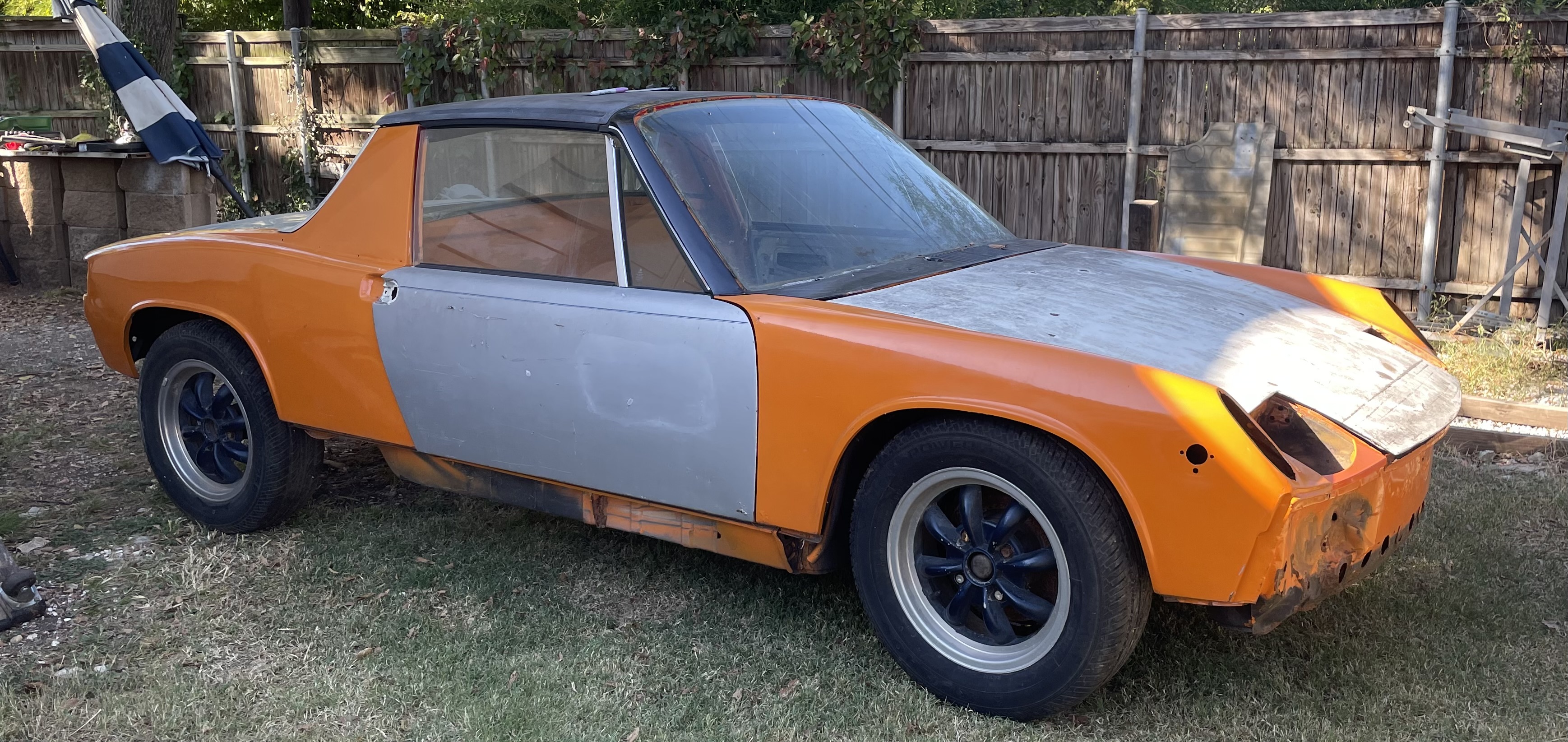

Over the last few years I’ve sourced most of the missing parts (that cheap parts car is paying for itself in this one). I picked up a set of unused floors from a member here a couple years ago too.. as well as ordered other needed sheetmetal items for it. So I’m now ready to start restoration on this one. I like having a thread showing the process and the before/after but admit I’m not always the best at getting it all documented. Here’s the car as it sat a couple weeks ago (with random doors, roof, etc).

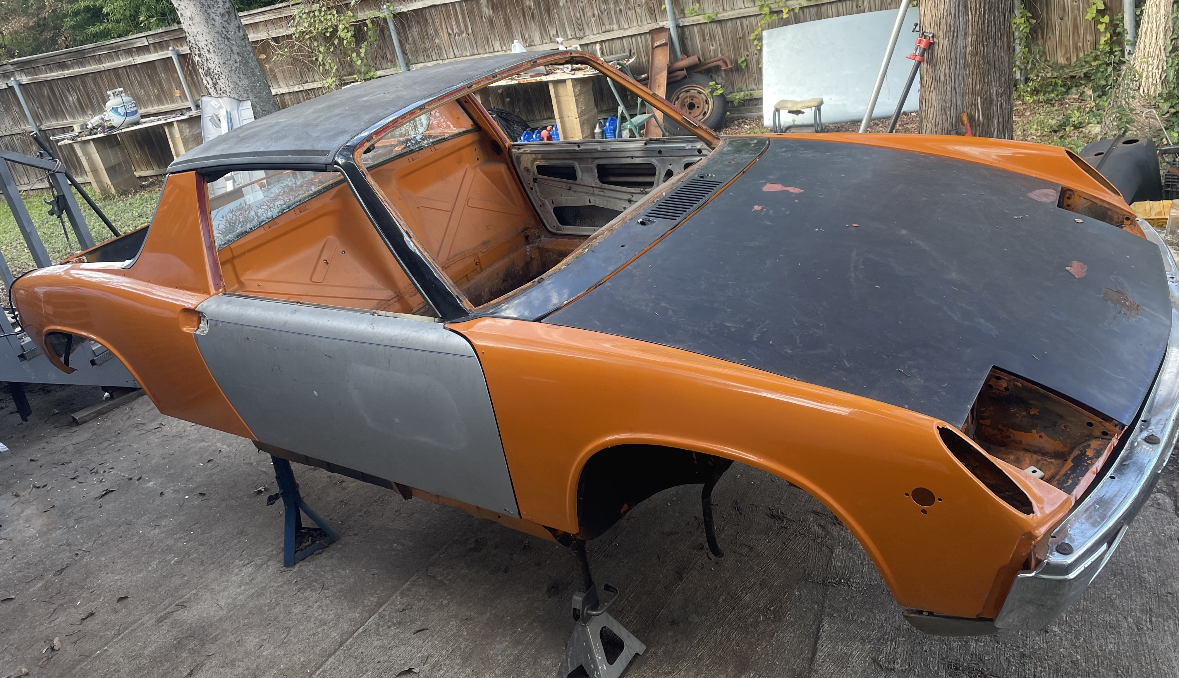

Got it on jack stands.. removed the suspension, axles, etc and ditched the white hood, it was bent.

Trunk floor - YIKES !

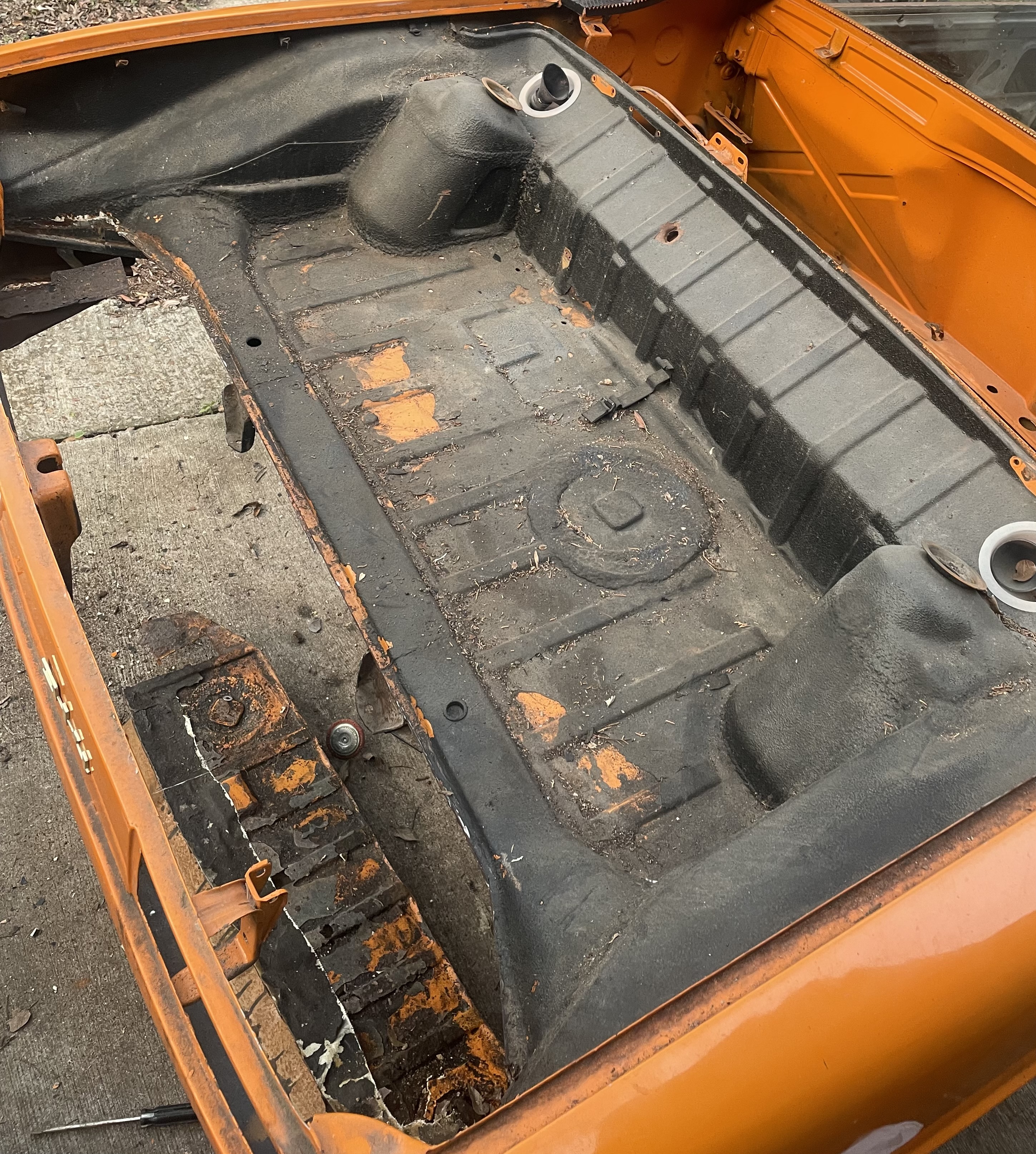

That trunk has been bugging me the most and so I got started on it first:

Just cutting this panel out alone, makes the car seem sooo much better!!

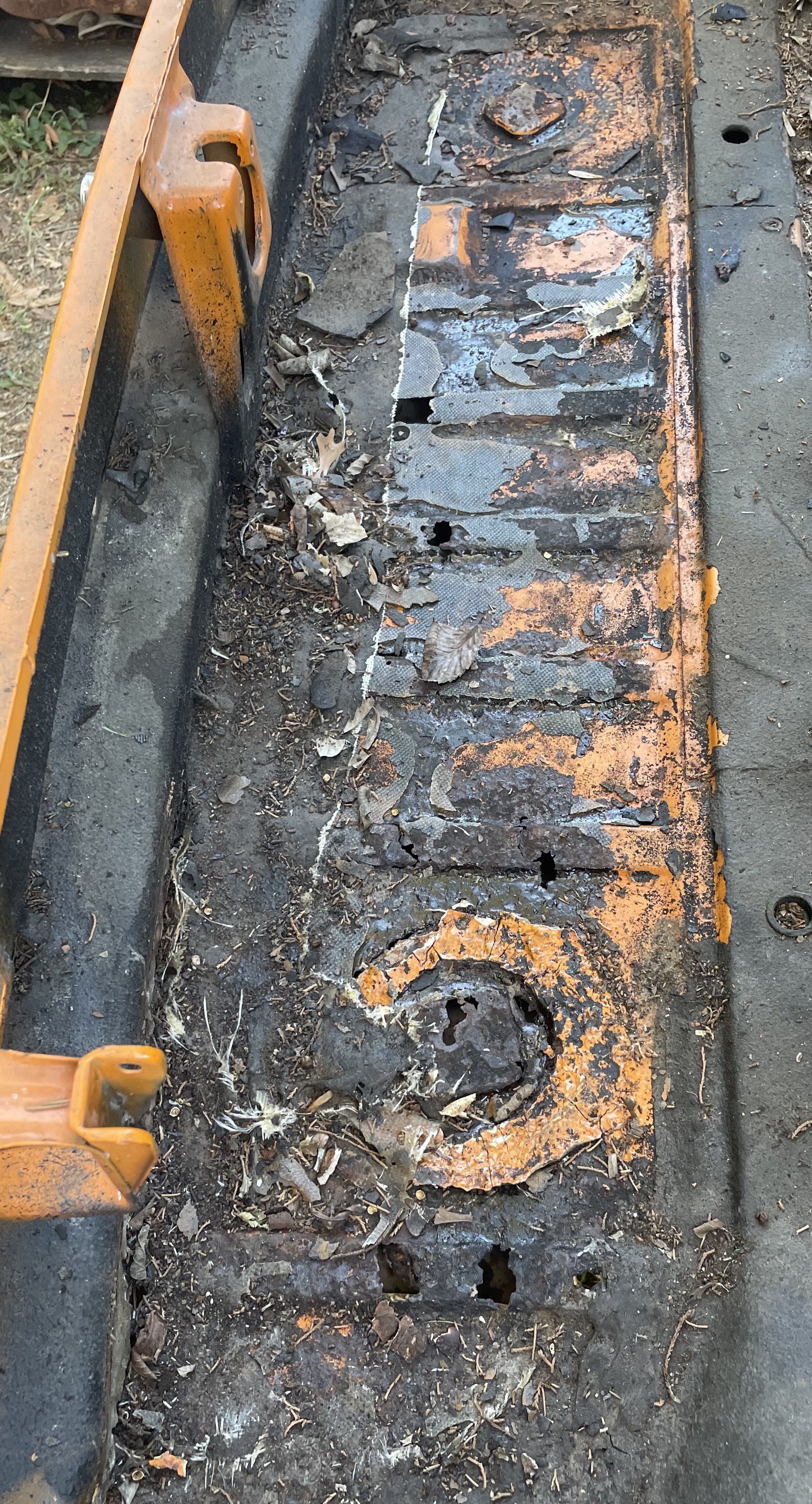

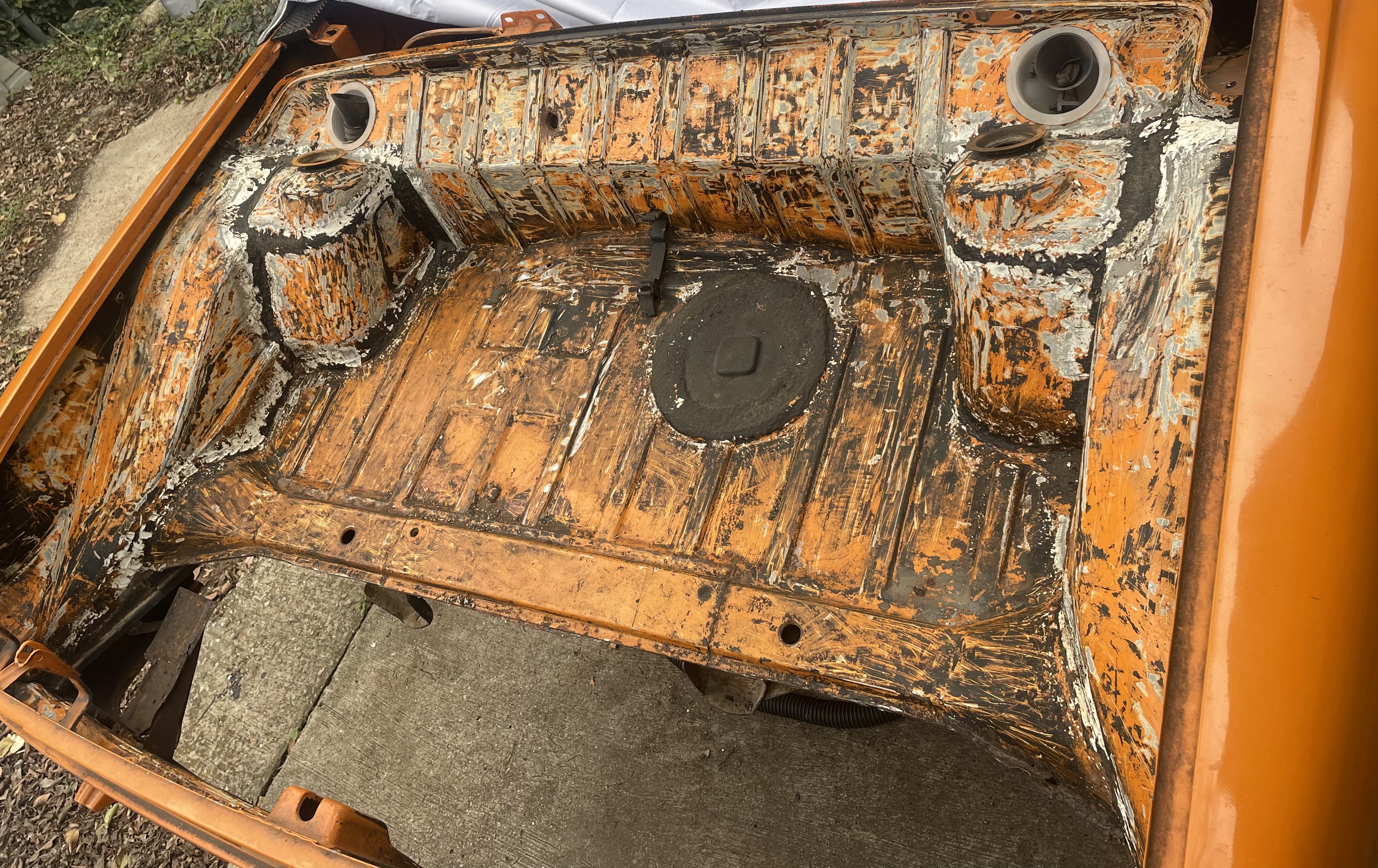

Next, I got busy removing the bedliner stuff (heat gun and scraper) - gotta get it ugly before it gets pretty :

The fiberglass cloth used on the back edge of the trunk floor apparently trapped water enough to create some rust thru areas. This will be repaired before the new trunk floor goes in:

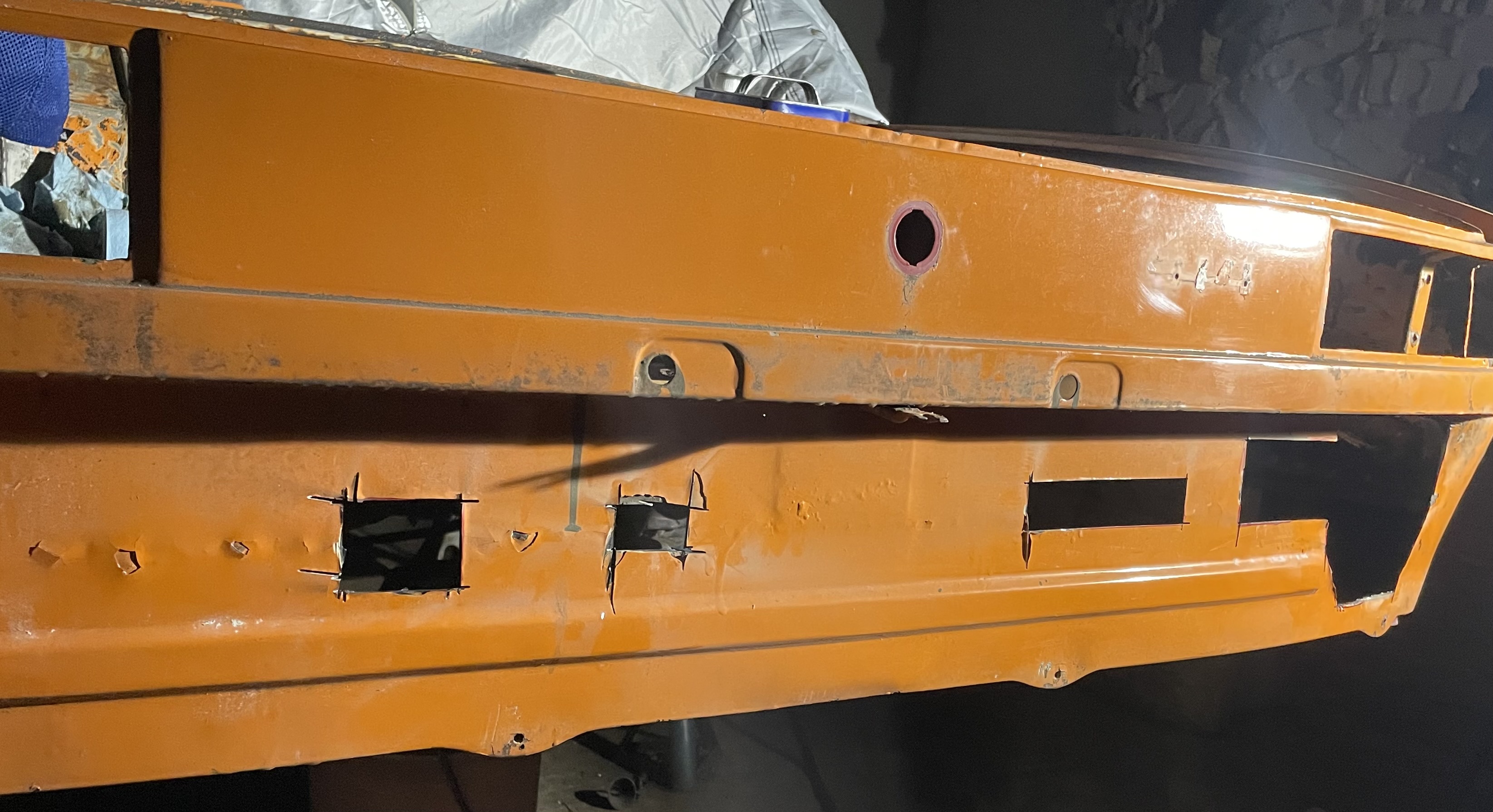

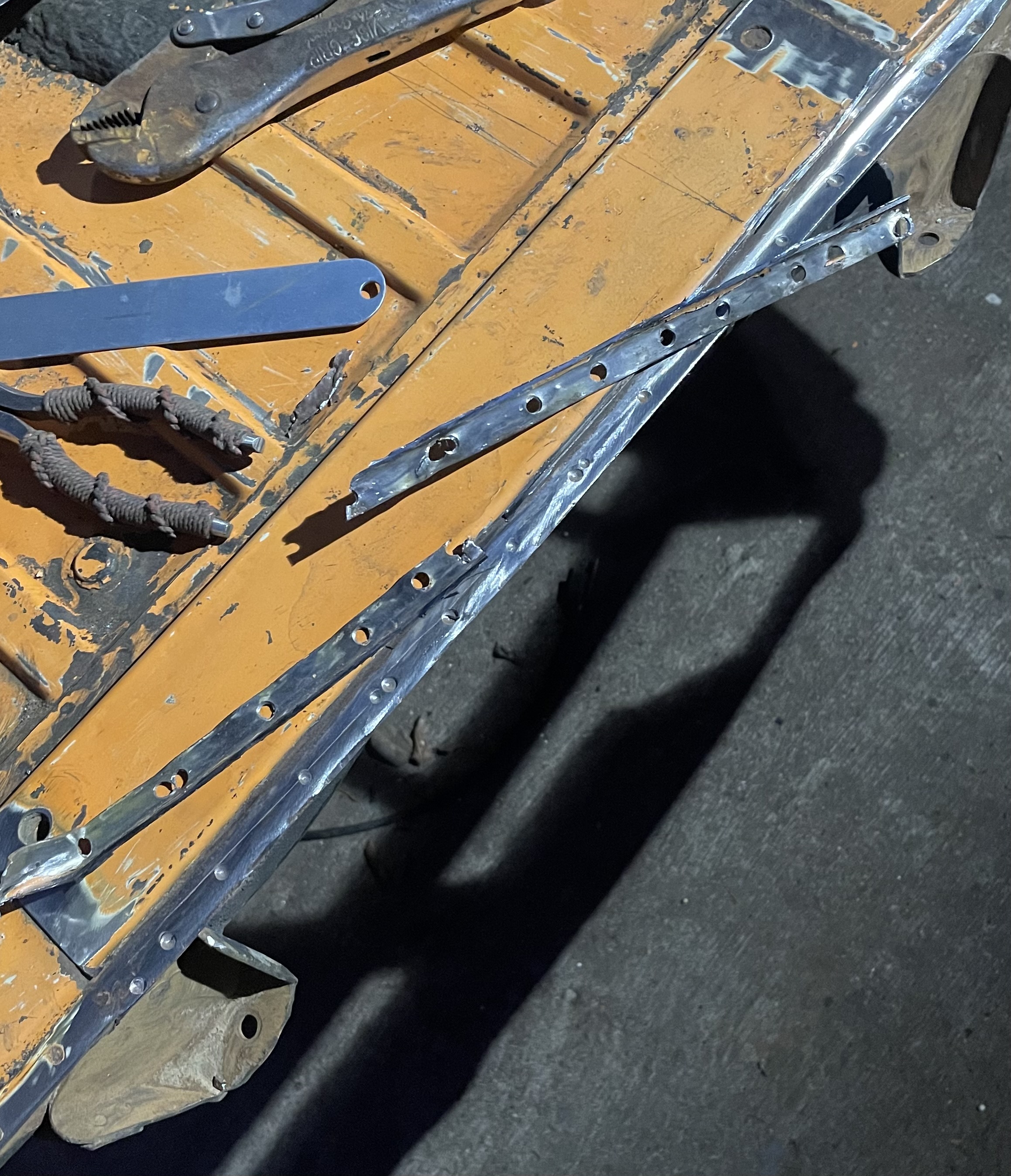

I cut this section off my parts car (late model) to replace the same area .. the contours are the same but I’ll have to eventually drill holes for the early bumper bolts to pass through:

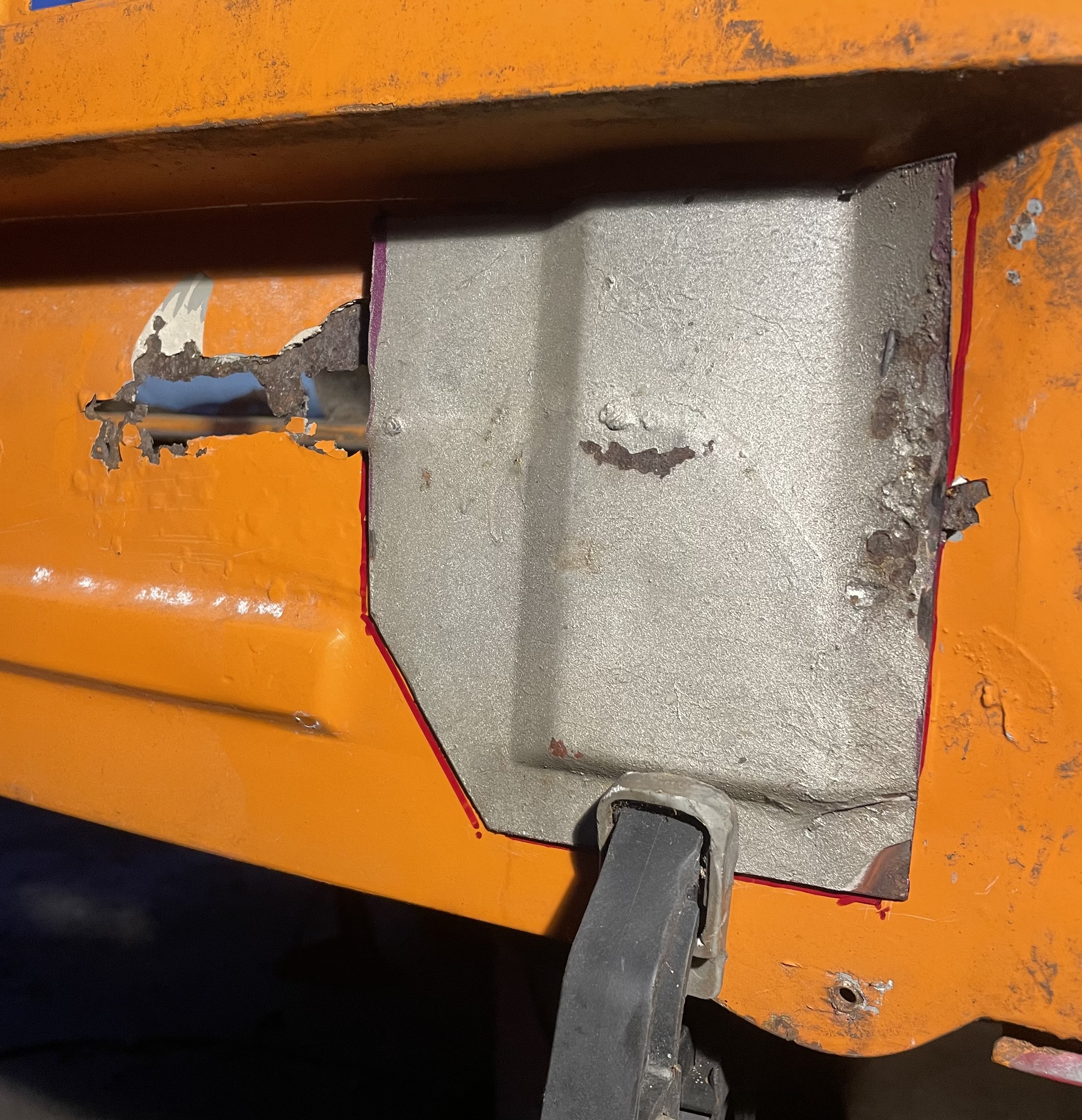

Here’s a shot showing the compromised metal areas cut away from the rear panel:

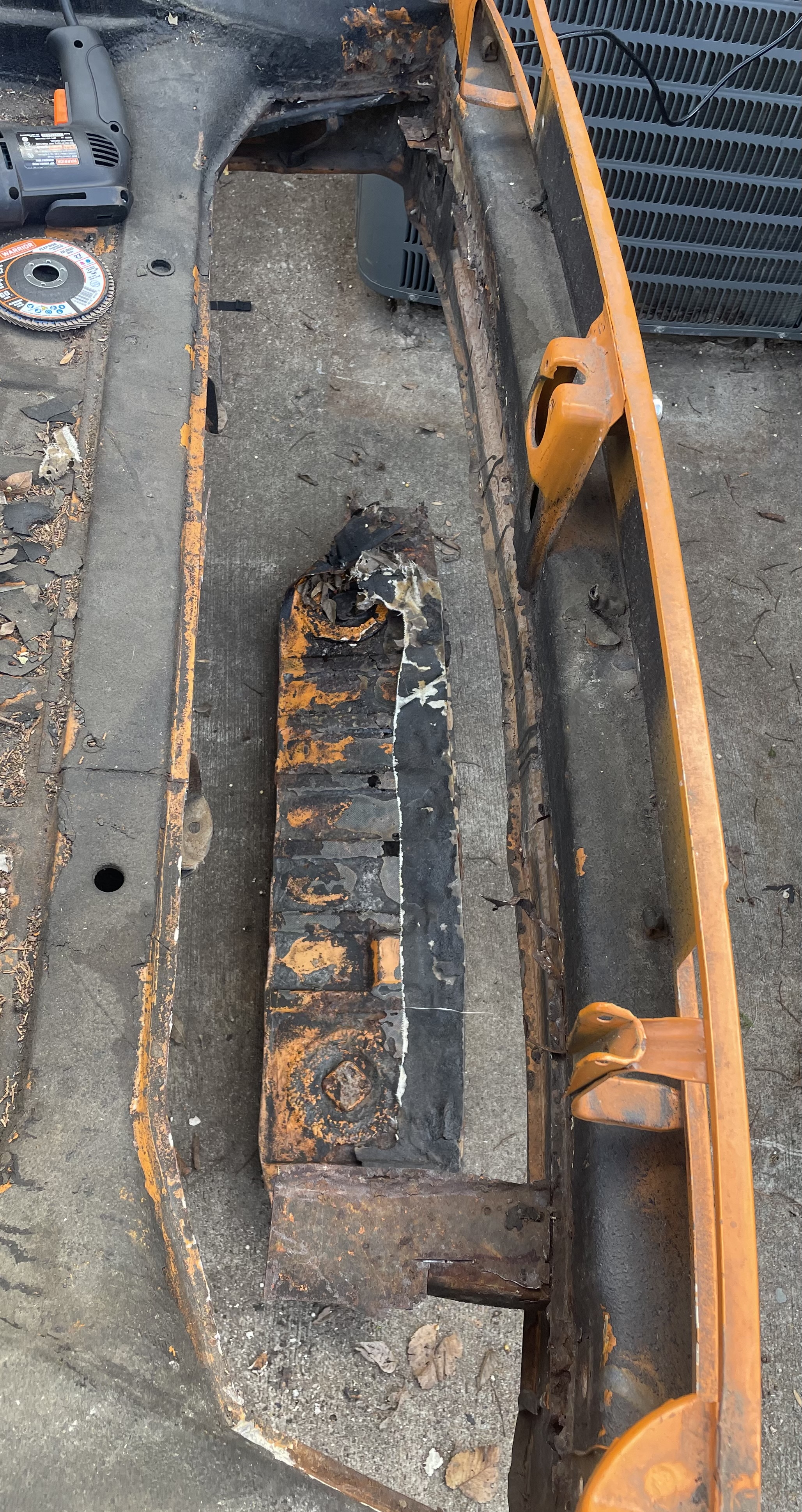

I cut away the edge of the piece that sits atop the crossmember, so that I will be able to weld the edge of the rear trunk piece there without the bulk. BTW that top section is still spot welded along it’s top edge:

Member No.: 7,222
Since the cross member section of this car is in good condition, I decided to cut down the RD trunk panel so that it would perfectly sit on the edge of the crossmember before welding in:
