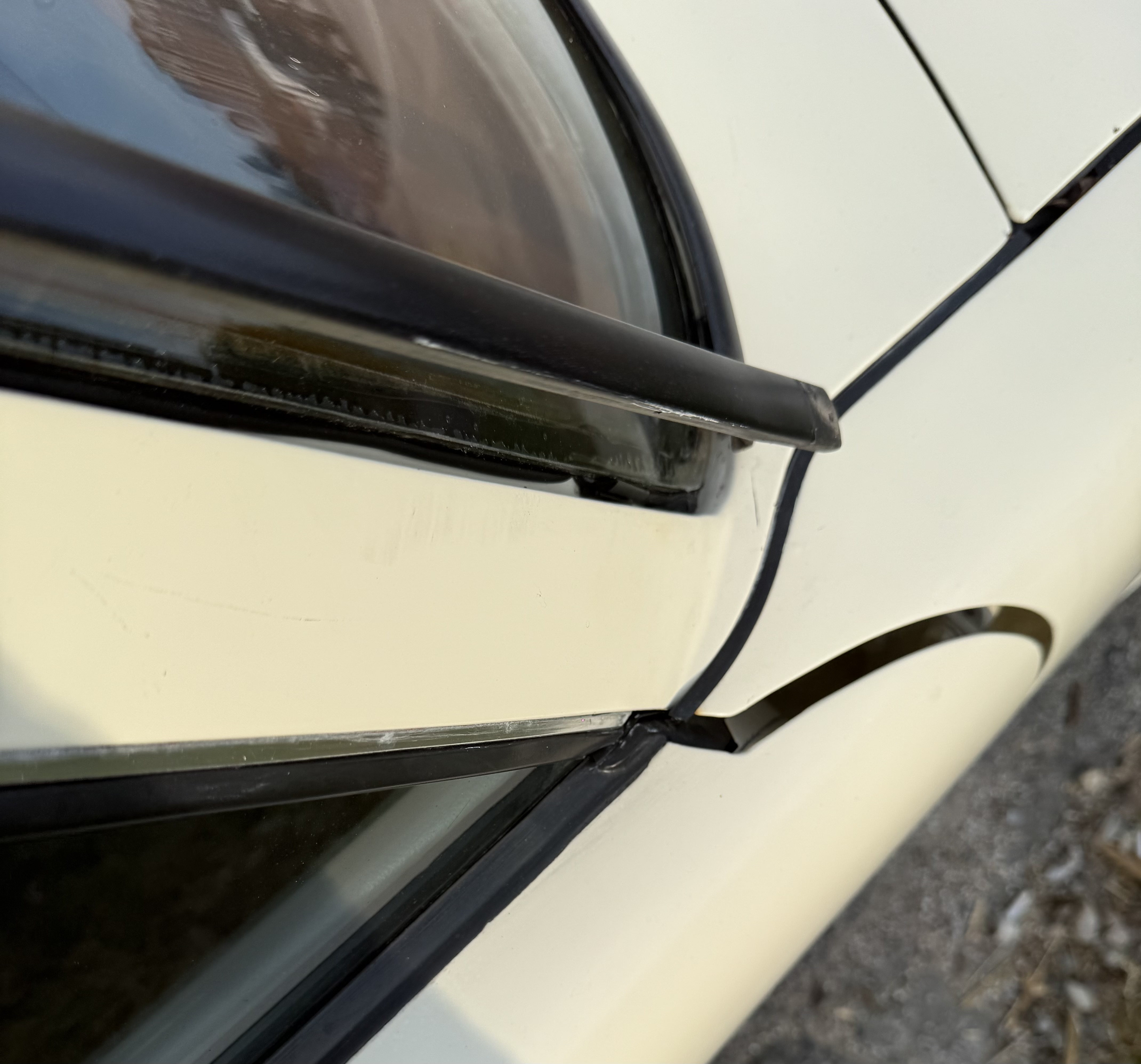

This Happened (for several miles on the N. TX toll road):
Literati914

Causing this to happen (I’d just pulled the windshield because of the stupid trim clips at the center top (IMG:style_emoticons/default/headbang.gif) )

This is the 2nd post I have seen regarding window trim popping off at speed. What is causing this? I have had my car at 130 for a good bit and no issues so far. (IMG:style_emoticons/default/confused24.gif)

If this turns out to be the trim clips, I'd be laying down the $$$s for the Porsche OEM clips.

I also would guess that the trim clips were not replaced (no windshield shop would stock these). Or it wasn’t clipped all the way if it was replaced
Believe the factory calls these clips one time use
Most windshield shops use glue instead of and just are not familiar with using clips

When I originally installed the windshield - apparently two clips at the top center broke for whatever reason (IMG:style_emoticons/default/confused24.gif) (aftermarket from a supplier we all use ).. I pulled the windshield about a month ago to replace the broken clips. I ended up replacing them all because I had an extra set of the aftermarket ones as I'd bought two sets for two cars before I knew these suck (most felt fine to use again tho, TBH), but yea will buy the Porsche ones from now on.
I know they need to be pushed in firmly, these were.. but you can see in my picture that, that particular clip has backed out a bit towards the glass. IF THE LITTLE CHEAP PEG HAS NOT BROKEN, I can probably push it back in and 'brace' it in place w/ more butyl. Fingers crossed that it works - cause slipping one in is out of the question, the whole glass has to come out.

Replaced my windshield about 3 years ago and replaced 2-3 broken clips with aftermarket clips. Haven't had trim pop off yet and agree, it's a bit tricky to get the trim to clip into the clips.

Don't use aftermarket clips. I know of several failures of clips from a well known aftermarket supplier. Including breakage when the trim was installed. Use Porsche only.
Expensive clips but so is the trim.
Also had this happen to a friend at 120mph. It was before the crap clips were made.

I had my trim come off as well. I pulled the windshield and replaced all the clips. Be cautious of companies in Atlanta.
(IMG:style_emoticons/default/agree.gif) ,one thing to factor in is was the trim straight and true to the clips when refitted ,mine had a new Pilkington screen but the trim wasn't fitted ,spent an age reshaping the trim to fit right ,screen fitter had been less than delicate with it !!!.
End of the day it snapped in real nice ,has passed the 100mph plus many times but really not in great condition (trim condition wise ) but not a big deal ,cheers.
